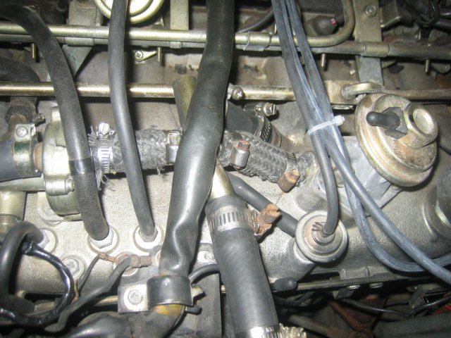

madkaw Posted February 25, 2010 Share Posted February 25, 2010 What I would suggest would be to disconnect the octopus(see pic) on top of the intake and cap all vacuum lines and see how she runs. Between the AAC and the vacuum port valve behind it you have some large internal vacuum leak possibilities. This would eliminate the whole VCM system and you could truoble shoot from there. Don't forget the EGR too. I don't run any of these items, but I don't have inspections to worry about. The biggest issue that I have is a slight surge at idle and that's seldom. I'm positive all of the injector o-rings are there. I will try the lighter thing. But no boost isn't the only problem. It also doesn't idle, and it misses a lot on decel (clutch engaged). Seems like there are multiple problems here, and I think some of it may lie in the controls attached to the intake manifold ie. air regulator and aac. Quote Link to comment Share on other sites More sharing options...
