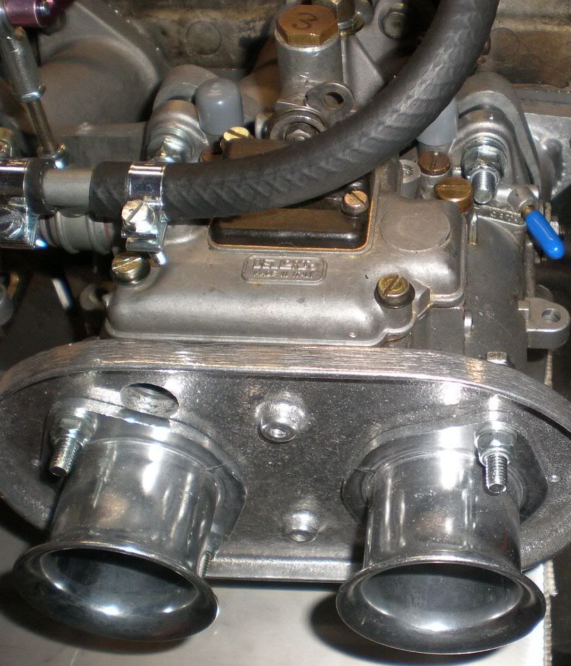

I have a question is the carb body with the vacuum advance suppose to have more vacuum than the other carbs? I have the emission type carbs with the idle bypass and no matter what I do I cannot get one part of the throttle body to sync with the others (the one with vacuum advance nipple) it always has higher vacuum reading. Also what causes the carbs to backfire? car seems to still be running ruff or missing. I tried spraying carb cleaner where there could be vacuum leaks but got no results...
Post a picture of the carbs...I am curious as to which Dellortos you have...do you have the Speedpro Book "How to Build & Power Tune Weber & Dellorto DCOE & DHLA Carburettors". if not I would suggest you get it. Are you trying to pull vacuum off of some port for your dizzy? I would recomend against it...just plug all the vacuum ports...but do get the tuning book, very usefull.....but remember...fuel quality has changed dramatically since these books were written

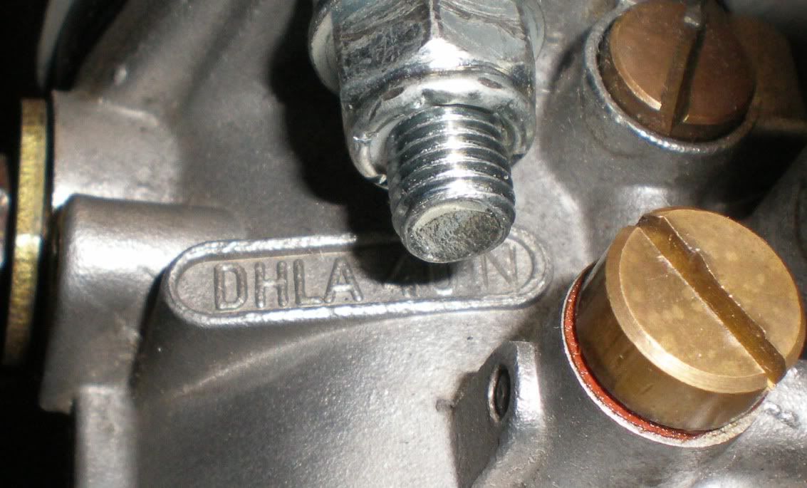

Yea I just got the speed pro book.. I have the DHLA N carbs, I do have the the vacuum advance plugged, didn't plan on using it. Here are some pics, the side with the blue cap is the one that is flowing more than all the others.
Edited by NismoZ
Make sure all your vacuum port plugs are TIGHT...the 6 grey ones and the blue one...use zip ties if you have to
What grey vacuum port plugs are you speaking of? the ones for color tune right next to the progression hole plugs? I have tried to get these flowing evenly but every single one flows more or less than the other even on the same carb. Its like the butterfly's are not equal on the same carb is this normal? These are second hand so Im not sure if it me or a problem with the carbs. They are all opening at the same time more or less, I have got the linkages all the same length so im kinds stumped.
