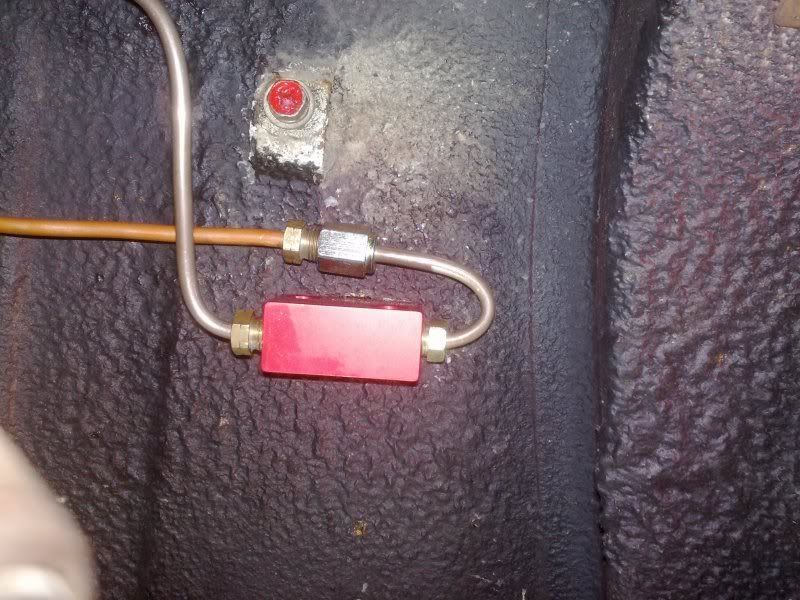

crazyoctopus Posted June 3, 2010 Share Posted June 3, 2010 where I installed mine, not as fancy as the others but significantly cheaper and easier. the holes, 3/8" bit test fit routing and overhead location how the lines are connected -I had two spare 10mm x 1 SS lines so i didnt have to buy any connectors or converters. Its protected cubby No extreme cutting, no need to buy a bracket just 2 bolts, 2 nuts, 2 lock washers and 4 rubber washers; cost $8, cost with the valve $46. Quote Link to comment Share on other sites More sharing options...

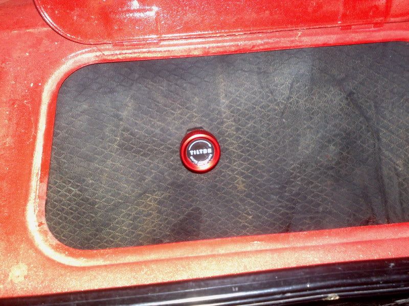

zbloke Posted June 3, 2010 Share Posted June 3, 2010 I removed the stock valve and put mine in its place, access to the adjuster knob via the tool box at rear of drivers seat Quote Link to comment Share on other sites More sharing options...
