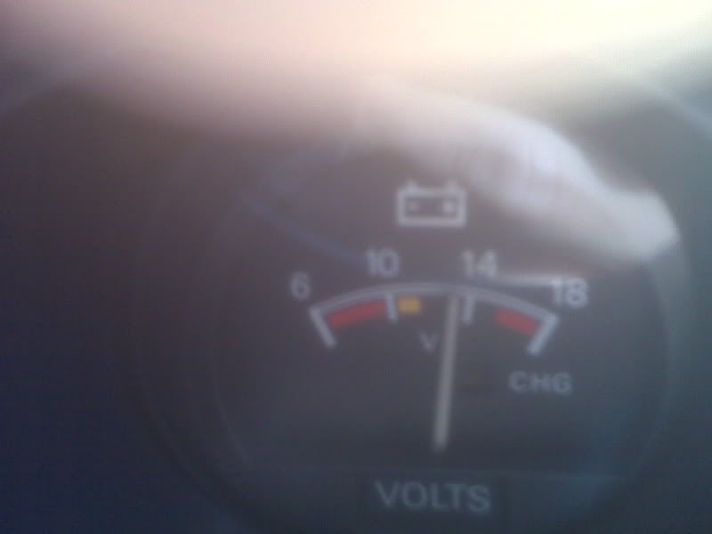

PhilbertZ Posted April 22, 2010 Share Posted April 22, 2010 Guys, Very strange problem I haven't come across before. I went to start my ZX yesterday after sitting for a week and turn the key and NOTHING - no voltage at all - everything is dead. I checked and no lights were left on or doors left ajar...just dead. the battery was replaced in October - and I've left it to sit for up to 2 weeks at a time before with no issue so it's not the battery. I jumped it this morning and it started fine. However, when running I noticed that the 2 brake lights were ON! I checked the pedal and there was no play/sticking. I also forced the brake down with a crammed in golf club to see if that changed the lights at all - nothing - still on (as if someone were standing on the brakes before and after the golf club was applied). Any idea what could be causing this constant power to my brake lights? I disconnected the plugs to each taillight after charging the car to avoid this again, but I don't want to live like that forever.... PLEASE HELP. Thanks! BTW, here are the photos of my voltage gauge: Engine off, with key in: Engine on: Quote Link to comment Share on other sites More sharing options...

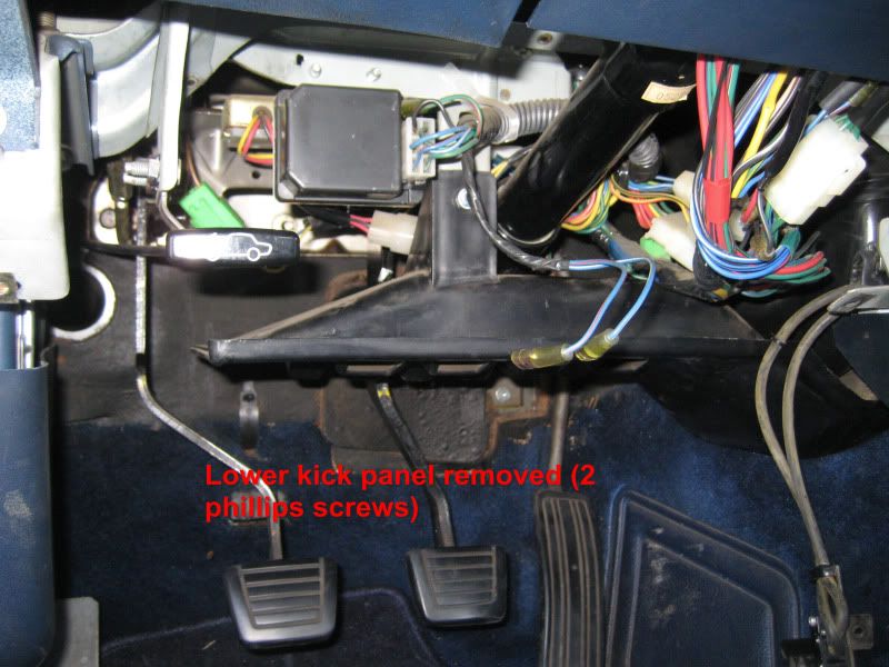

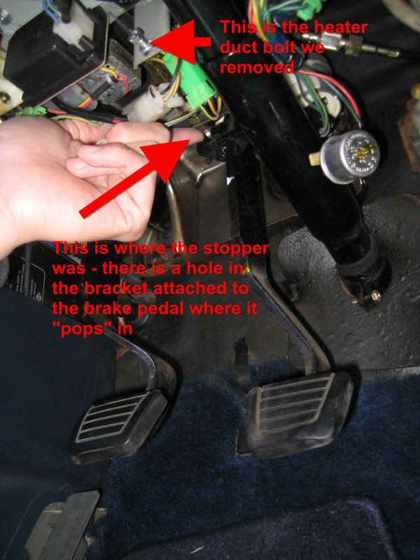

PhilbertZ Posted April 30, 2010 Author Share Posted April 30, 2010 thanks guys - I'm so glad I posted here and learned the cause for this. I broke down and called the dealer to see if they may have this 30 year old part....lo and behold they did - for less than $3.00. I picked it up today, installed it, jumped the Z, and HOORAY - no more brakelights!! Below are some photos to guide anyone looking at this in the future who may come across the same problem. The one thing that startled me (and this just happened now while looking at all the photos I took), is that there seems to be a second switch, also actuated by the brake pedal - and I'm missing that stopper too! Does anyone know what that switch is for? PHOTOS! Quote Link to comment Share on other sites More sharing options...
woldson Posted May 1, 2010 Share Posted May 1, 2010 Cruise control I would guess. Quote Link to comment Share on other sites More sharing options...
PhilbertZ Posted May 1, 2010 Author Share Posted May 1, 2010 Cruise control I would guess. That could explain why it's never worked! Thanks Guess I'll get a second stopper and report back when installed. Phil Quote Link to comment Share on other sites More sharing options...
