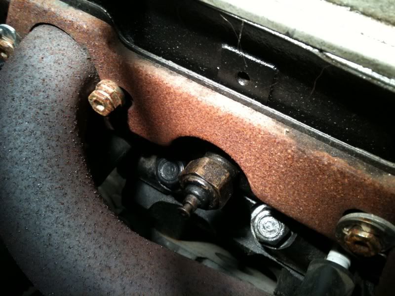

FiveSeventyZee Posted April 28, 2010 Share Posted April 28, 2010 I found this on the driver side of my L98. I'm not really sure what it is but it looks to me like it may be some sort of sensor? Anyone know? The engine's from an 89 Camaro if that helps Quote Link to comment Share on other sites More sharing options...
hoov100 Posted April 28, 2010 Share Posted April 28, 2010 cylinder head temp sender. (it tells the carburetor how much coolant needs to bypass the trans cooler.) Quote Link to comment Share on other sites More sharing options...

Drewz75t Posted April 28, 2010 Share Posted April 28, 2010 I found this on the driver side of my L98. I'm not really sure what it is but it looks to me like it may be some sort of sensor? Anyone know? The engine's from an 89 Camaro if that help Looks like a coolant temp sensor. Thats where i have mine installed. Quote Link to comment Share on other sites More sharing options...
deja Posted April 28, 2010 Share Posted April 28, 2010 You should have another temp sender near the thermostat. The one on the head will be more relevant but the one by the thermostat is normally connected to the temp gauge. Quote Link to comment Share on other sites More sharing options...
FiveSeventyZee Posted April 28, 2010 Author Share Posted April 28, 2010 I have one that goes to the gauge but what should this be hooked up to? Quote Link to comment Share on other sites More sharing options...
Geking Posted April 29, 2010 Share Posted April 29, 2010 I have one that goes to the gauge but what should this be hooked up to? Depends. What is in your car? In mine my FI system uses the front water pump port, while the head port (rear passenger side, but same difference) is for the gauge. I just felt like setting it up this way, no real must be that or must be this way. In other words, If you are using a carb with a manual choke, then you only need one temp sender(for the gauge.) If you are using FI you must have a temp sensor for that. Quote Link to comment Share on other sites More sharing options...
FiveSeventyZee Posted April 30, 2010 Author Share Posted April 30, 2010 Ahhh, as I have a carb'ed setup with a manual choke that would make sense that it isn't hooked up to anything. I have another one on the passenger side hooked up to the gauge. So in the event that I go with a carb with an electric choke ever I would just hook this sensor up directly to the electric choke on the carb? Quote Link to comment Share on other sites More sharing options...

strotter Posted May 20, 2010 Share Posted May 20, 2010 The sender near the thermostat for the ecm. The one on the side (pictured) is for the electric fan, at least on Camaro/Firebirds. Quote Link to comment Share on other sites More sharing options...
FiveSeventyZee Posted May 20, 2010 Author Share Posted May 20, 2010 The way the PO had it set up has the temp gauge on a sensor on the passenger side of the engine and this one bare, should I just leave the temp gauge one there? Quote Link to comment Share on other sites More sharing options...
