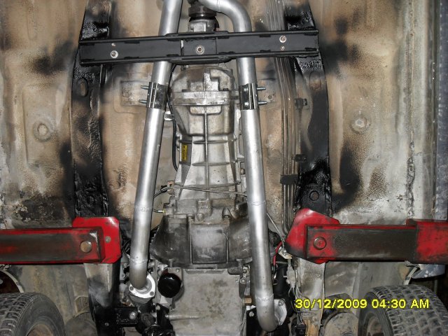

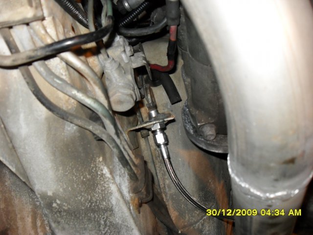

SUNNY Z Posted May 12, 2010 Author Share Posted May 12, 2010 Good info guys! Keep it comin! Side note: just installed a N.O.S. plate kit on the SBC. The fun is back in the car! Just jetted for a 100 shot...for now! Quote Link to comment Share on other sites More sharing options...

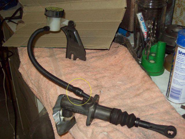

Boy from Oz Posted May 15, 2010 Share Posted May 15, 2010 I trust this is not too OT but I had intended to fit a GTO clutch m/s with my LS1/t56 install. I am concerned by the failures of these cylinders experienced by 'm1noel' and 'RB30X'. I've had a close look at the units and thought the problem might with the swivel connector on the line from the reservoir to the m/c, rather than the cylinder itself. Could either of those gentlemen advise me whether the leak was noticed in the engine bay or the cabin. Thanks. Quote Link to comment Share on other sites More sharing options...
RB30X Posted May 16, 2010 Share Posted May 16, 2010 (edited) Yeah mate, the leak was definetly in the cabin from the rubber boot, as in the piston seal was leaking. And for what its worth, my clutch pedal has a hole drilled a little higher up than the standard piston rod to reduce piston travel. Edited May 17, 2010 by RB30X Quote Link to comment Share on other sites More sharing options...
RB30X Posted May 22, 2010 Share Posted May 22, 2010 Pretty sure I've found the problem after stripping the MC for the second time. The piston was travelling too far foward allowing fluid to bypass the rear seal. I will either reduce the rod length which is already pretty adjusted, or increase the bump stop on the clutch pedal. Should be all sorted after that. Quote Link to comment Share on other sites More sharing options...
SUNNY Z Posted May 23, 2010 Author Share Posted May 23, 2010 Pretty sure I've found the problem after stripping the MC for the second time. The piston was travelling too far foward allowing fluid to bypass the rear seal. I will either reduce the rod length which is already pretty adjusted, or increase the bump stop on the clutch pedal. Should be all sorted after that. I couldn't for the life of me figure out what was off in those pictures. I just realized your car is right hand drive! cool. Quote Link to comment Share on other sites More sharing options...
