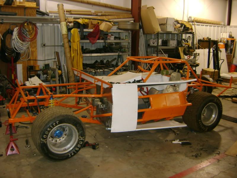

fcdrifter13 Posted May 7, 2010 Share Posted May 7, 2010 (edited) So I have gotten bored with my restore and want to make my 260 in to a dirt car. I have a '77 nova I race already but the six cylinder class will let me do more. My issue is my nova is setup and tuned in it has a ford nine inch with 6.00 gears and a few other things I cant do to the z. I was wondering if anyone out there had any advice or experience they would be willing to share since the cars are way different. Just get it out there and do a couple of good alps and work from there, we finally dialed in my talon and it now turns like a RWD on the dirt and is pretty damn peppy for a junkyard class. This year this is what I am working on for a buddy, had to basically restore a 3 year old super late chassis, not fun. Edited May 7, 2010 by fcdrifter13 Quote Link to comment Share on other sites More sharing options...
