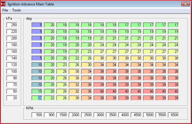

I doesn't sound all that good. I am assuming it's a stock cam right? It should pur like a kitten. Did you calibrate your timing? I'd set you idle timing to 30 deg or so, it will smooth the idle right out.
Check all of you intake connections. When it wasn't running right it sounded like a intake leak.
30 degrees? Really? Maybe I'll try that! I'm at like...15 now, is that bad? What is stock advance? 30 just seems pretty extreme for idle, but maybe not. Thanks!
Again, did you calibrate your timing so that the actual timing (as seen with a timing light) matches what you see in Megatune? If you haven't done this, then your timing table means nothing, and your timing is probably way off.
At no load (idle), you can run a lot of timing. Doesn't hurt, just gives it a nice idle.
How much boost will you run? 250kPa (150kPa above atmospheric) = 21psi. Do you really want to run 21psi? Your timing at 15psi will be 21 deg according to your table. But if your calibration is off, who knows what it will be. Best to verify your timing calibration before doing anything else. I would also suggest spending a few hours on a dyno to get the tune close.

Yes, my timing does line up. I set it to 10 degrees advance while cranking and that is what it is showing. I am running the stock 7 PSI for boost right now, so I do not need that high of a kpa scale, but I have yet to find a good timing map that maxes out at 7 PSI kPa equivalent. Perhaps someone could throw one my way? Thanks!
+7psi=150kPa. 27 deg is probably safe with 93 octane. Yes, you can change the scale to get more VE and timing bins in the engines operating range. You need to know what you plan on running for max boost and set the VE and timing table scales accordingly.
Max Boost: 7 PSI (stock, for now)
