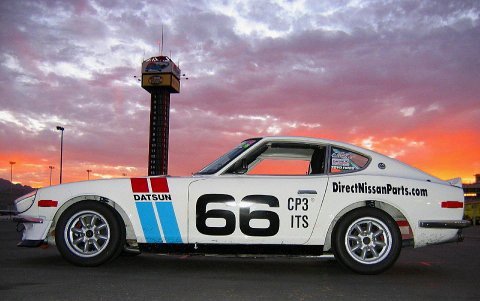

mickey3 Posted June 15, 2010 Share Posted June 15, 2010 If you have noticed the rear wheel is not centered front to back in the fender on the s30 chassis. I took out a measuring tape and the wheel center is about two inches closer to the front of the fender than it is the rear. My question is, has anyone tried centering the wheel in the fender? I can see four possibilities here: 1. Actually move the rear drive line assembly suspension and all back one inch. 2. Widen the fender to the front of the car by two inches. 3. Pull the rear side of the fender in by two inches. 4. Do a one inch combination of 2 and 3. I appreciate any advice that you can give. Here is a picture. Notice how much closer the tire is to the front of the fender than the rear. Quote Link to comment Share on other sites More sharing options...

johnc Posted June 15, 2010 Share Posted June 15, 2010 Look at the strut and the strut tower in the body. Think about the angles if you move everything back 2". Quote Link to comment Share on other sites More sharing options...
JMortensen Posted June 15, 2010 Share Posted June 15, 2010 Look at the strut and the strut tower in the body. Think about the angles if you move everything back 2". Exactly. Move the wheel back and the strut changes angles, but the control arm cannot compensate. The more the suspension compresses the worse the angle on the strut becomes, so the worse the suspension binds up. If you really need the wheel in the center of the wheel well you should swap out a different suspension system and set it up so that the angles are all correct when the wheel is centered. Quote Link to comment Share on other sites More sharing options...
Snailed Posted June 15, 2010 Share Posted June 15, 2010 Exactly. Move the wheel back and the strut changes angles, but the control arm cannot compensate. The more the suspension compresses the worse the angle on the strut becomes, so the worse the suspension binds up. If you really need the wheel in the center of the wheel well you should swap out a different suspension system and set it up so that the angles are all correct when the wheel is centered. I agree with you guys, non of that stuff applies to my project though. I have an s13 rear subframe that I will be modifying to use under my 240z. I plan on building everything from the front rails to the rear subframe mounts from scratch...it needs floors anyway. So as a result, the wheel will be centered. I might even move it back a little more than that depending on what I come up with for flares. Quote Link to comment Share on other sites More sharing options...
