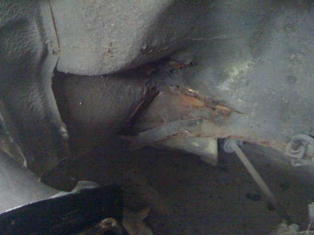

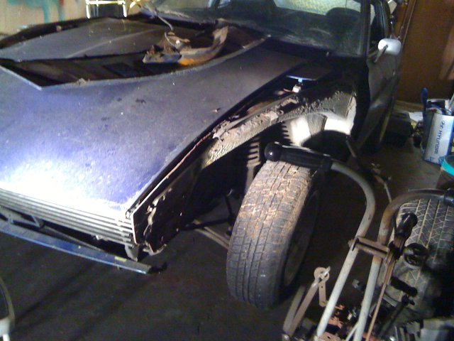

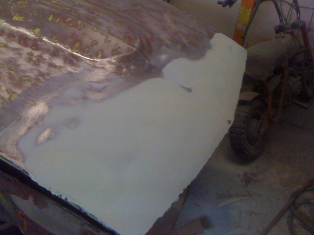

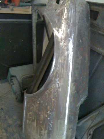

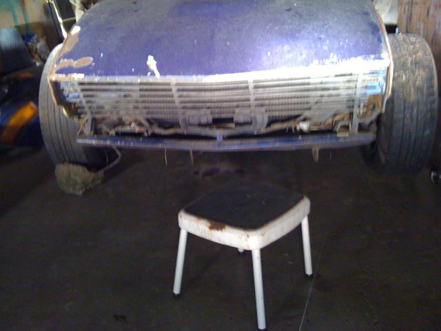

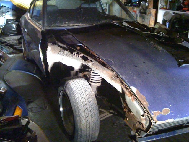

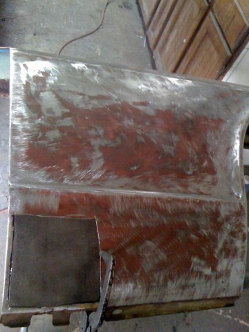

S30rb25 Posted June 22, 2010 Author Share Posted June 22, 2010 sorry that all the pics are from my i phone but i think they show that i got most of the rust out and am on track to getting it back to its former glory. and for the section where the body meets the frame i have cut all that away and have a new piece ready to go in and my dad made a piece to weld into the frame to strengthen and fix that as well Quote Link to comment Share on other sites More sharing options...

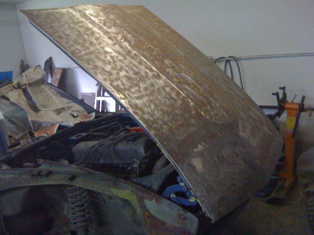

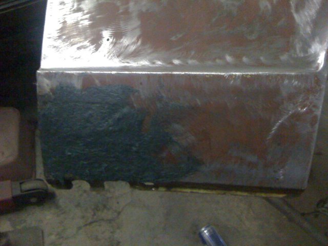

S30rb25 Posted March 14, 2011 Author Share Posted March 14, 2011 finally have a few picture updates of some progress made, havent had time to do much lately so things are moving a little slower than i would like. but here it goes. finaly replaced the rusted out battery tray, did some more body work, not shown but stripped the interior, got the motor set in started tearing it down, pulled the old motor tranny driveshaft and exhaused. the fresh motor is back from the machine shop and is being put back together, now i gotta finish the body work and clean up the engine bay, and a few other things that i know i am forgetting Quote Link to comment Share on other sites More sharing options...
