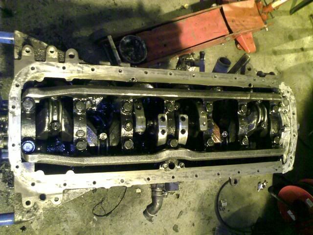

Oh yeah, get a motor out of an W140 s-class or get the oil pump/pan out of a W140 S class. Any OM603/6 or M103/4 pan/pump will work. The pumps are all OM part numbers anywho. Reason being it's mid sump, most Merc's are front sump.

Or maybe a RD28 bottom end, with a RB head?
The RD28 looks like a RD from the bottom.

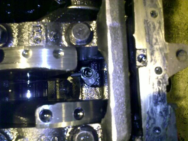

Pick a RD28 turbodiesel, and get oilsquirters under the pistons!
All the oil and water matches, exept the rear oil drain, but then,
the RB heads usually gets extra oild drain in the rear anyway...
