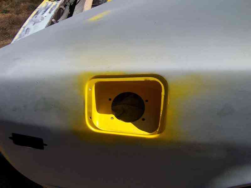

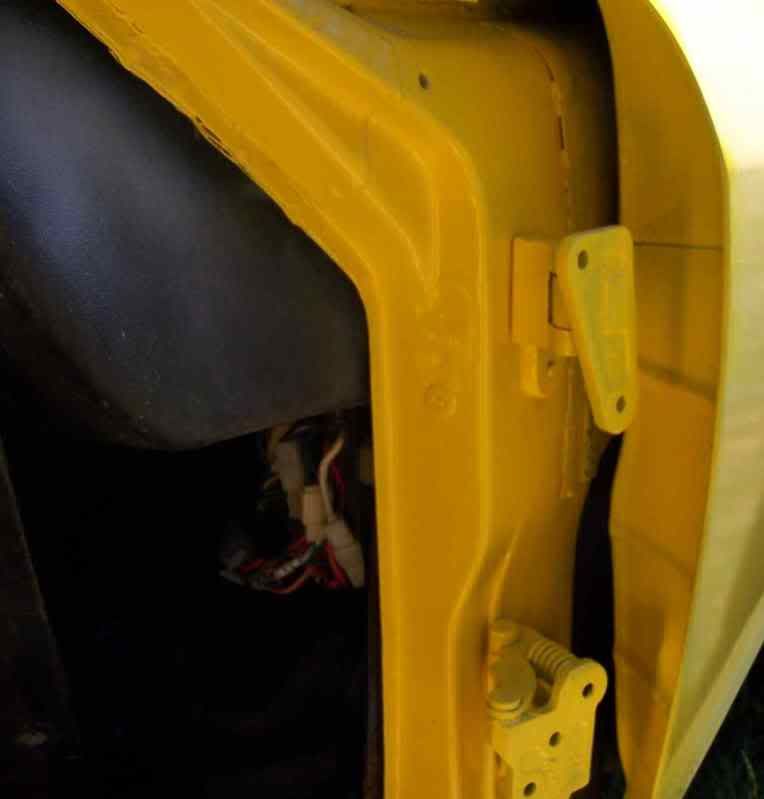

goodoldjam Posted August 25, 2010 Share Posted August 25, 2010 (edited) Well decided to go the rustoleum route. Car is a old rattle can job from PO, with alot of bad bodywork. Got a jam done and working out some more of the ID areas. Bodywork wise it hasn't been a $75 job, especially not in time. Accidentally hit enter and posted this a little soon so I'll try and get up a picture of the door jam. It's Sunburst yellow, not sure how it's going to turn out. I'm using a roller and spray cans for those hard to reach areas. So far it looks like it should come out OK for a rust bucket, much better than the faded orange peel rattle can that was on there. Edited August 25, 2010 by goodoldjam Quote Link to comment Share on other sites More sharing options...

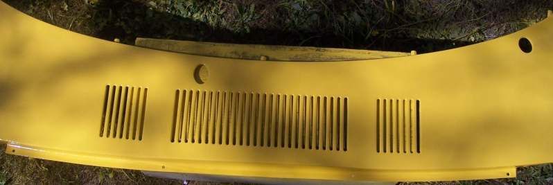

goodoldjam Posted September 6, 2010 Author Share Posted September 6, 2010 Well got a couple things I learned about Rustoleum primers. Don't use the Non automotive primers, they take 48 hours to dry Difference being I believe that most their primers are oil based like the paint. The automotive primers are sandable in 4 hours. Also don't spray buildable over sealer primer before the sealer fully cures, they look like the same thing apparently they are not. Been playing with the HF gun and it needs it mixed thin or it won't spray, Mineral spirits seem to make the paint run like water. It doesn't spray like automotive paint at all, so it's time to move to something hotter like acetone. The mineral spirits do however self level well, but so does water. The Mineral spirit mix does adhere better if you have a coat already on something though. Quote Link to comment Share on other sites More sharing options...

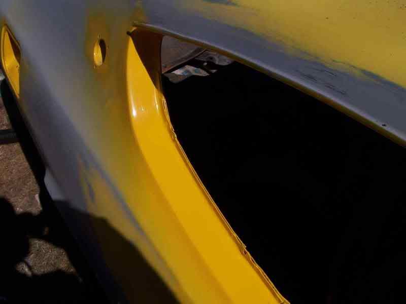

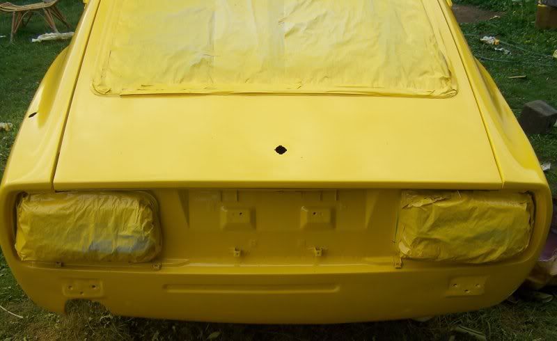

goodoldjam Posted September 12, 2010 Author Share Posted September 12, 2010 (edited) i still think my post will help you out, I covered mineral spirits vs lacquer thiner Your post is very helpful. I made the switch to acetone, mixing a 50/50 mix because the HF gun has trouble spraying thicker. Mostly I did a 50/50 mix out of fear and will probably reduce it a bit more because it is looking like it is going to leave some nasty orange peel but only on things I actually care about people seeing. It covers well and I'm not seeing the the runs. Mineral spirits were a flat out mistake and not just because of runs, that stuff takes forever to cure. Combine that with it pooling and it is a huge headache, especially if you want to move along in less than a week. Anyway it's looking promising and Tomorrow I will get some pictures of what happens when you spray over the mineral spirit mix a couple days later. I also have the cowl piece sprayed with the acetone 50/50 mix, which I'm expecting to have probably sand smooth and respray with a thinner mix. Basically it's my test piece and I should be able to come up with the best mix before I go after the rest of the car. The key being minimal runs and minimal orange peel or some kind of balance but runs being the biggest evil to avoid. Meph I love the leave the bugs alone advice. I always want to figure out a way to get them out, No way in hell. That is one benefit to the Mineral spirits, it wasn't as appealing to gnats but still it's not worth using with how that stuff runs. Edited September 12, 2010 by goodoldjam Quote Link to comment Share on other sites More sharing options...

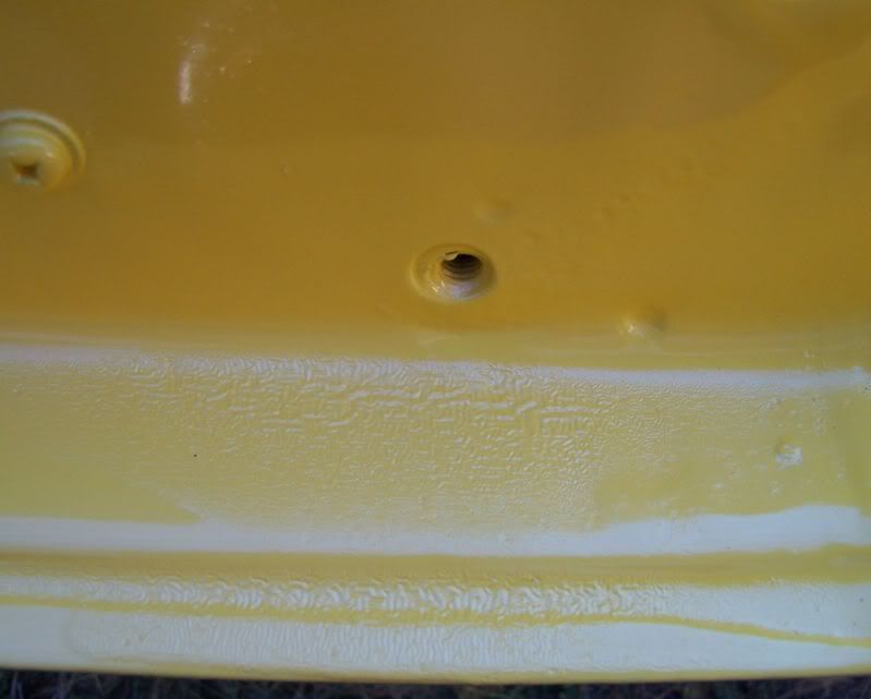

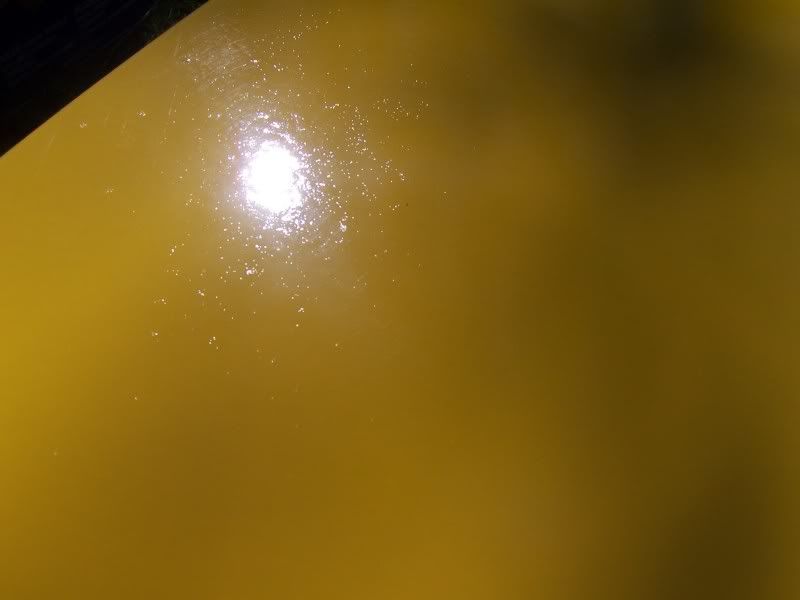

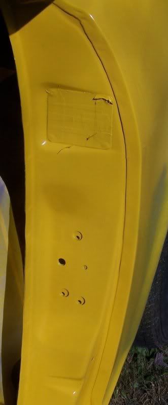

goodoldjam Posted September 12, 2010 Author Share Posted September 12, 2010 (edited) Here's what can happen when you respray the Mineral mix 2 days later. This is a spot where it had pooled up a bit and really it probably will never fully cure. Here is a close shot of the 50/50 acetone mix. I tried to get sunlight on it, but the color makes it tough to take a picture of orange peel. This was done yesterday and it feels fully cured and probably just about sandable. This jam was finished with rattle can, because the MS mix wouldn't cover. Out of a can doesn't leave a bad finish, I went this route because I wanted to get it done without pulling out the gun. Basically I'm almost done with the jamming, minus a couple spots where it wrinkled. With the acetone mix I don't think I'll be seeing this issue anymore. I think the thinner that is in the can is Toluene, maybe another good option. Edited September 12, 2010 by goodoldjam Quote Link to comment Share on other sites More sharing options...

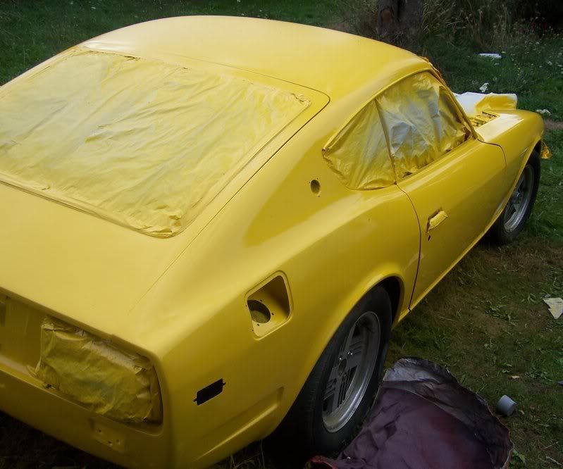

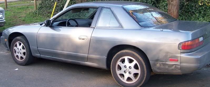

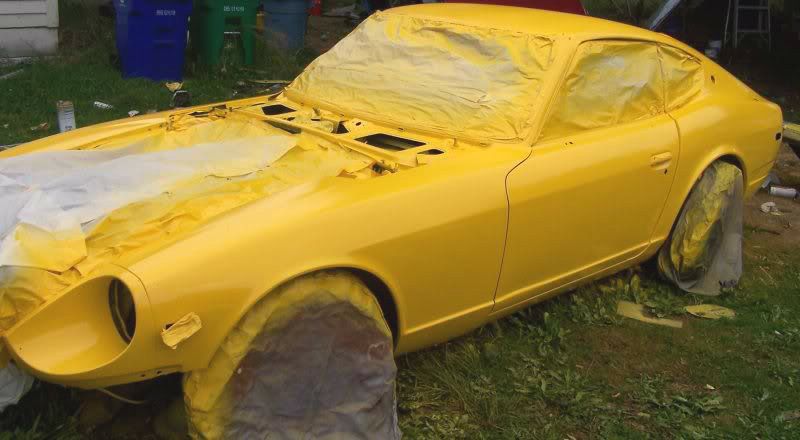

goodoldjam Posted October 7, 2010 Author Share Posted October 7, 2010 (edited) Well my backyard hillbilly job is getting close to done. I'm fairly happy with it considering I wanted to get a shell and startover. More work to be done, some runs and a bit of touch up. If anyone asks me why I painted in the yard I'll tell them I wanted to do it like they did in the old days. Just like TonyD Said "all done easily in the driveway, like they have been done for over 100 years!" This was painted with 1 part rustoleum to 3 parts acetone. It seems to lay down alot better then the 50/50 mix with less runs. The airless really couldn't spray much thicker without spitting the paint. Here's a car my brothers buddy had painted at Maaco. He took some crap for this one, that wrinkled quarter is freshly painted. I think the jams were purple and alot of the trim is also freshly painted. He even slipped the painter some extra money, thinking he may do a better job Edited October 7, 2010 by goodoldjam Quote Link to comment Share on other sites More sharing options...
