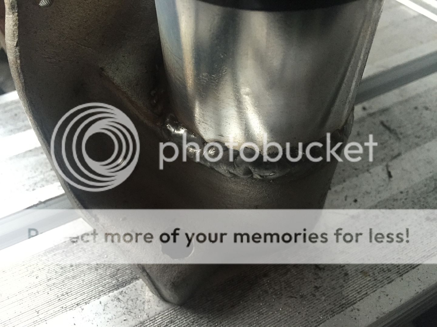

seattlejester Posted December 24, 2015 Author Share Posted December 24, 2015 I assembled the hybrid axle (1995 WD21 housing, WD21 spider gear, WD21 shaft, Febest G35 spider gear, Herra 280zx turbo housing) then had to take it all apart and reassemble it as I realized I forgot to install the inner clamps. Axles have been greased backup with the clamps in the proper place with the boots, just waiting to be tightened up and wiped down waiting for install. Next I finally decided to weld on the coil-overs. I cut down the uprights to 45mm as the instructions stated indicated with a scribe mark using a micrometer. The rear went in easy enough, the BC coilover adapter was a tight fit and after wiping down both the hub and the adapter I slipped it on and made sure it was seated and put a bead all the way around. I'm tempted to run a double or triple pass over it, but I can't imagine it breaking in any way since the only way to break it would be to pull away from the hub and I can't imagine any force that would accomplish that. I suppose it could lean and pull at the weld, but it is also lined up with the tube so that would still probably not happen. Still need to wire brush it and look for any weak points before painting so I'll have another chance to review. A note is that it can get quite tight with a mig setup as you near the stub axle housing. I tend to run a little extra gas anyways so the additional sickout needed to weld it was not too problematic. Just make sure you hit the hub before you hit the adapter or you are going to have to build from the adapter back to the hub which will make a much larger weld. The fronts are a little more problematic. The front hubs have a little hump that prevents a cylinder from sitting flat, so other manufacturers machine a little clearance so make it easier to seat, BC does not do us the favor. I already came into this knowing this would have to be done and I'll credit this to BC still being relatively new to our chassis, still would have been a nice touch though. I'll have to set aside some time to attack it with a grinding wheel and test fitting, but I expect it will go on similarly quickly. Plan is after finishing to just primer and paint the uprights, or else I would have to strip the adapters for powder coat and I'm not quite willing at the moment. Further plan given how I have seen these types of coilovers rust is to run anti seize where relevant and to spray some chassis wax in side the strut housing to prevent any moisture from pooling between the adapter and the upright. Once these guys are sitting pretty it will be time for the big install. Will have to clean up my space a bit add more lighting and I'm actually planning on getting some carpet to lay on. Some scrap carpet for a couple bucks at a warehouse place can make it actually quite nice to lie on concrete, and if it gets dirty you are out a few bucks so not the end of the world. Quote Link to comment Share on other sites More sharing options...
seattlejester Posted December 24, 2015 Author Share Posted December 24, 2015 In retrospect, I should have seen where the coilovers bottom out in the adapter and see if I am missing out on any space. Hopefully the purchase of the extreme low version will allow give me the range I desire. Will have to check for the fronts. Quote Link to comment Share on other sites More sharing options...
seattlejester Posted December 28, 2015 Author Share Posted December 28, 2015 After much searching, it seems like the extreme lows will go indeed quite low (bottom out the frame rails if desired) so I don't think I'll mess with maximizing the minimum height adjustment. Also after spending some time with a grinder I can kind of see why a notch could be difficult. It really isn't just a notch, more like a parabola, the sides need to be ground down quite a bit in addition to the main hump in order to assure a real close fit. Having learned how to weld it from the rear, I turned up my gas a bit and was pretty easily able to weld the adapter with just additional stickout on the welder. I welded a nice wide pattern so I don't have reservations about having to revisit the fronts. Pretty much done welding for the time being. Had to stop to go and install some rotors and brake pads in the daily. Need to cleanup still along with flip the car around, but pretty much all good to go in the front, need to stop by the powdercoaters sometime next week to see about getting some of the rear end pieces coated up. Quote Link to comment Share on other sites More sharing options...
