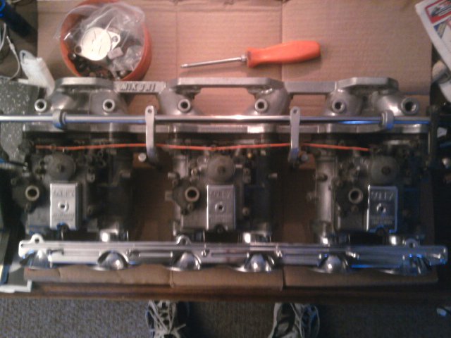

rayaapp2 Posted January 3, 2011 Author Share Posted January 3, 2011 Tony, Back to the Mikuni intake manifold for a moment. It seems the throttle linkage has an issue. The stock throttle linkage mounted to the firewall does not align to the Mikuni Throttle shaft? What is missing? Was it not designed at all for the Z? I may have to call wolfcreekracing and see what Im missing. More phone calls. The phone call list is getting long. Quote Link to comment Share on other sites More sharing options...
madkaw Posted January 3, 2011 Share Posted January 3, 2011 I am looking at my instruction book that came with my Mikuni set-up for the L24-L28 and it shows the wall mounted part of the linkage needing to be 'raised above the seam'. Now my set-up is using the Mikuni manifold with the short runners. Don't know if that helps, but I haven't tried to install my Mikuni's yet since I am still working on my top secret cold air box. Quote Link to comment Share on other sites More sharing options...
Tony D Posted January 3, 2011 Share Posted January 3, 2011 The stock linkage for the mikuinis went to a pivot that mounted to the jet cover/float cover of the #3 carb. There was a short transfer linkage that connected these togehter to the crossbar. This is why I went throttle cable. Actually, it's not, i tried to braze the stock throttle linkage into the hole on the Mikuini piece, at which point I realized they had also made it from chrome plated brass. I discovered this as I poked the brazing rod into the 'red hot' linkage bit and promptly collapsed the arm of the damn thing. At THAT point I decided to use a quadrant I had and convert to a throttle cable. Quote Link to comment Share on other sites More sharing options...

rayaapp2 Posted January 10, 2011 Author Share Posted January 10, 2011 (edited) Another issue has arisen. The Mikuni Intake Manifold doesnt appear to clear the stock air injection stuff. It appears I will have to modify or indeed delete my air injection if I install this manifold. Is this the general consensus? I have the Trust/Greddy/Nissan Sport/etc header I can use that deletes the air injection ports I could use instead of my current header with air injection. Someone want to save me the time of test fitting all this stuff together. My build could be much easier without the air injection, but I was hoping to keep the AB valve as well as reduce the extra smell of the exhaust without the air. Without the air pump my crank trigger situation becomes a no-brainer install as I can use the later balancer and still retain my AC system as well as free up that extra 1.5-2hp the air pump uses. The only other downside to all this is that I will have to re-engineer my exhaust system for the new header. Mikuni Manifold Porting Info... Good Stuff I found while looking for fittment info. Ive got a breakdown of the build. I have $3800-4000 to spend on this max so Ive got to spend it wisely. Building an L series to make power isnt cheap. The process could take 3 or 4 months and I might be able to inject more money into this, but right now this is the amount I have to work with and Id like to get it running with that. Headwork ~$1250-$1500 includes -valve grind -valve seat R&R if needed -surfacing -street porting -camshaft setup -includes cam wipe pattern, stem heights, and spring installed heights -new lash pads -port matching intake manifold Camshaft ~$250 Valve stem seals viton "A" series $TBD Radiator $210 N42 valves $0 should have a set around that is usable Head Gasket $180 Bottom End machine work $TBD Piston Set $TBD Complete gasket & seal kit $0 Have one already Timing chain & tensioner set $120 Rod and Main bearings $140 Tomei Adj Cam gear $200 Ignition system -Ford COP set $60-$80 -dereks EDIS mount $200 -EDIS-6 module, sensor, wiring all used $25 -Megajolt $180 -Crank pulley $0 already have one ~$3000 so far That leaves very little for the machine work, pistons, and valve stem seals. Little to say about any problems that may arise during the whole thing. Little things have not been accounted for yet either. Hoses, fittings, etc So the plan has evolved to this setup: Bottom End L24 P30 Block 2.5mm overbore L28 Crank L28 Rods 85.5mm flat top pistons 81 turbo oil pump already have Clevett 77 main bearings & rod bearing ARP rod bolts ARP head studs Nismo .6mm head gasket MSL Timing chain and tensioner set Top End Tomei timing gear adjuster Isky regrind cam Lash pads for new cam N42 I and E valves replace felpro valve stem seals with Datsun "A" series viton engine valve stem seals for cam lift clearance polish combustion chambers light porting around seats Mikuni intake manifold dowel intake manifold for port fit Nissan Sport/HKS/Trust/Greddy/who ever else sold this header for use with Mikuni manifold Mikuni Solex Carbs 40PHH 2.721L displacement 10.6:1 static compression redline set at 7500 power building from 3000rpm to 7200rpm Premium fuel requirement probably dyno tuned on 110octane Edited January 12, 2011 by rayaapp2 Quote Link to comment Share on other sites More sharing options...
rayaapp2 Posted January 11, 2011 Author Share Posted January 11, 2011 Mocking it up on a spare E30 head and a saw horse. Lots of room between the headers and the mikunis Here are my clearance issues. The Air injection system will not fit with the Mikuni manifold. The Check Valve on the air injection tube will not clear the manifold or linkage rod tower. So then I decided to use option #2 header. As you can see with this header my AC compressor will have clearance issues as well. So I have to relocate the AC pump stuff down to the later L series location. Its not that big of an issue as I was going to go to a newer rotary pump anyway. Quote Link to comment Share on other sites More sharing options...
