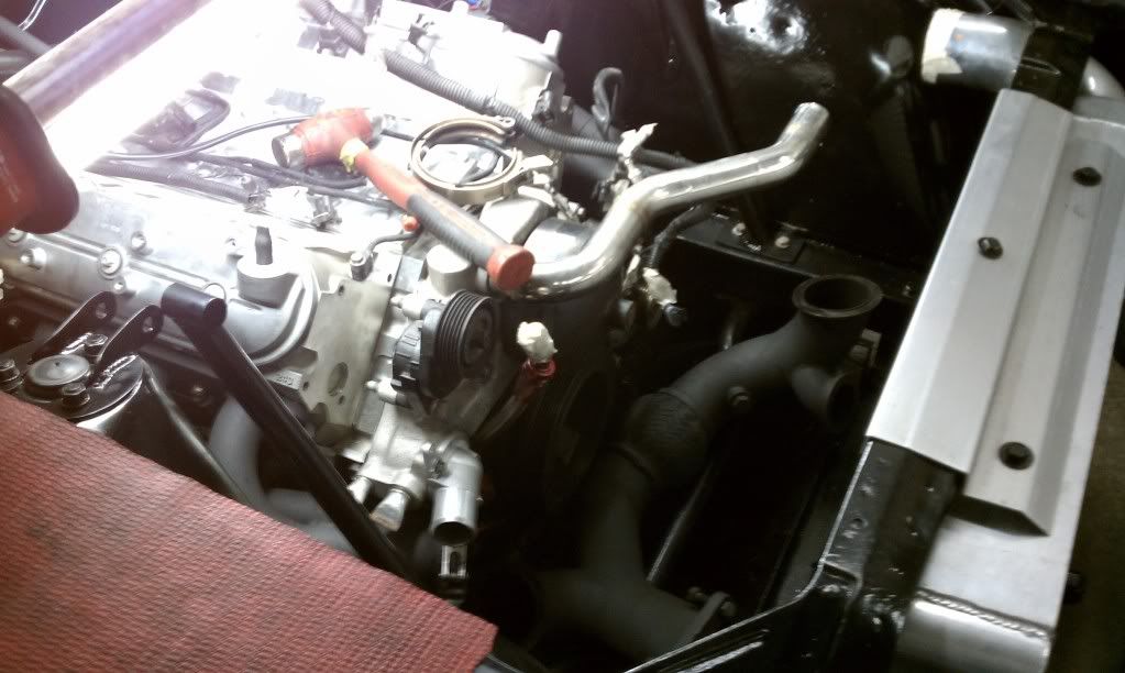

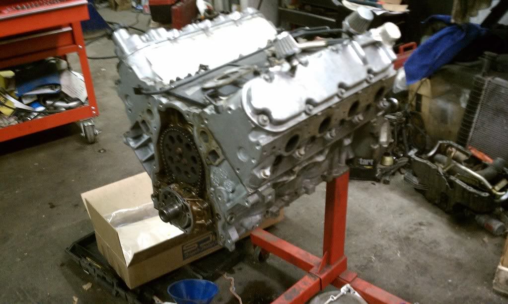

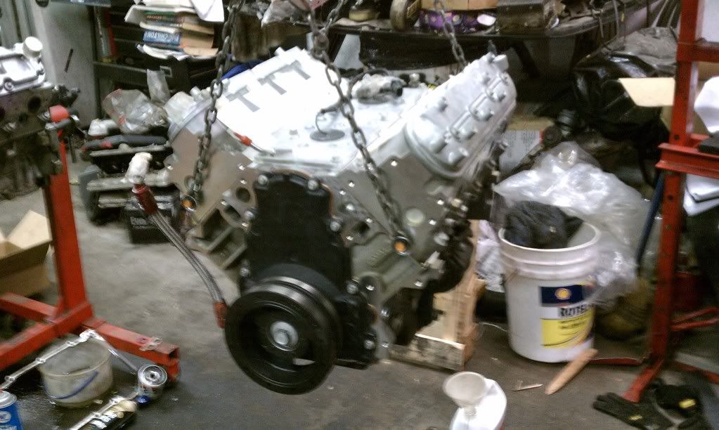

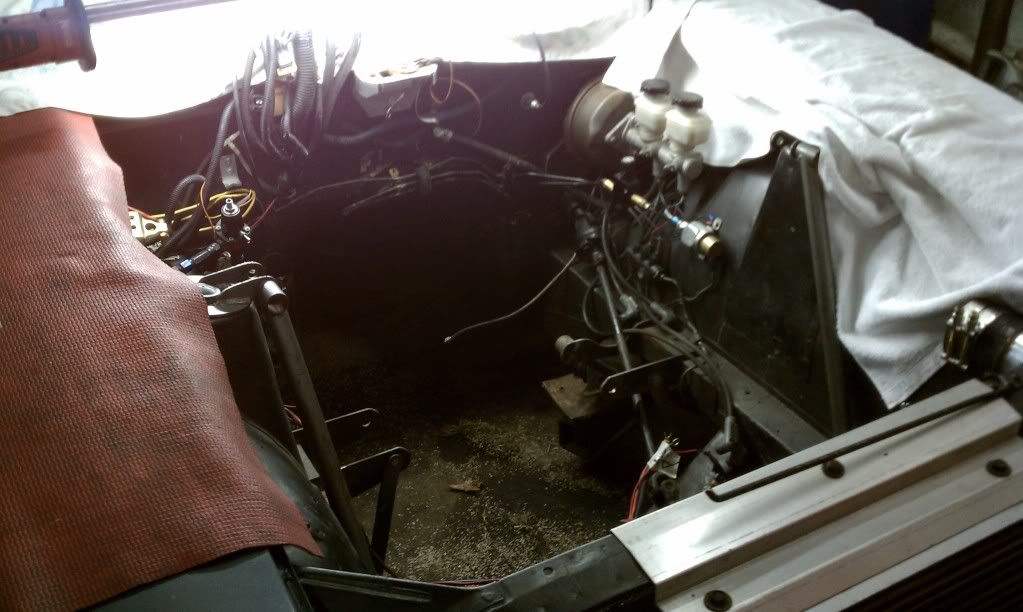

240zRacer Posted December 10, 2010 Share Posted December 10, 2010 (edited) the plan for this winter was to convert from the 6 speed to a auto and drop the car into the 9s, well fate had it that the old ls1 decided to have a oil pump failure and while it was caught instantly and caused no damage the ls1 was old and tired and in need of a refresh, so i decided to swap it out for a brand new 2005 Cadillac ctsv ls6 crate motor, this of course used my auto swap budget so i will be staying stick for the next season. i also had the turbo rebuilt and changed the exhaust housing to a larger ar to help with the ls6 higher revving and better flowing heads and cam combo. the motor should be in and fired up this weekend and i will post more pics and video as i get them, here is the only photos i have for now, the engine bay before being repainted, the old ls1 and the new ls6, i also am putting in a new stage 3 monster clutch while its apart. the power gain i get from the ls6 should also put me in the 9s in street trim so im not entirely bummed about not being able to convert to a auto. by the way the ls1 is for sale if any one knows of any one looking for one they can refresh, it has arp rod bolts, arp head studs, hardened push rods and ls6 valve springs already installed, it will need fresh rings and bearings and a oil pump. i am located in pa. i will update the thread with more photos soon. Edited December 10, 2010 by 240zRacer Quote Link to comment Share on other sites More sharing options...

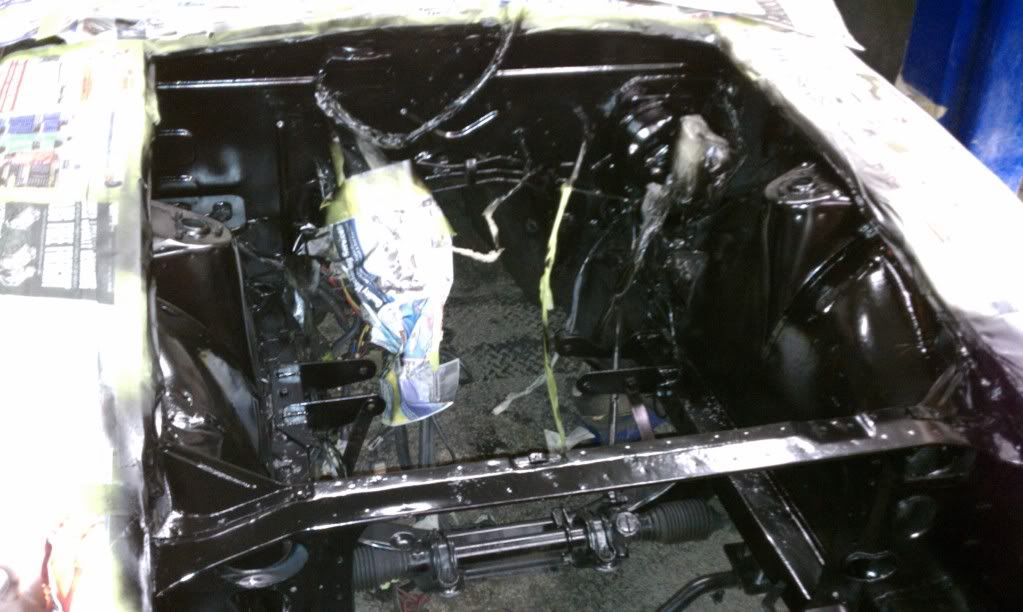

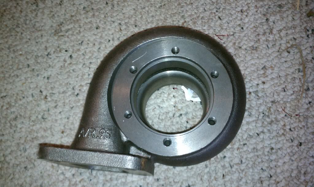

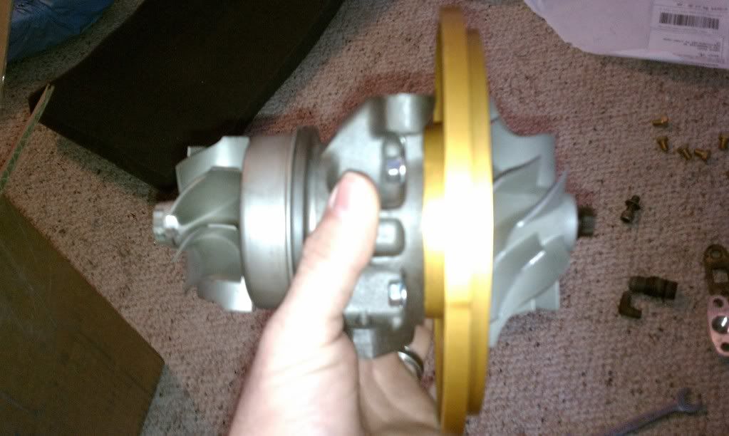

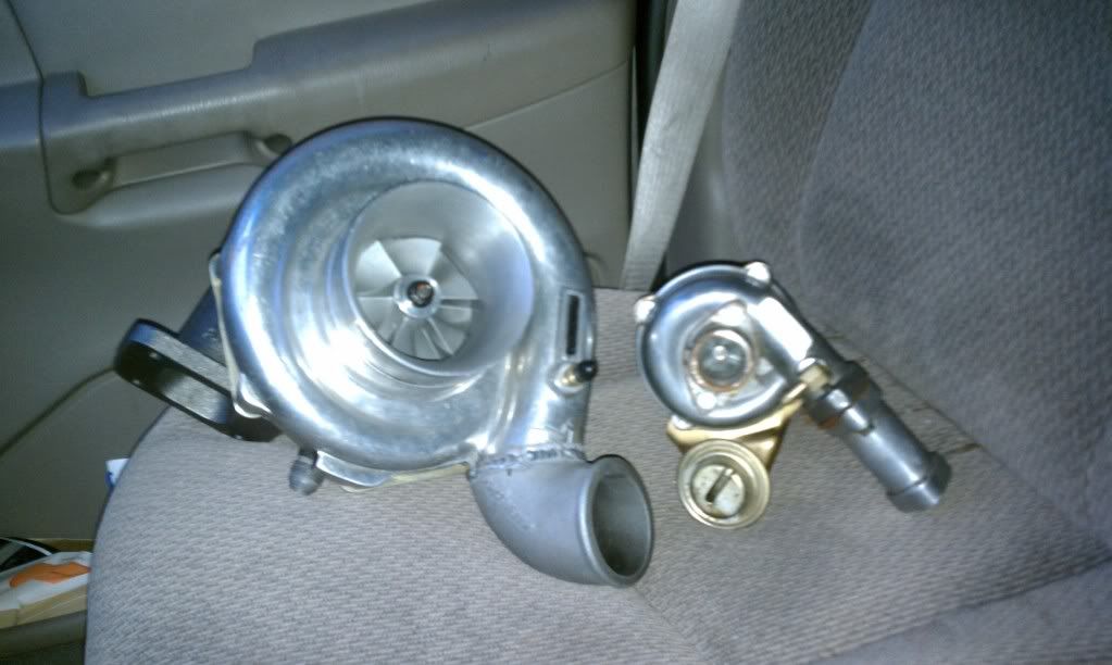

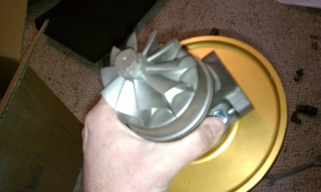

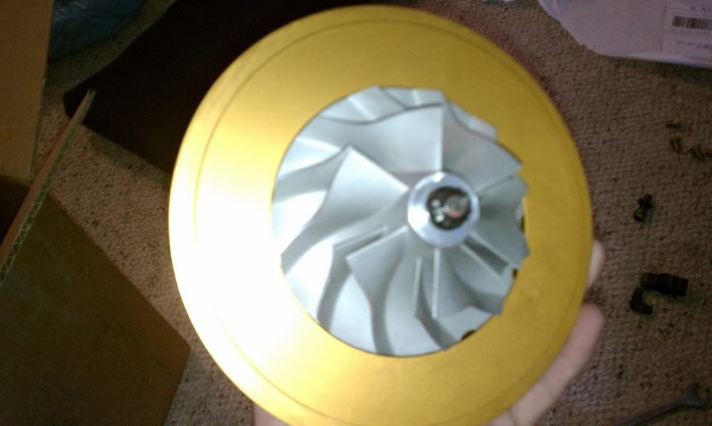

240zRacer Posted December 11, 2010 Author Share Posted December 11, 2010 (edited) more photos, including the painted bay, the minty fresh rebuilt 72mm turbo now with a 96 ar ex instead of the 68 i was using. and a picture of the two turbos i had to choose from for this build.... i think the bigger one would work best dont you? by the way if any one is in need of smoking deals on new , rebuilt turbos or getting a turbo rebuilt contact me. Edited December 11, 2010 by 240zRacer Quote Link to comment Share on other sites More sharing options...

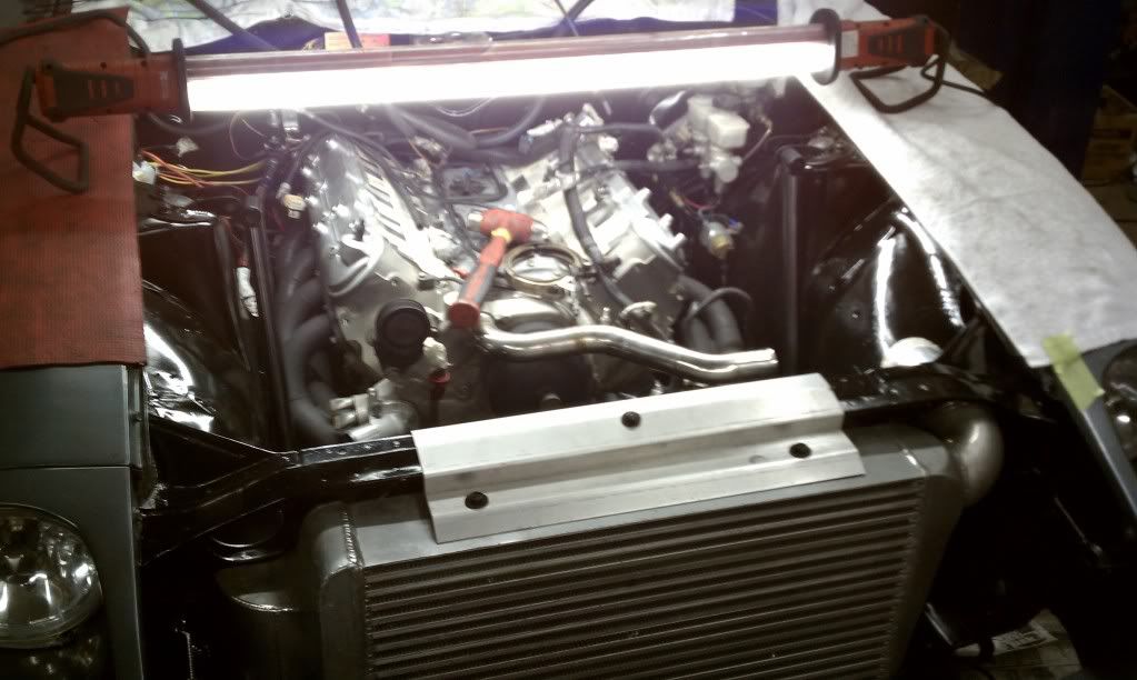

240zRacer Posted December 16, 2010 Author Share Posted December 16, 2010 motor and tranny is in, driveshaft and fluid and shifter done,exhaust, intercooler mounted. just needs intake, rad and a few hoses and wires finished yet. Quote Link to comment Share on other sites More sharing options...
mxgsfmdpx Posted December 16, 2010 Share Posted December 16, 2010 Awesome. What radiator is that? Quote Link to comment Share on other sites More sharing options...
jasper Posted December 16, 2010 Share Posted December 16, 2010 I'm thinking INTERCOOLER......... Quote Link to comment Share on other sites More sharing options...
240zRacer Posted December 18, 2010 Author Share Posted December 18, 2010 yeah the item shown in the last photo is a intercooler. Quote Link to comment Share on other sites More sharing options...
