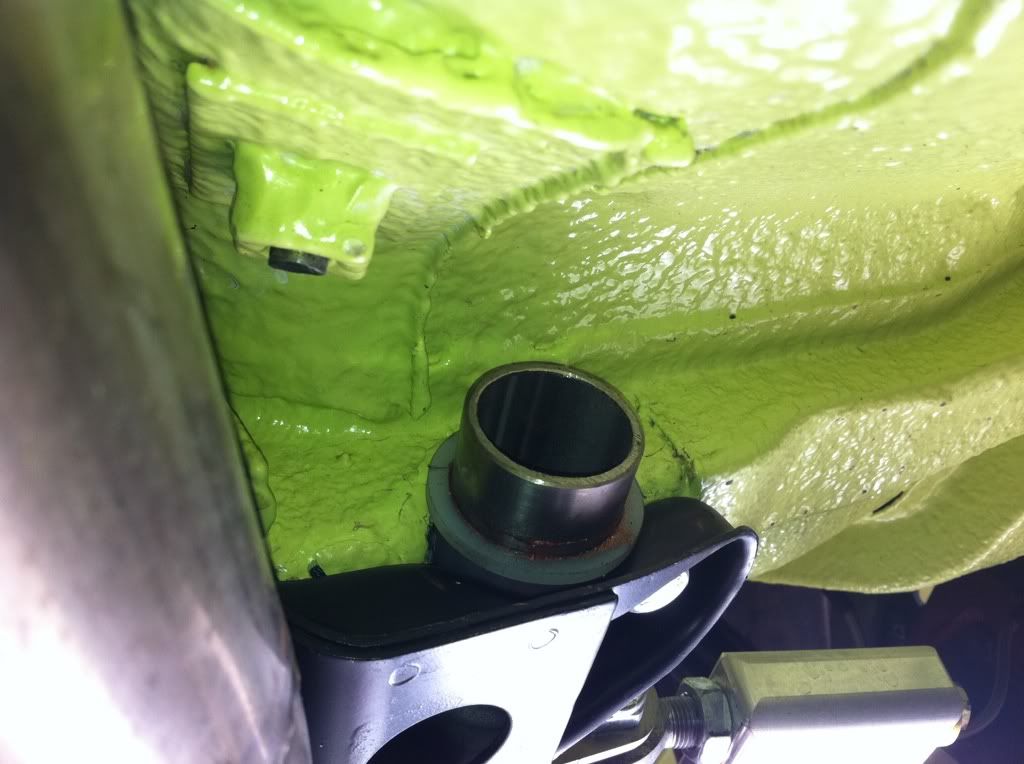

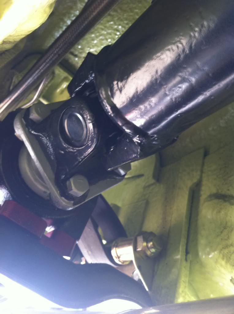

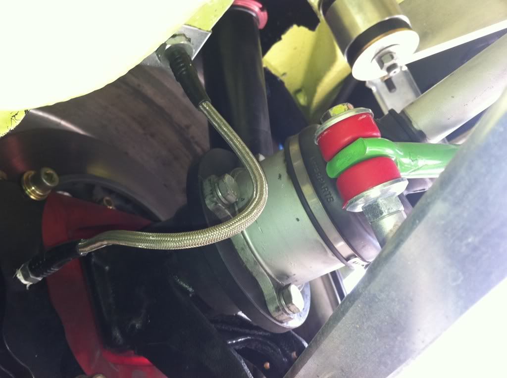

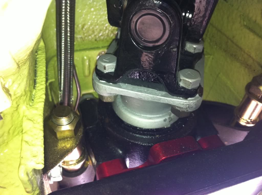

Blakt Out Posted December 19, 2010 Author Share Posted December 19, 2010 Well, it looks like everything is nice and tight under there. Here are some pics that I just took. It's a bit grimy under there, since I recently drove it 300 miles. Quote Link to comment Share on other sites More sharing options...

Leon Posted December 19, 2010 Share Posted December 19, 2010 It may be the angle of the photo in your third post, but how close is the rear ARB to your half-shafts? I had a bunch of clunks and rattles in the rear of my 260Z so I investigated. Mine was missing a diff strap bolt and had a lonely end link on the left rear control arm with no ARB attached. WTF? I removed the end-link and the metallic clanking was gone. Then I attached the diff strap and acceleration clunk was gone. So, check the ARB and end-links as another simple thing to do before tearing things down. Quote Link to comment Share on other sites More sharing options...

Blakt Out Posted December 20, 2010 Author Share Posted December 20, 2010 (edited) K, so I'm just reading up on everything I can find here... I'm not going to assume that the shop that built the car flipped the end cage of the CV shafts around to shorten them up the necessary 3/8", as noted in other posts (by Ross at Modern Motorsports too). Thing is, I don't know what they looked like before. So, can you guys tell from any of my pics if this has been done or not? Again, thanks for ALL the help, fellas. I'm thinking that this, if it hasn't been done, could be why I had shavings in the cap, which then might have messed something up, causing there to be slop. Edited December 20, 2010 by Blakt Out Quote Link to comment Share on other sites More sharing options...
