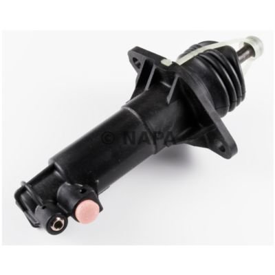

kamikaZeS30 Posted April 5, 2011 Share Posted April 5, 2011 (edited) Miles, that doesn't look like the slave I have. The one I have has the line going in directly on the "front" of the cylinder, not the top. I was told this was the stock slave cylinder for the Camaro T-5. I will see if the exact p/n is on the invoice and check the the p/n for the clutch/pressure plate kit. It may be because I'm using a weird combination of parts that even at full-travel of the throw-out it's not enough to engage the pressure plate fully. I didn't think of that, before. Then again, I wasn't the guy that put it together. I have a fairly standard rhinopac heavy duty clutch, the slave cylinder is listed a p/n "ew156024" but google search turns up nothing. It says that's the part number for a steering rack from a Fiat/Alpha Romeo/MG or something. Edited April 5, 2011 by kamikaZeS30 Quote Link to comment Share on other sites More sharing options...
Miles Posted April 5, 2011 Share Posted April 5, 2011 On 4/5/2011 at 8:10 PM, kamikaZeS30 said: Miles, that doesn't look like the slave I have. The one I have has the line going in directly on the "front" of the cylinder, not the top. I was told this was the stock slave cylinder for the Camaro T-5. I will see if the exact p/n is on the invoice and check the the p/n for the clutch/pressure plate kit. It may be because I'm using a weird combination of parts that even at full-travel of the throw-out it's not enough to engage the pressure plate fully. I didn't think of that, before. Then again, I wasn't the guy that put it together. I have a fairly standard rhinopac heavy duty clutch, the slave cylinder is listed a p/n "ew156024" but google search turns up nothing. It says that's the part number for a steering rack from a Fiat/Alpha Romeo/MG or something. The stock Camaro slave used a roll-pin connector to attach the hose to the slave. Is that what you have? Have you made any adjustments to the push rod and clutch pedal under the dash? There are two adjustments under the dash: push rod length is adjusted by turning the push rod in/out where it attaches to the clevis and you can adjust the clutch pedal bump stop to shorten or lengthen the over-all travel of the clutch arm. Be sure to leave a small amount in clutch pedal play. Can you post some pictures of your MC and slave set up? Quote Link to comment Share on other sites More sharing options...
kamikaZeS30 Posted April 5, 2011 Share Posted April 5, 2011 (edited) Wilwood Master... I'm guessing this is a 1" bore size, it looks much larger than the stock 5/8". ...and this is what I'm being told is the "self-bleeding" Camaro slave. Sorry about the image, but my engine bay is a little crowded. The body is smooth like that top and bottom, has no bleed screw, and the roll-pin was in the forward part of the cylinder (basically the body of the cylinder ends where the header hides the view and that's where my AN adapter and fittings are). Edited April 5, 2011 by kamikaZeS30 Quote Link to comment Share on other sites More sharing options...

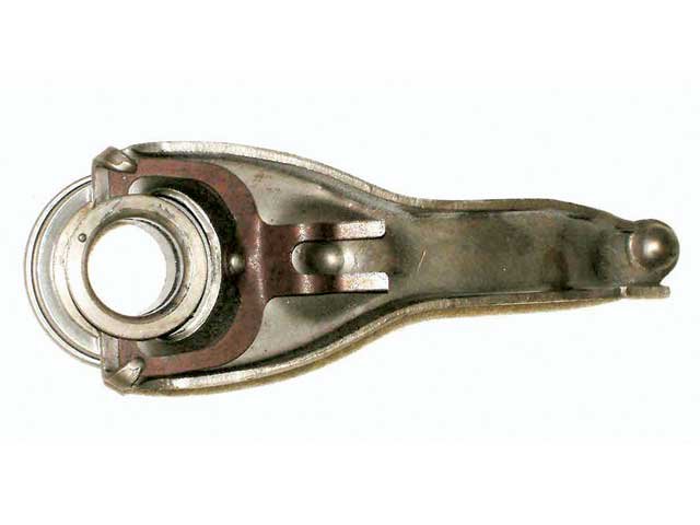

Miles Posted April 7, 2011 Share Posted April 7, 2011 (edited) Pictured below is the Camaro clutch fork and throwout bearing. Is this what you guys are using? Edited April 7, 2011 by Miles Quote Link to comment Share on other sites More sharing options...
kamikaZeS30 Posted April 7, 2011 Share Posted April 7, 2011 (edited) That is the one I have. Edit: Again, played with the clutch some more last night. It really feels like I'm only missing the last like 1/8" of engagement travel-- I just never quite get to the point where the pedal loses resistance because the clutch fully disengages before I hit the floor. Edited April 8, 2011 by kamikaZeS30 Quote Link to comment Share on other sites More sharing options...

GOTHALOSISM Posted April 13, 2011 Share Posted April 13, 2011 I too am going through this as well. There are 2 versions of the Camaro slave, the plastic one and the metal one. The metal one has an actual bleeder screw behind the hose line. I'm thinking of getting the "power bleeder" screws that have a check valve installed inside them so they are really easy to bleed. Quote Link to comment Share on other sites More sharing options...
Miles Posted April 13, 2011 Share Posted April 13, 2011 On 4/13/2011 at 2:25 AM, GOTHALOSISM said: I too am going through this as well. There are 2 versions of the Camaro slave, the plastic one and the metal one. The metal one has an actual bleeder screw behind the hose line. I'm thinking of getting the "power bleeder" screws that have a check valve installed inside them so they are really easy to bleed. The Napa Camaro slave is plastic. See picture of my previous post. There is a company that makes a metal version. I have used the Napa plastic version on two builds and never had a problem. The bleed screw is on top. Napa Camaro slave UP37821 $43.98 Quote Link to comment Share on other sites More sharing options...
