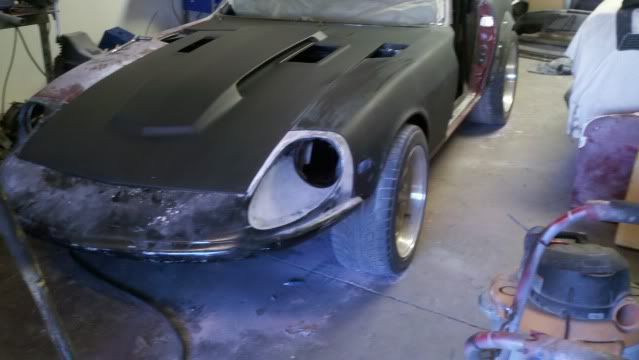

280zjoel Posted April 1, 2011 Share Posted April 1, 2011 Do you use any type of hood ducting to help pull air through? Lol, it looks like the red Fairlady Z has a honda strut bar for a core support. *EDIT* Interestingly, I just picked up an 88 or so RX7 TurboII. hahaha lol about the honda strut bar. I actually have two different hoods for the car. The First one was this: My new one is the Nissan Competition hood vent: I think this is definately going to be unique since I have never seen any Z with the competition hood vent and a G-nose front end. Quote Link to comment Share on other sites More sharing options...

Tony D Posted April 3, 2011 Share Posted April 3, 2011 I think this is definately going to be unique since I have never seen any Z with the competition hood vent and a G-nose front end. Red and black car with German Plates showed up at the 94 ZCON with just such a setup. Several others throughout the year. "Competition Hood Vent" is a nice marketing term---Nissan came up with it because they couldn't control vapor lock in street cars! LOL Quote Link to comment Share on other sites More sharing options...
