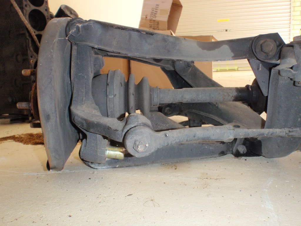

tec280zx Posted April 27, 2011 Author Share Posted April 27, 2011 Hey look what I got to fit on the s13 knuckle. Man I swear its like playing with legos sometimes! The caliper sits over the rotor perfectly. Still would need to center it with a couple washers though. Glad I didn't get rid of the z31 stuff. Btw, they are 87 vented rotors with matching calipers. I have no idea how i'll get the ebrake cables to work though... Quote Link to comment Share on other sites More sharing options...

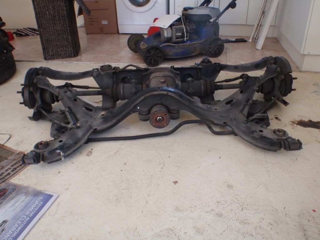

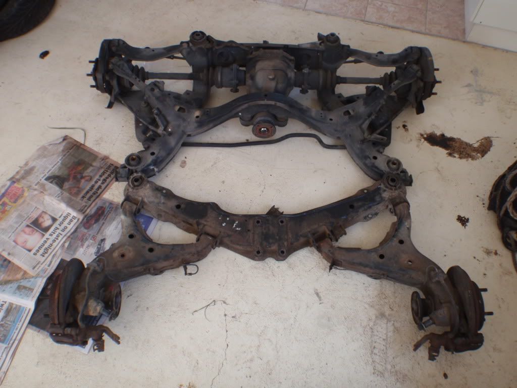

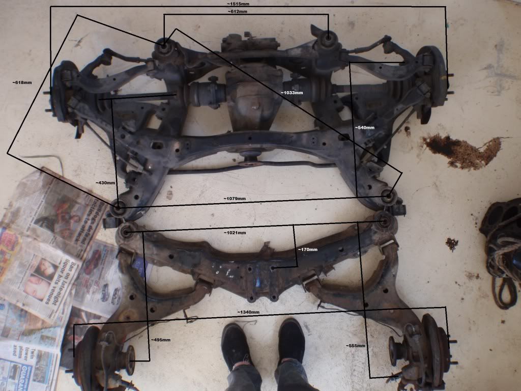

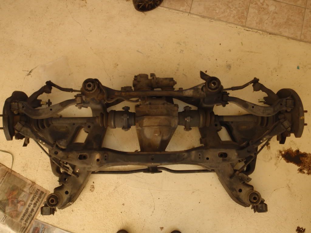

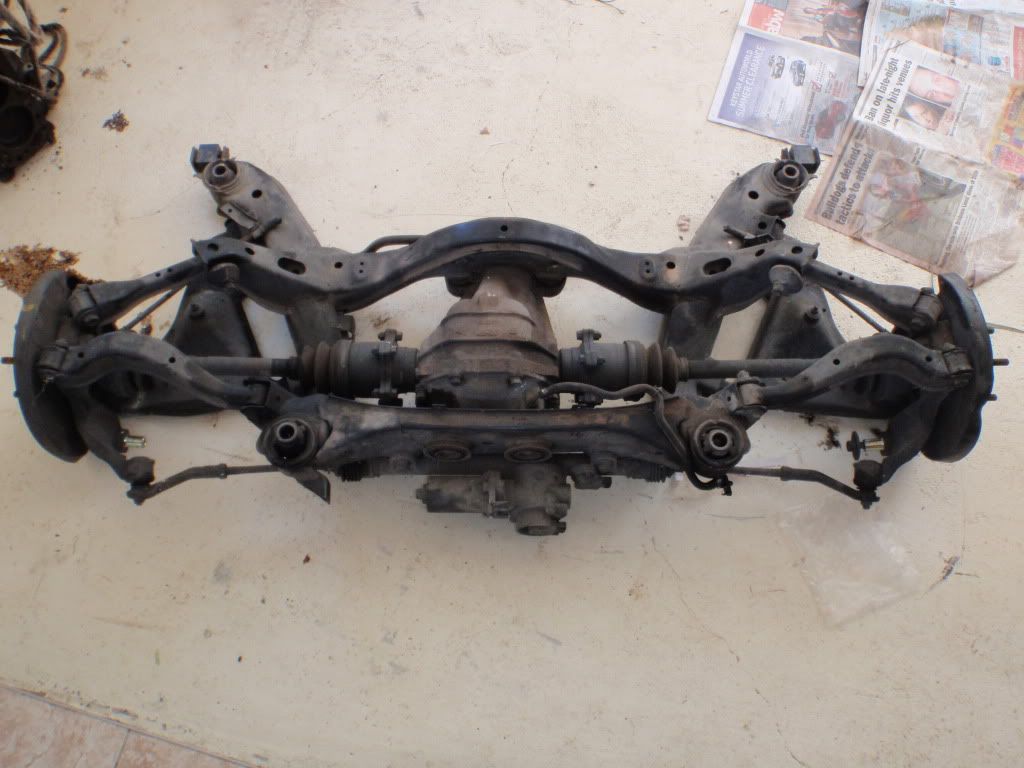

ovenfood Posted April 28, 2011 Share Posted April 28, 2011 (edited) Here is some pics I intend on displaying the measurements in a way that makes more sense but this will do for now :> http://s657.photobucket.com/albums/uu298/ovenfood/R33%20and%20S130%20rear%20cradle%20comparison/ Edited April 28, 2011 by ovenfood Quote Link to comment Share on other sites More sharing options...
ovenfood Posted April 28, 2011 Share Posted April 28, 2011 Now I compare the pictures there really are not that different. :\ Quote Link to comment Share on other sites More sharing options...
ovenfood Posted April 28, 2011 Share Posted April 28, 2011 Thats about as much as I can think of measuring. The only thing missing is the R200 long nose diff length. Measured with a tape measure and hopefully minimal parallax error. Quote Link to comment Share on other sites More sharing options...
tec280zx Posted April 28, 2011 Author Share Posted April 28, 2011 Nice pics, just realized you're in Australia, no wonder you got a r33 rear. Get rid of the hicas if you use that. One thing that doesn't make sense is the track width. The difference you're showing is 175mm which equals about 6.9 inches. Just eye ballin it doesn't look to be over 3 inches wider at each side. My s13 is about 3 inches wider total. Might make for some interesting wheel selection then. Quote Link to comment Share on other sites More sharing options...
