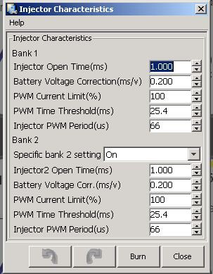

AtlantaZ Posted June 3, 2011 Author Share Posted June 3, 2011 Hah! Got it to idle again. The trick was to set up my injector characteristics to 100% current limit - even though they're low impedance injectors, for some reason only the high impedance injector settings work. Maybe I don't have the flyback circuit installed like I thought? It splutters when I throttle it again. Since there's a 1" gap currently between my turbo outlet and my downpipe, I can clearly see blue flames when I throttle up to 1500rpm - is this normal? I feathered the gas and got it up to 2500rpm, and got a backfire - which made for a smoky fireball in my engine bay. Pretty spectacular! Anybody else think my fuel might be a tad rich? Now that idles, I think I will install my wideband O2 sensor and see where my readings are at. Quote Link to comment Share on other sites More sharing options...

AtlantaZ Posted June 3, 2011 Author Share Posted June 3, 2011 I feel like the advance and fuel tables are rock solid, so I'm going to mess a bit with the injector settings. I think the O2 sensor will go a long way in helping me figure out exactly where the problem is. I will say that TunerStudio's "Output test" feature was really helpful in diagnosing the system. Using it, I was able to confirm that all six injectors were firing - which was one of my concern. Please feel free to ask me any questions! Quote Link to comment Share on other sites More sharing options...

AtlantaZ Posted June 5, 2011 Author Share Posted June 5, 2011 The engine seems to only want to run smooth when I set the Supra turbo injectors up with "high impedance" type injector settings in TunerStudio... but now they're burning hot to the touch. What's going on here? Quote Link to comment Share on other sites More sharing options...
