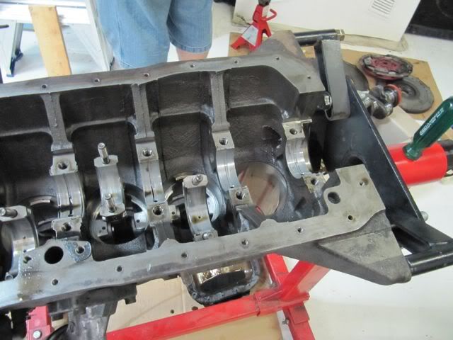

garvice Posted September 23, 2012 Author Share Posted September 23, 2012 I haven't had a chance to work on the Z much as it requires a bit of money. So being doing this instead (as well as work on the shed) http://the510realm.com/viewtopic.php?f=3&t=24424&p=203134#p203134 Quote Link to comment Share on other sites More sharing options...
