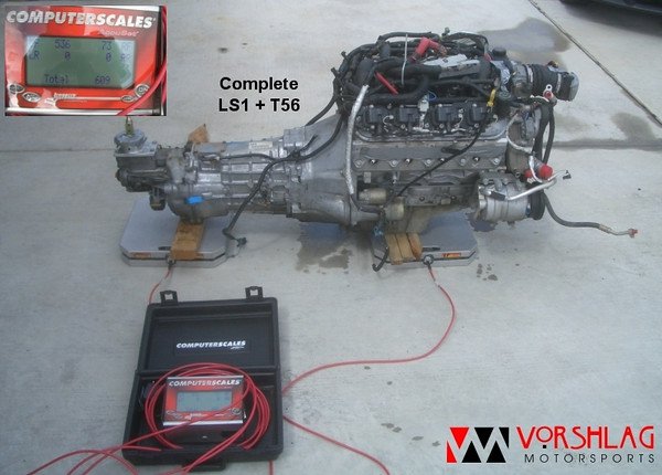

When I did the LS1/T56 conversion in my 280Z I replaced an L28 and a 5-spd and R200 from an '83 280ZX.  With the new LS1 and T56 with an LSD R200 out of an '87 turbo 300ZX the car gained a total of 30 lbs - all on the rear wheels.
To summarize - an LS1 with a T56 weighs 30 lbs more than an L28 with a 5-spd behind it.
