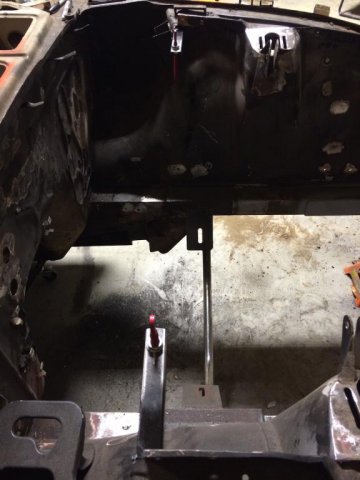

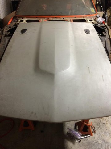

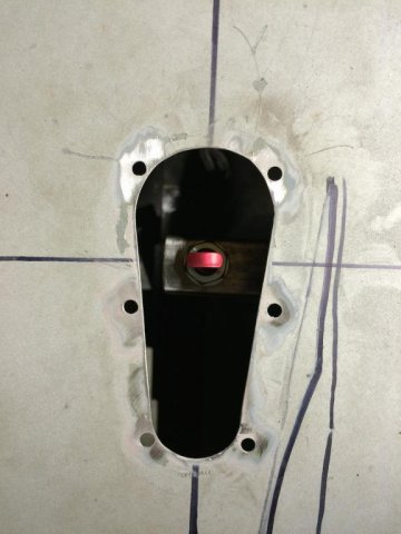

Aerocatch hood latches installed. This is with a stock steel hood and the post had to be a little more inward than I wanted but they will be out of the way. I was able to weld them in 3 different places so they are plenty strong. Really they do not support the weight of the hood, they only keep it down. I also have a cowl induction fiberglass hood I will fit as well that came on the car when I bought it (over 15 years ago).
