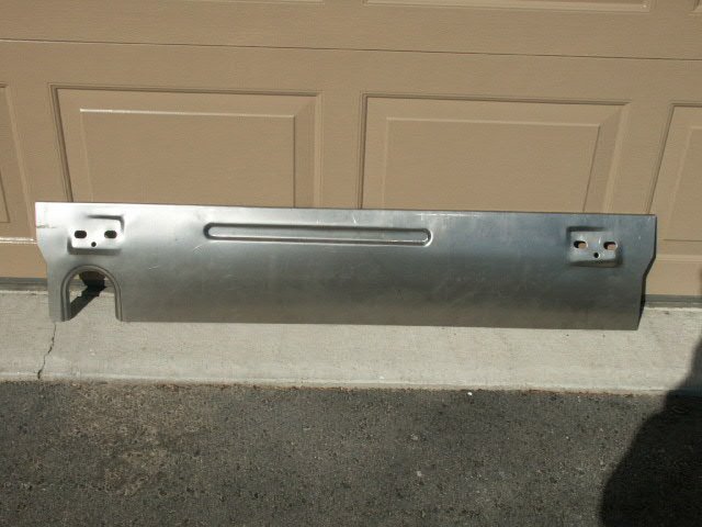

I agree with what Madkaw said. I've read on here that the rear panel available is apparently flat side to side, while the original is curved. No good. Your rear panel isn't that bad anyway. I would think a decent body guy could hammer that out, and custom make whatever is needed for the exhaust cutout.
Is blending the new paint with the old an option vs repainting the whole rear end? I wouldn't think it would be too hard with your color. But then again, I know nothing about painting.

Hard to tell if it's curved or not from the pic. I'll probably check with Charlie (business owner) and find out. But yeah, worst case scenario is that the existing panel is salvageable.
http://www.datsunzpa...m/products.html

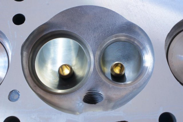

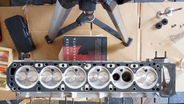

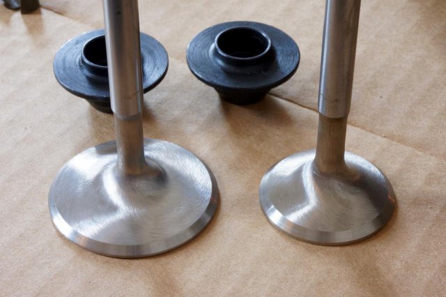

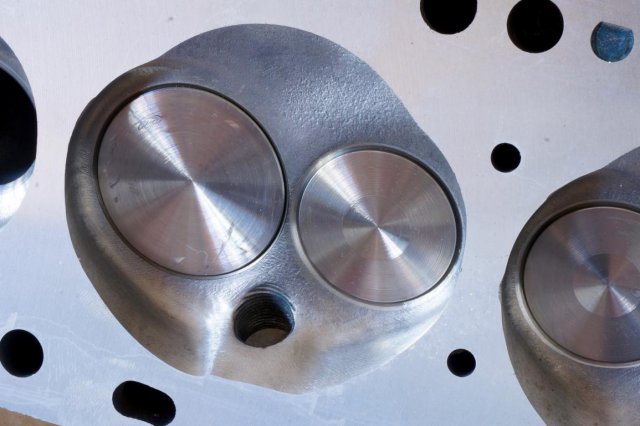

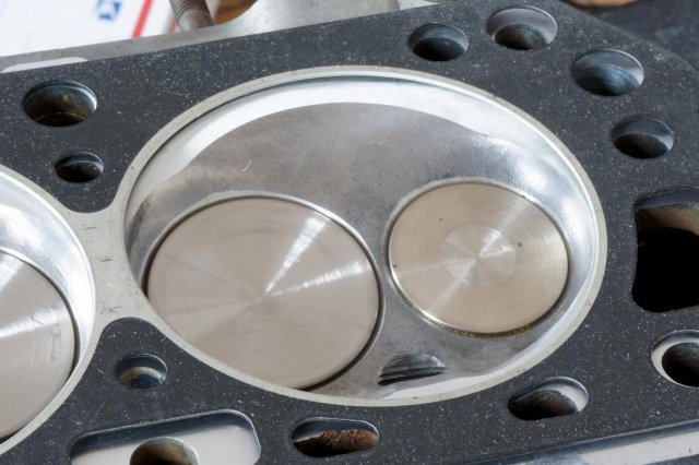

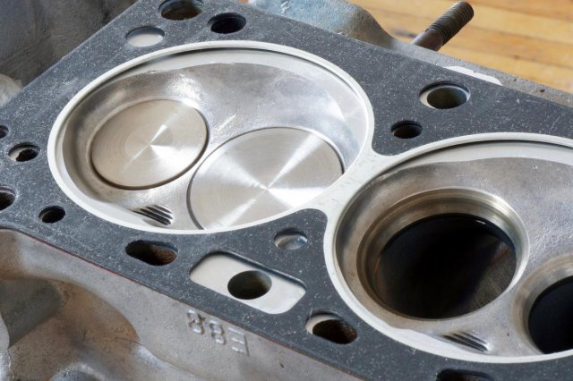

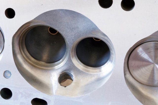

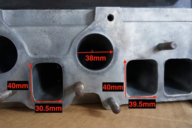

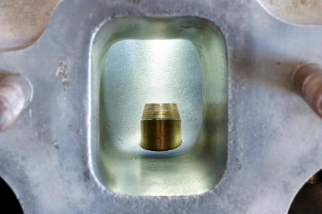

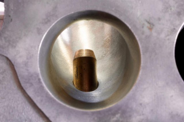

Got my E88 head back from the machine shop and the flow data isn't quite as good as I was hoping for, but it's still decent.
I had the shop flow test the ported E88 and also an unported E88 I happened to also have laying around. This way I could compare the numbers on the ported head against a (mostly) stock head. The unported E88 has been modified with the same L28 size valves as the ported head though, so it's flow figures are probably a bit above stock, which could potentially make the ported flow increase look a little smaller.
Keep in mind that the flow figures were measured at 25", so they will seem a bit lower than what you typically see, since most places measure at 28". At .550 it looks like a gain of 12% on the intake and 15% on the exhaust. Nothing huge.
I'm now torn between a few choices:
A] Call the ported E88 good enough, set it up with the new camshaft and run it. Sell the Whitehead Performance ported N42 that's on the engine right now.
B] Stick with the Whitehead Performance ported N42 that's on the engine right now and swap the new camshaft into it. Sell the E88.
C] Send one of my stock heads (or even the ported E88) to Slover's or Rebello and have them work their magic. Sell what I have to help fund this work.
My horsepower goals aren't crazy though, 225whp would be nice. Anything above that is a bonus. What I already have might be capable of that much.
Anyway, that's enough rambling for now... :P
The attached images are of the ported E88, its flow figures, and I threw in a couple showing a felpro L28 head gasket laying on it - looks like it's been opened up right out to the ring.

I'd stick with the N42.

Yeah, there is nothing to lose by at least seeing what the N42 is capable of. After all, I could always swap the cam, rocker arms and such over to another head if the N42 isn't cutting it.

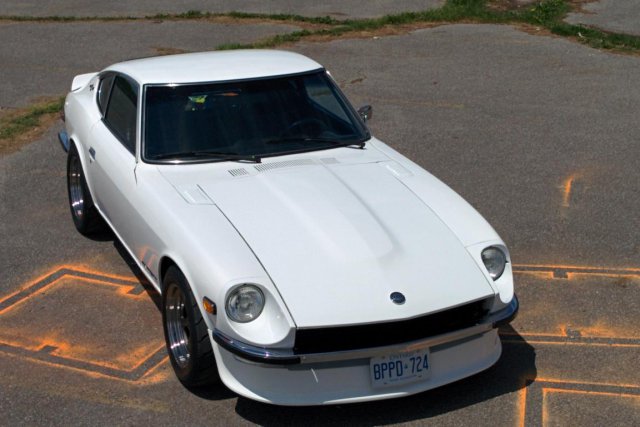

I really like your work so far, well done! Needs more pictures of the physical car though, gives you an excuse to take some :)

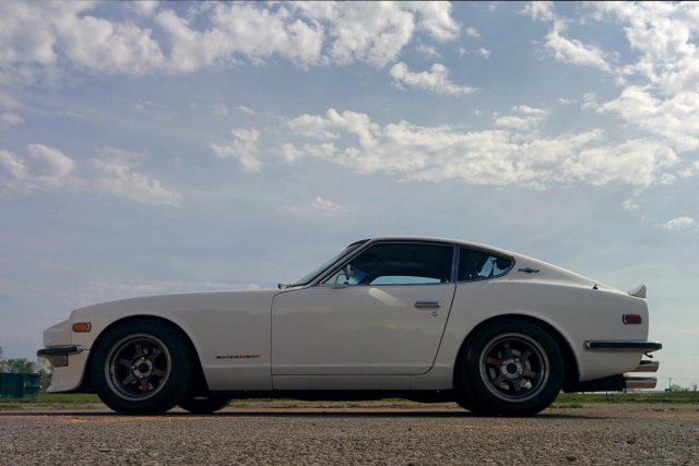

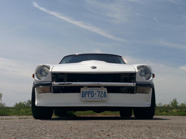

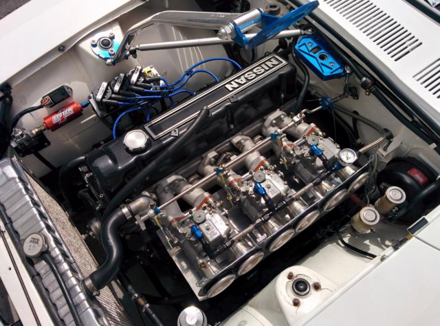

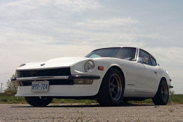

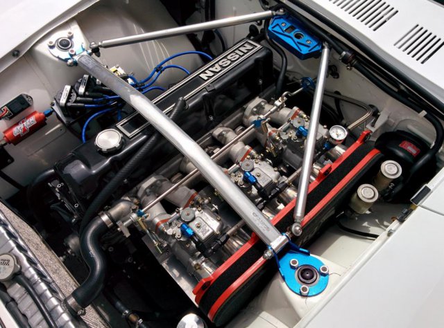

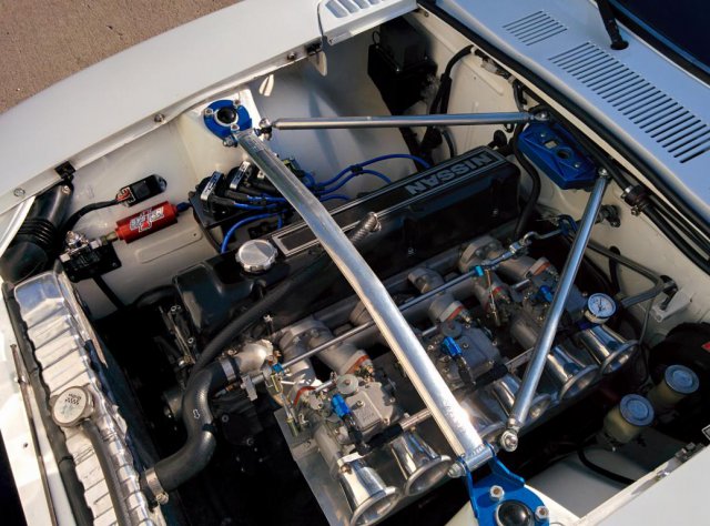

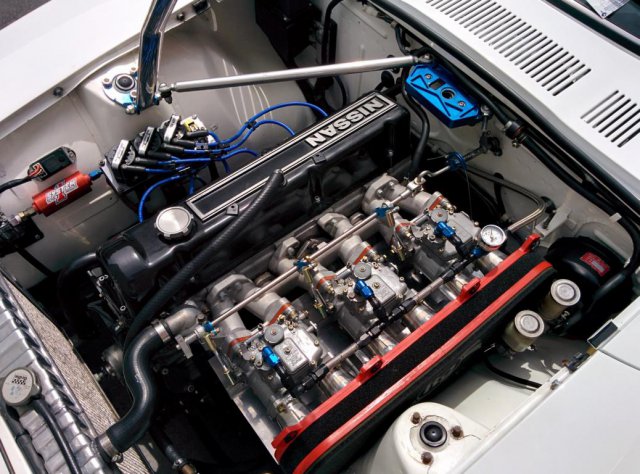

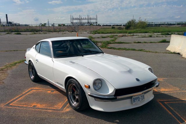

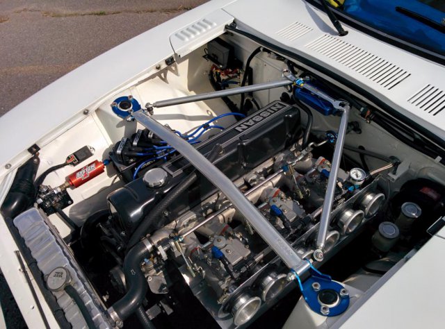

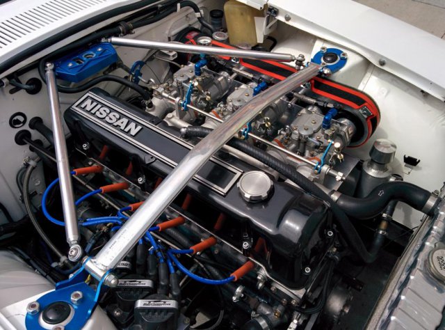

Thanks Jay - I take loads of pics, but just don't share them for some reason, haha. Here's a few I took last weekend. :D

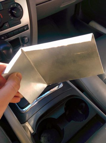

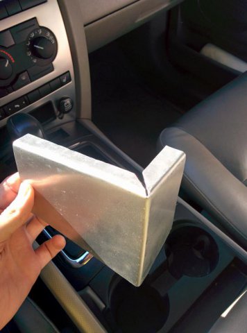

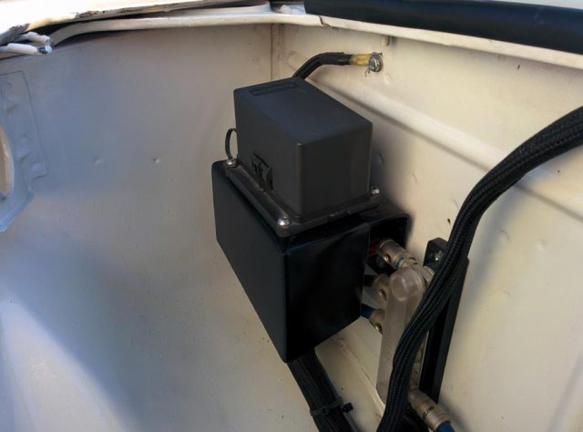

Got bored today and had a little free time, so I whipped up a simple shroud to cover the wiring underneath my fuse/relay box. I just used some spare aluminium sheet metal I had laying around, cutting to size and bending into shape on my coffee table, haha. Reckon it tidies up the look of the engine bay a little, so not bad for $0 and a half hour of time :)
Before, after, and some extra shots of the shroud.

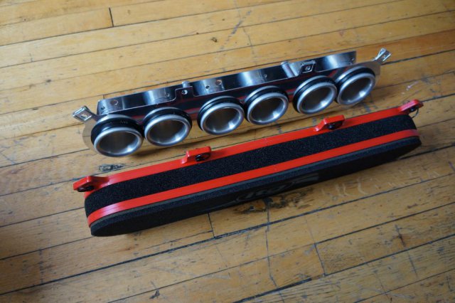

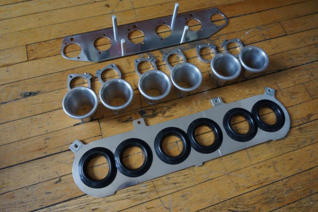

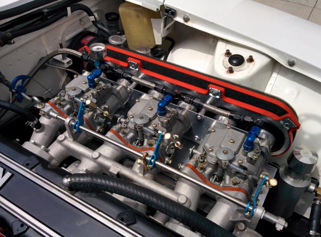

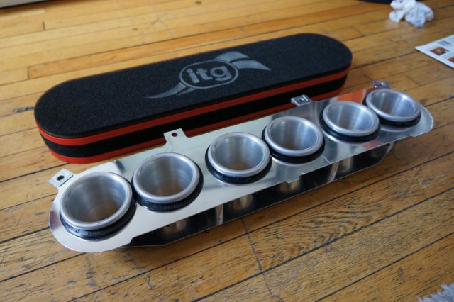

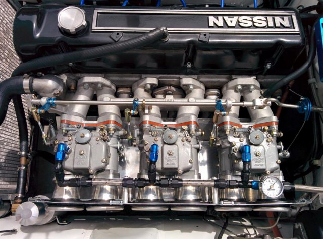

I wasn't entirely happy with how I had my triple carb air filter set up, so I reworked it today.
Issues with the old setup:
1] Filter was 65mm internal height, and thus too deep to remove from the car without also removing the air horns. PITA!
2] I wasn't cleaning it as often as needed due to the above.
3] It was mounted solely on grommets, which were secured to the air horns. It would often shimmy its way down the air horns and then I wouldn't have the proper clearance over the air horn mouth - ITG states an absolute minimum of 19mm.
I thought about ordering one of the carbon fibre "trumpet trays" from Reverie in the UK, but ultimately decided against it - too snug at the base where the air horns mount, I didn't want CF in my engine bay, and it hid the gorgeous air horns a little too much for my liking.
So it was do-it-yourself time again. My solution was to stick with the grommet mounting solution, but to develop it a bit further. I created an additional plate that mounts onto the carbs, onto which standoffs are attached. These standoffs in turn hold the ITG filter backplate 60mm from the carbs. The air horns are 75mm long, so the ITG backplate being held 60mm from the carbs means that only 15mm of the air horn protrudes into the air filter. I have switched from the 65mm internal height filter to the 40mm one, so this leaves me with 25mm clearance between the mouth of the air horns and the filter itself. That works!
The ITG backplate pushes against the standoffs with enough pressure to hold it quite rigid as well, so there is next to no movement of the filter, and zero chance of it shimmying down the air horns.
The additional materials are all aluminum as well, so the added weight was maybe 100g total.
With the shallower air filter I can now remove the filter in about 2 minutes, with most of the time required being the removal of the strut brace.
Not bad at all :)
