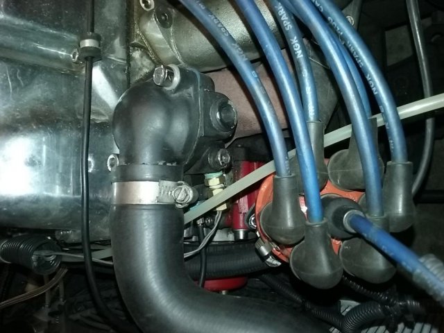

The thermostat does look suspect.  I had an old thermostat and it would do the same, even though it looked fine when tested in a pan of hot water on the stove.  No flow there though.  It allowed a wide range of temperature, about 170 to 190, and moved up and down with engine use and daily temperature.  Bought a new Nissan brand 180 degree unit and it's very steady now, hits the number quickly (actually about 185) and sits there.  Might rise 5 degrees on a hot day after some use.  Using an inexpensive parts store Murray brand radiator.  Stock NA engine.

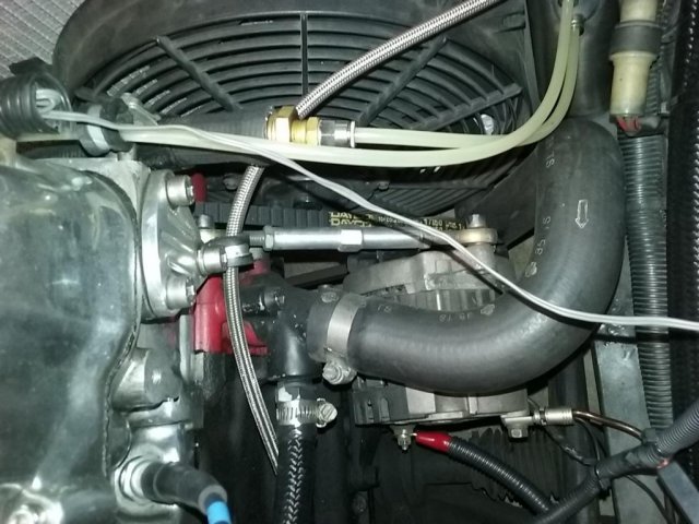

Here are some pix of my current coolant system. I dont have the t-stat bypass hose installed. From the reading here on HBZ I assume that I didnt need the t-stat bypass due to my heater core has no shut off valve like the stock factory system. I assume that this is not an issue?? maybe it is?? I get heat out from the core with-in 1 minute of start-up from being cold.
I will go buy another factory Nissan t-stat and install that later today just to see what happens. I can also install that small t-stat bypass hose just to see if that helps equalize the temps better. I will also get some new coolant and flush the system.

 I do not use the thermostat bypass hose setup as my heater core is free flowing I.E. it has no off valves. It flows from off the back of the head, thru the dash core, and then back
It's been documented that too much flow from the back of the head back to the pump inlet (the typical bypass that people do when they get a leak in the cabin) reduces overall cooling capacity.  It reduces flow through the head and thermostat and back to the radiator.  A short circuit, effectively reducing pump output.  You might try clamping your heater core line closed and seeing what happens.  Maybe your new core flows more than the stock system.  If it has an effect, you can restrict flow through the core to improve cooling but still have heat.
Now that is something I didnt take into consideration. I can go do some testing.
