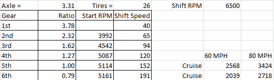

Impressive cruising RPMs!

That's the beauty if that transmission with an engine that has a good powerband, it's always in the power up to way past where it will go. If I could muster a 200mph run it would be right at peak HP for the Voodoo. Not sure if 500 wheel HP would pull that off though. It would be fun to try - once anyway on the flats.
We should put one of these 8.8 diffs in your car. What ratio are you looking for?

I've decided it's the only way to go for gear selection and strength.

Yup, the more I've looked at my options the better the 8.8 looks for strength, initial cost, replacement parts and gear selection

I'm all ears, 3.31 wouldn't be too bad with a CD009 and it's 3.79 first gear

Just as well build 2 mount setups as 1. I'll see if I can lock down the second diff, I can always sell it if it doesn't work out.
I don't think you would want much lower than that or you'll just spin. I'm concerned I might be too low with the 3.73 rear and 2.97 first. You would end up with this (not sure what your power band would be like, best shift point).

Yeah, I've went as far as to look at 3.08 gears

I don't dare go any lower in the rear and it is already starting to push economy at cruise. I don't think gearing will be a limitation on acceleration, should be traction limited even with sticky 295 tires. Top speed will be power limited with a teoetical of . 200mph would be at hp peak in 5th. The I am certain will be pushing it. Here we have several "legal" choices to use that speed. Salt flats are a few hours away. Road course at Miller Motorsportz Park about 1-1/2 hrs and the run outside Vegas as well as their track about 6hrs. I wouldn't mind just seeing what it will do at least once. Got to get it built first which is proving to be a very slow process.
