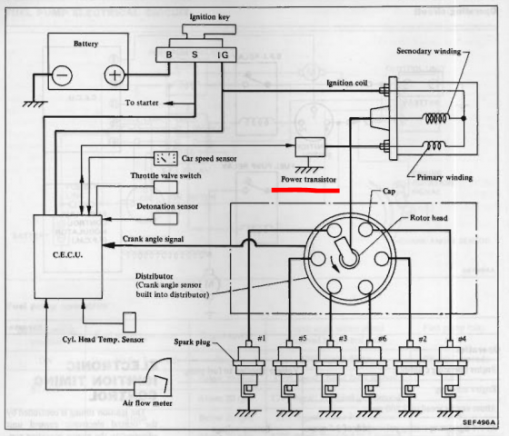

Rix diagram
I was thinking of trying this out and seeing if it works. This is using the 1978 280z ignition Module and the L28ET wiring and ECU(the car is a 78 280z with the L28ET swap from an 83). I am using the yellow signal wire to feed the 280z ignition Module instead of the red and green wires from the distributor that was used with the original set up. What do you think?

It might.  Seems like Red should be grounded though.  But Chickenman was right, the 77 is a low current system.  It still uses the ballast.  Considering that and the fact that it's 38 years old, the odds of rapid module failure are high.
Why not use the HEI module?  It seems to work.  http://www.zdriver.c...hevy-hei-27569/
Or use the same logic you just showed, identifying the trigger wire, on the PRW-2 module.  Just figure it out.  The Pahfinder wiring diagrams are on the nicoclub web site.

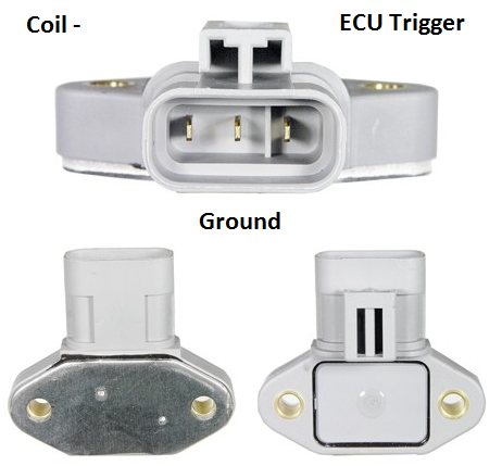

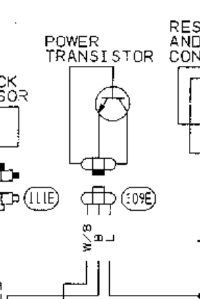

Here's a scheme that should work to use the PRW-2 in place of the ignitor.  Copied from the 1995 PF FSM, page EF&EC-8, and Rockauto.com.  The PRW-2 is about $60-100 on Rockauto, but only $25 plus at PicknPull.  About the cost of an HEI module.
No guarantees, I just followed the lines of the wiring diagram.
L = coil negative
W/B = ECU trigger
B = ground

Posted 22 August 2016 - 08:46 AM
I'm surprised the PRW-2 doesn't require a 12V wire like the HEI and the stock unit does. Hmm.

The coil/ignitor wiring is different in the early-to-mid 1990's Nissan's that used the PRW-2.   (true but not relevant)
From the Power Transistor wiring diagram above:
W/B = transistor "base" = trigger = input from ECU (Y/W on Ignitor "T" connector)
L = transistor "collector" = voltage input or source = (on L28ET Ignitor this would be the B/W +12V (battery voltage) @ IGN ON)   GND - The stock ignitor gets it's GND from the frame (coil bracket attached to fender...)
B = transistor "emitter" = signal out to coil = (same as L (blue) on L28ET ignitor -> "-" terminal on stock coil)
The difference (and confusion) in the wiring:  Power @ IGN ON in the later cars is delivered to the coil and then thru the coil to the Power Transistor collector.  (On the stock L28ET, it's the opposite - power @IGN ON goes first to the Ignitor, then from the Ignitor to the coil "+" terminal)  The output of the emitter is shown to go to the coil to trigger spark, but is also "tee'd" to a pin on the ECU that is tied to GND in the diagram.  I'm not smart enough to know why the tie to ground...  (again, not relevant...)

Posted 28 August 2016 - 03:24 PM
I don't know that the swap will work as I showed, but the ignitor is after the coil negative, with no positive feed, according to the 1983 wiring diagram.  So, not sure if you're mis-remembering the above.  I just compared diagrams, the 1983 diag. is Post #14 above.
The HEI is a "smart" module, which does current-limiting, aka dwell control.  Maybe the 12V feed is involved there.  Or the zero-crossing trigger circuitry, for use a VR sensor.  It has much more functionality than is used when it's wired up as a power "switch".  Overkill and just lucky, really, that it works.
