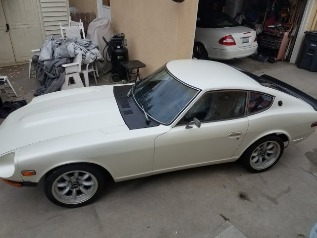

Here is the vinyl result.... get it... vinyl result :-)
Might keep the windshield wiper area black... its scary when you see all the spots were it needs to be cut!
Here is a picture of how we did the inlays from quarter panel to roof.
It turned out pretty damn good if I say so myself. I have learned a lot about this process as I went because there is not too much info about unibody cars. I would say that this is a pretty difficult job and very tedious. Details are important, missing a cut or making a mistake can make it look bad. We had mistakes, bumps, paint chips you name it, but the point of this was to get the car looking good for a couple years for cheap until I am ready to get the car painted.

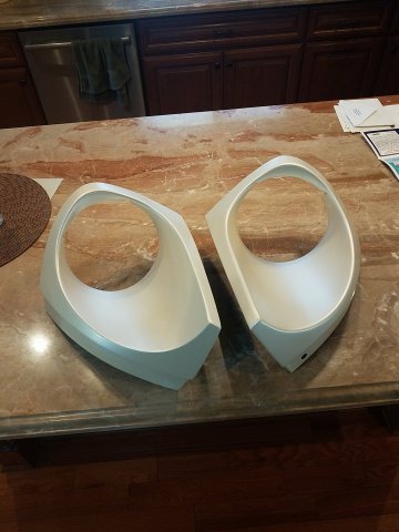

I ordered 50 feet but did not wrap the cowl or the front lower valiance. I still need to wrap the buckets and turn signals and am hopping I have enough. I would recommend 55 or more to be safe. I have almost no vinyl to spare. Also for testing purposes or if you make a mistake it would be good to have.

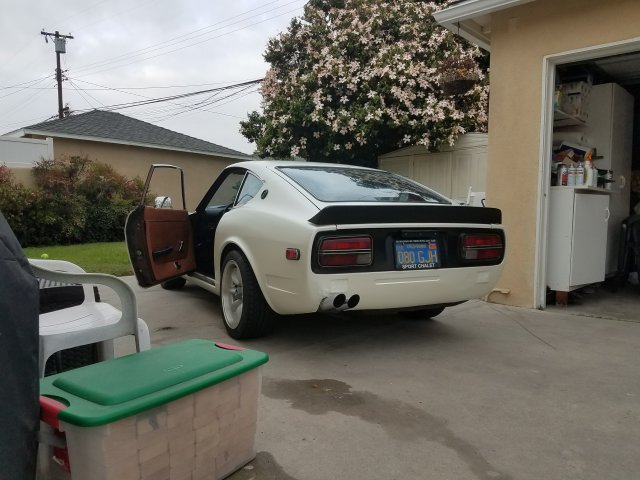

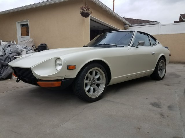

Anyways here the final results!!!
The hard part was taking off all the locks, windows, door handles, and finding the same bolts to put it back together.
