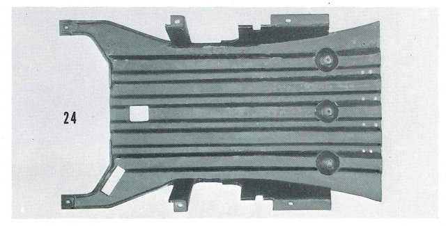

i have always wonders about this thing here
https://drive.google.com/file/d/0B_tGt5V5rGDVNzBNN2RYbVNYRFE/view
Item 24. its the racing under guard. Anybody has additional information about that one, or even measurements? Looks like a good idea for german autobahn ^^

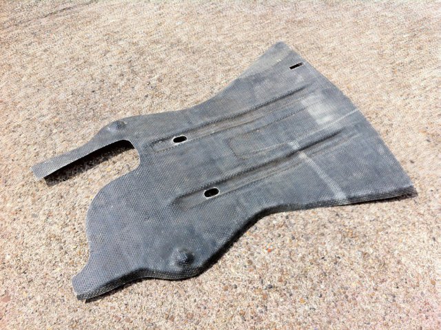

Rather obviously, the above photos show two different parts.
Top photo (that's my photo, I believe...) illustrates the 432-R type 'Undershield', part number 98200-E8700. This was essentially an aero-oriented part, and matches up with a dedicated FRP front apron unique to the 432-R model.
Bottom photo is the 99090-N3075 'Under Guard', which was aimed at rally use on L6-powered cars and mounts lower on the car (as rally car ride height was typically higher than stock). It was designed to be a protection-oriented part, rather than aero. Hence its relative thickness at 10mm in comparison to the 432-R's approx 1.5mm thick FRP Undershield.
