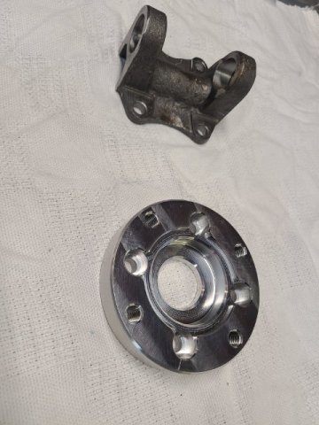

Got a few more things done last week. Made a driveshaft adapter to switch from the 1310 ujoint to a 1330 ujoint flange. now to order a custom driveshaft. The technotoys rear parts allow for some placement adjustment of the SN R200 so I made a spacer to slightly move it forward to align the axles better with the hubs. For some reason the diff itself is slightly crooked with their front mount so i'll be remaking that at some point but not a priority at the moment. havent ordered yet but got a good idea what seats im going to run so took some measurements and got the most of the cage tacked in. Harness bar height "should" be good but I wont fully weld anything until i have seats incase it needs to move up or down. - Today
