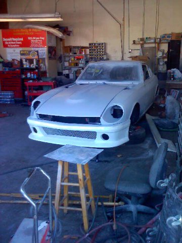

  12. Before and after, not done yet. I'll put up some new pics with the new coilovers and better stance.
