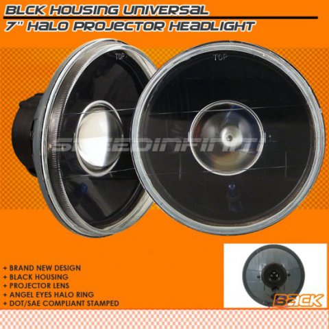

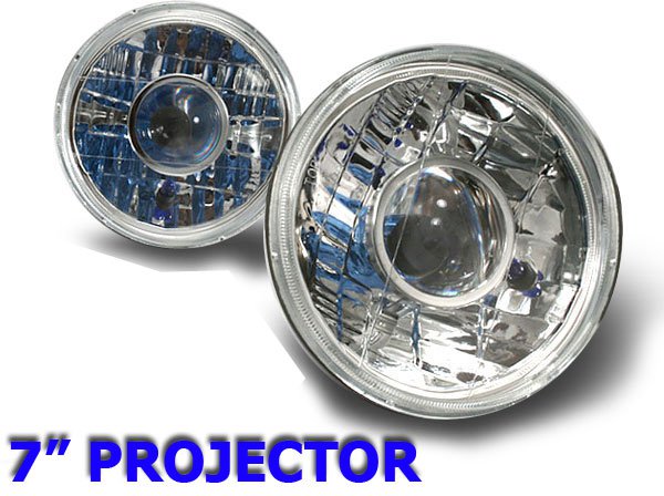

If the link works just look at what the offer for zcars. Looks like they have two types of 7"round housings and multiple ballast/bulb options. Sorry about the pics not working, not sure what I did wrong.
Here's a link to there main page: http://www.carhidkits.com/ They offer two types of housings the first pic attached comes with the 280zx kit and the secound with the 260z kit. So, what am I looking at? Are these just another cheep Ebay type Hid kit or are they an inexpensive ($140-$150) alternative? To good to be true usually is but theres video of them "testing" the durability of the ballasts by running over them with a car!
