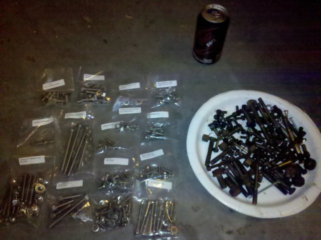

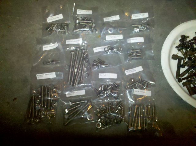

  21. Pop quiz: which bolts are the new ones, and which ones are the old ones? (Coke Zero sold separately) Here it is... $100 worth of stainless hex-head fasteners in 20 little baggies with labels! (My original post and the photo above referenced 14 bags, but I had set aside six additional bags for today's project). I'll be using some of these tomorrow when I bolt on the oil pump and timing cover, so I'll let you guys know if there are any problems with fitment. The good news with stainless steel bolts is that they are much more corrosion resistant (due to rusting or thermal fluctuation) than standard non-stainless steel. There are several good articles on the benefits of stainless vs. non-stainless, and the wikipedia article is actually pretty good too: http://en.wikipedia.org/wiki/Stainless_steel
  22. If you can wait until Monday, I'll take pictures and let you know exactly what the kit looks like. If the quality of their product is as high as I think it will be, we might see about adding them to one of the "parts sources" stickies.
