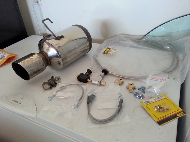

Thanks for the info guys. I ended up picking up a wilwood prop valve and now im tryin to figure out if I should keep the z32 handbrake I mounted for parking or should I cut it back out and put in a hydraulic line lock just to have a sleeker/ spacious look ok. Id have to cut into a widened transmission tunnel I did when I mounted the handbrake and narrow it down to the stock size because should I ever mount a passenger seat it would not likely fit. Has anyone ever heard of having a lot of negative issues with a line lock? How are the Jamar line locks for anyone who owns one?

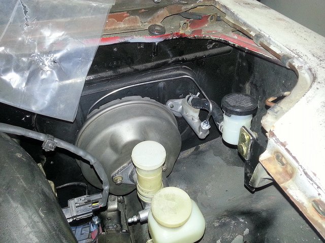

i forgot to mention I have a remanufactured 280zx booster and a 15/16 master cylinder. So I know i will have a large enough bore on the master cylinder and the 280zx booster should provide plenty of pedal feel and ease, but do you guys think all of the upgrades will do ok with the factory prop valve or should I upgrade to an adjustable one. I am low on cash and would like to just get away with using the stock valve.

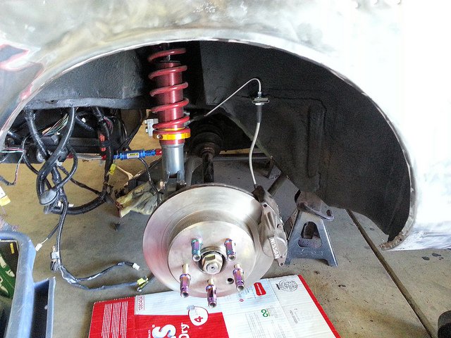

So I have recently upgraded my front brakes to the AZC Wilwood caliper/5 lug conversion and rear disc 94 300zx caliper. My question is that the car is a 1973 240z and has a factory prop valve mounted on the firewall and was just curious if the brake bias should be close to before. I am not able to drive the car because its in the process of getting new stainless hard line and new vq35de engine swap also. I just want to make sure before flaring and bending all the new line whether or not the stock prop valve would be good enough or should I delete the stock prop valve and install a wilwood adjustable prop valve in the cabin by splicing into the rear line. Any advice would be greatly appreciated.

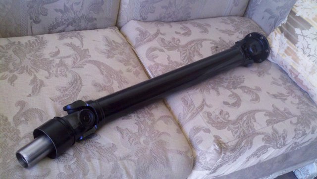

Hey ZTR, where did u go to get the 6 bolt flange that bolts to the r230 input companion flange? The flange im wondering connects to the u-joint on the driveshaft. Did a driveshaft shop order it for u? Where can I get one and how much? I also have the TTT high mount r230 conversion set up with moser axles. Im trying to get my vq35de powered 240z on the road and the driveshaft is my last piece I need. Any advice would be appreciated

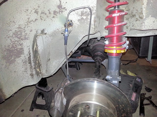

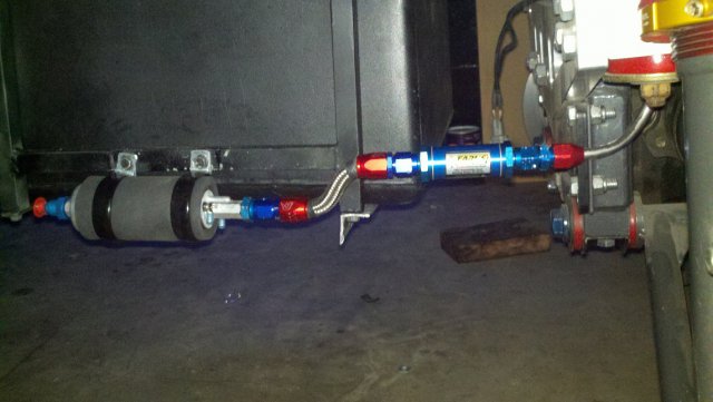

Im running stainless 3/8 line also and I ended up using AN to hardline adapters from jegs. They are like 6-10 bucks or something. I have a link to my flickr acct that shows the picture http://m.flickr.com/#/photos/39553792@N02/7110142317/
Sorry the pics didn't show, I had my flickr setting to private. I just set it to public and I have a few other pics of my vq35de swapped 240z.

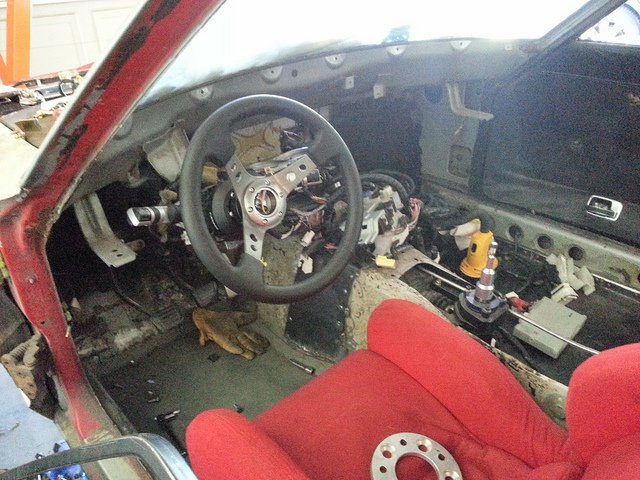

Just wanted to share a pic of my seats I mounted. I had to fab up some mounts to get ev erything secure. http://m.flickr.com/photos/39553792@N02/6858673160/

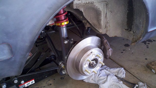

94 300zx calipers mounted on 73z
yem73z replied to yem73z's topic in Brakes, Wheels, Suspension and Chassis

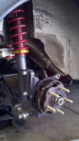

Yeah, the swap was really time/energy consuming. I had to track down/order the hub, studs, ebrake cables, calipers, bolts for calipers, axle nut size 36mm, rotors etc....so definitely time consuming. I would suggest if you could get the whole entire complete rear knuckle from the 300zx the better. -
Just wanted to share some progess photos of my 5 lug swap and rear disc brake set up with everyone...The car is a 1973 240z with techno toy tuning rear r230 swap with 5 lug conversion using the 94 300zx wheel hub, caliper, and some ichiba extended studs. I managed to also mount the stock ebrake cables along with the inner shoes for parking/or power sliding(giggle) purposes....
