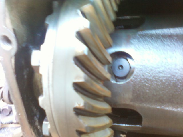

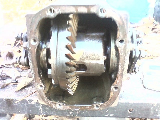

That's good to know, johnc. Any idea what Nissan it came in? Sorry for the poor phone pics.
I just picked up this CLSD 3.9 diff with bolt in stub axles and I plan to use it in my 72 turbo 240Z. It's a 2 pinion R180...I think...not very experienced with diffs but that's what my eye tells me. Will be in a street car w/ minimal autocrossing so, it should hold up. Would this be OEM from something else (and what) or is it a Nismo...how can I tell?
