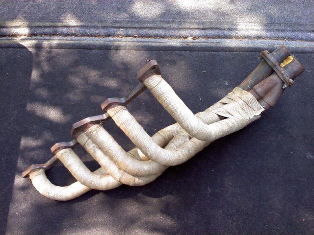

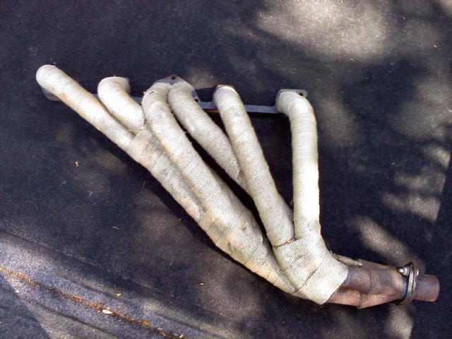

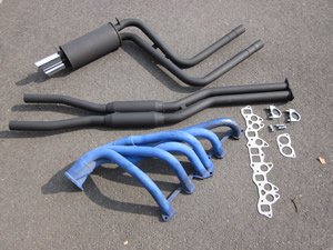

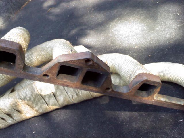

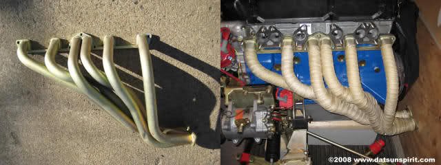

I found an image of a header like mine...it came from another thread here josh817 started last year, discussing Japanese N/A 400hp L6's. This image is supposed to be from the DatsunSpirit 240Z. I measured the tubes and they match the listed specs (42mm pri. and 52mm sec.) and the design appears to be identical. I also found it listed on datsunspirit.com It may be a Japanese market part...makes me want to build an N/A motor around the header

Any thoughts on what I have. It looks like a good quality header...5/8" flange, approx. 1-3/4" tubes. Twin 2" bolt-on outlet flange...Thanks!!

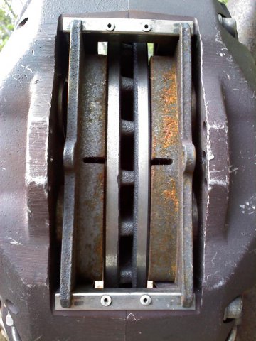

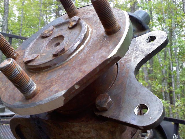

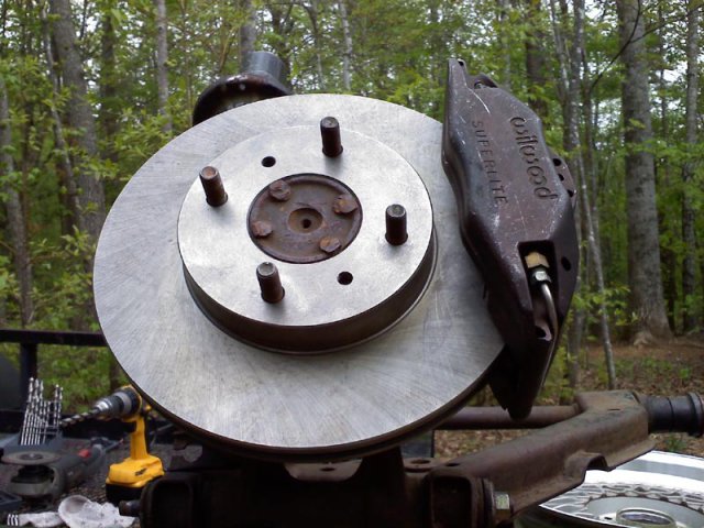

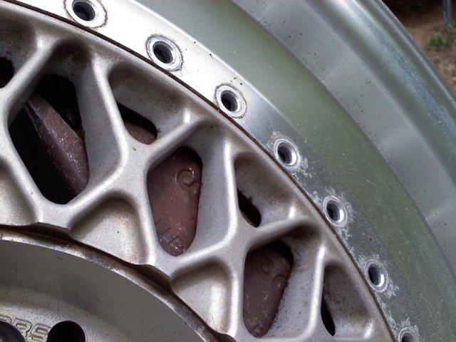

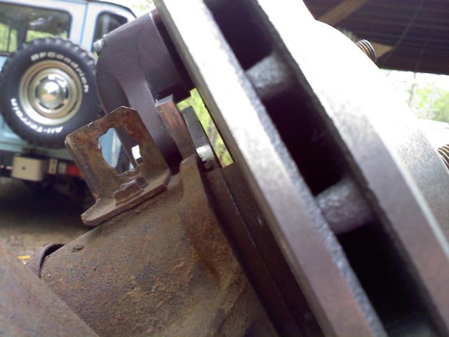

Here are some pics of the rear Wilwoods/Maxima vented rotors... Removed just enough from hub face diameter to clear inside of rotor hat area. This shows the mock-up of the 1/4" steel caliper bracket and 3/8" aluminum spacer...I still have to finish off the spacer. Also, a shameless plug for my FJ40 . Centering over rotor works well with this setup. These are the BBS's I'll be using. They need refinishing as well as so many other parts . Wheel clearances are all good. I didn't have to do anything to the rotors or calipers...they should drop right in place now. We'll see...this is all new to me and I'm on a serious learning curve. -

Good news and FYI. I found a set of '85 front Maxima vented rotors will work perfectly for my rear 4 piston Wilwood upgrade. Had to reduce the diameter of the hub face slightly...now the rotors fit as well as centering tightly over the hub center. -
