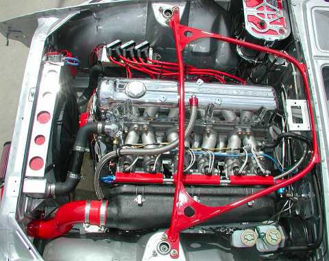

I was looking at an intake for my triple DCOE set-up and noticed it had no balance tube (this one is a spare). Instead of a balance tube someone put in air fittings on each runner and created an odd set-up with hoses attached to a tube that sits on top. It seems it originally came with no balance tube. Under what circumstances (i.e. racing?) would you run a set of triple Webers without a balance tube? Are there any advantages to no having a balance tube?
Thanks for the feedback. I'm surprised that people have been able to run DCOE's with a mechanical fuel pump. I think we'll keep the mechanical pump, our fuel regulator, and add the electric pump near the fuel tank. I have a pump block plate, so I may remove it at some point in future.
In reading up on DCOEs there doesn't seem to be a solid consensus on whether one should keep the mechanical fuel pump in conjunction with the low-pressure high-volume electric fuel pump. People with triple DCOEs on Jags tend to keep them. Any opinions (one way or the other)? The only agreement was 3 PSI for the pressure and ensuring one had sufficient fuel flow.
I have two options with fuel delivery for my Weber 42 DCOE's. First option is a 1 into 3 fuel block that feeds three individual fuel lines to the DCOEs. The second option is a pass through fuel line configuration that goes into the first DCOE, then to the second, and then the third. This second (pass-through / daisy-chain) approach allows for use of the OEM return fuel line. Which set-up is recommended? I looked at JDM 240Z 432 OER triple carb set-ups and they used the pass-through configuration. I then looked at some racing configurations and they all used the fuel block approach.

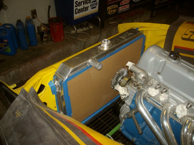

We'd like to add a fan shroud to this 240Z with an aluminum radiator. Anyone else make one they'd like to share?

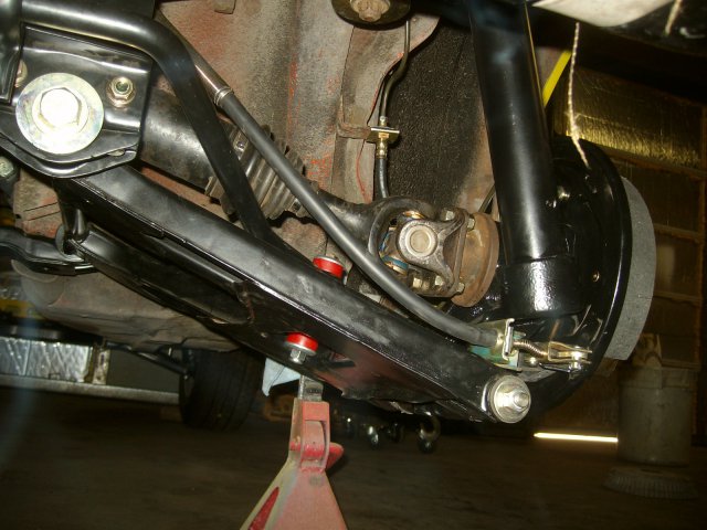

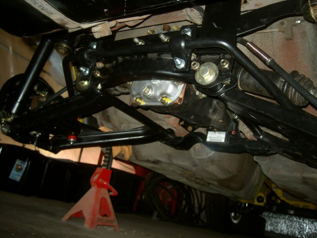

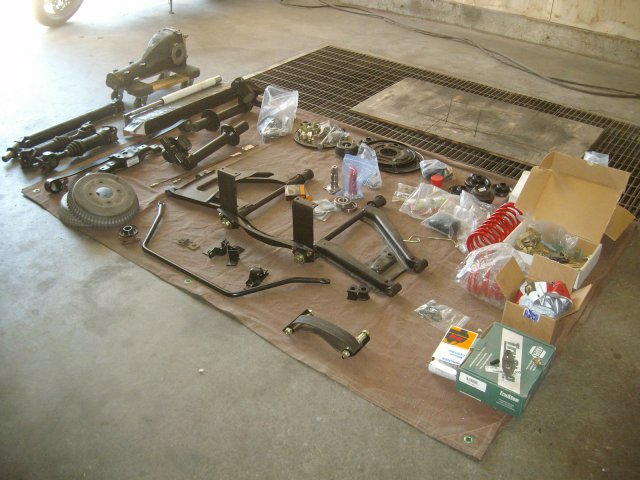

We ended up going with John Coffey's R180 STi conversion. Suspension components were powdercoated, hardware was bead blasted and then zinc plated. Energy Suspension bushings were used. All bearings / seals were replaced. Half shafts were rebuilt and balanced. We went with Tokico Illumina 5-way struts and 200 lbs/in linear rate springs in back. The R180 installation was simple with no issues.
