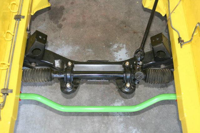

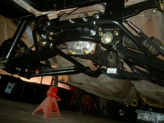

If you're going for a pure track/race car then paint the chassis white and paint the suspension pieces black. If you're going for a street car, then I think powdercoating is appropriate. I've done two and swear by the powdercoating approach. Check around for prices. I got an entire suspension (really more like 1.5) for under $200 including sand blasting. I went with a satin black. It's common for some shops to do poor masking jobs and they'll sometimes powdercoat various holes. Doing the blasting of the pieces yourself allows you to work with them in masking. I did this one some critical pieces (like the struts). The bigger industrial shops are the cheapest, but will sometimes have limited patience for the one-off restoration job. If you go with a common color, like satin black, they'll sometimes waive the set-up fee because they'll add you to an existing job. That's what mine did. If you're in Denver, it's called Roadrunner Fabrication. Here are two more shots of one of my powdercoated suspensions. There are some pieces, like the steering rod and rack that you can't or shouldn't powdercoat. For those I used the Eastwood chassis black paint. I have a bead blasting cabinet and use that to prep all metal pieces prior to painting. -

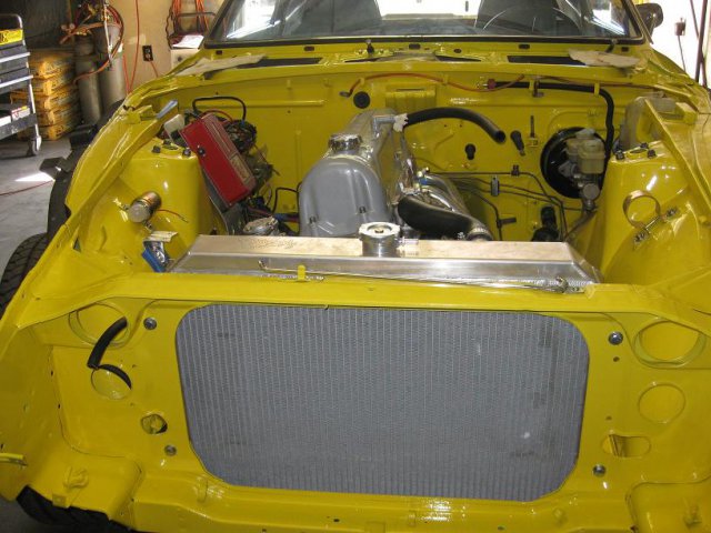

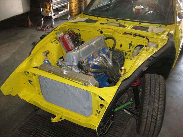

I got the 240Z radiator from Wizard Cooling (there was a link earlier). When I got the product a few years back there weren't that many alternatives *like the sub $200 ones on eBay*. The quality of the radiator from Wizard is good and unlike generic radiators, the tubes to connect up to my OEM radiator hoses were spot on. Also, it didn't hang low like a 280Z radiator. They'll also make a custom fan shroud for a reasonable price. Here's the radiator installed on my 240Z We've had no cooling issues, but it hasn't been all that warm since we've been testing the car.

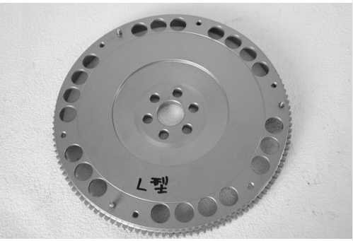

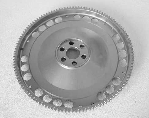

Tony, the pictured one is likely a knock-off of Tomei or Kameari. I pulled that picture from their eBay listing. I have no idea what 'Sideway original' means. Made in Japan: Sideway original light weight billet flywheel FOR A NISSAN/DATSUN 240Z, 280Z. Engine type: L20, L24, L28 weight: 4.2kg Those parts are racing or track use only. professional installation is highly recommended. have you heard of this 'Sideway' company? On mine ... likely heavier than it could have been, but it's around 16lbs. I weighed it on my bathroom scale once, but I'd have to dig out that number. Not exactly accurate. Works fine in my car. Given my 'granny shifts' it's likely appropriate for me. I noticed no issues with shifting. I do notice it rev's easier, but the car has had so many modifications, it's hard to attribute the free revving to just the flywheel ... likely a combination of things.

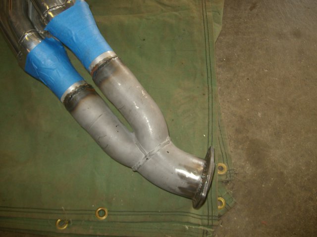

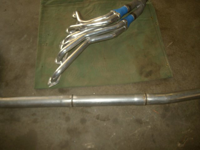

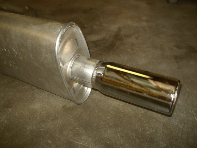

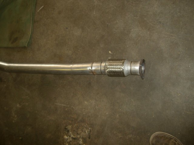

Not sure if people want more detailed pictures of the exhaust work. This shows the flex coupling and the TIG work on the MSA pieces We TIG'ed the chrome tip to the exhaust muffler We took the collector and then added the flange Shows some TIG work and the coated headers from MSA I know the MSA 'kit' comes with some nice clamps, but I wanted it TIG welded and as I said, my fabricator does nice work with the TIG unit.
There's this one on ebay that weighs just under 10 lbs Cost is about $379 because of shipping from Japan. Looks cool. Interesting when you compare it to mine above. Not much metal left on the one from Japan.
