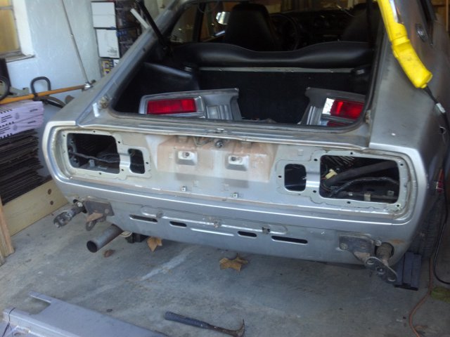

  5. I installed 1965 Mustang Tail Lights onto my daughter's 76 280Z. I removed the stock tail lights, surrounds, and license plate holder first: I then used 1/2" foam insulation sheet and laid out the tail light surrounds and license plate holder on the sheet in their mounted positions tracing the general shape into the foam. I cut out the template and shaped it to fit into the rear end: I measured center and spaced the Mustang tail lights properly and then test fit the Mustang parts in place: Once I was happy with the test fit and template design, I took the template to my local machine shop and for a very reasonable cost they cut my template out of 18 gauge steel. I spot welded the new plate in place and the car went into paint earlier this week. Sorry forgot to take photos of the spot welded piece. Will stop by tomorrow morning and take a pic or two and post it after the plate is fully welded and finished. Once back from paint I'll finish the re-wiring of the tail lights since the Mustang uses a single combination bulb instead of multiple bulbs and I'll relocate the backup lights to the MSA Rear Skirt opening using LEDs.

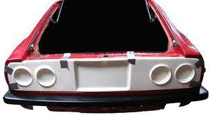

  7. Thanks, work in progress! My daughter's 16th birthday present. Yes, she picked it out and requested the Mustang tail lights. ZForce sells a fiberglass replacement panel that will fit any 4-4.5" round lights. That means it should take anything from a 68 Stingray Bubble lights to 76 I think it is? C4 or C5 models? Whatever you choose to do, give it your own little twist! Makes it kinda of special even if inspired by someone else's mod! Good Luck!

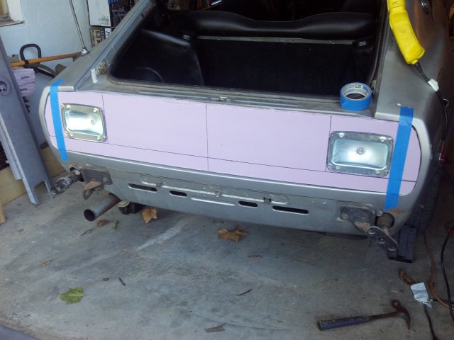

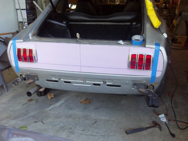

  8. Like the idea of the newer Camaro lights as well. My first love was to install a set of 65-66 Mustang lights so I started by buying a set a reprod tail lights and then created a template out of foam insulation. Test fitted the lights and they look great, see pics. Now I have a friend with a metal shop cutting a 16 gauge replacement panel with his plasma system. I had him not cut the tail light holes out so we can use the original as a template. Might consider selling the blank replacement panel so anyone can install any lights you want. What do you think? Cost would be around $80-$90 per panel plus shipping. Easier for my friend to cut five panels at a time out of one sheet of metal.
