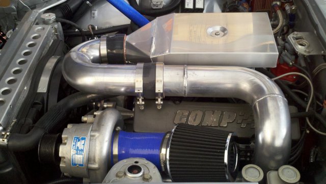

Emerald, I did redrilled the stock steel bracket and made some new standoff's out of some aluminum round heavy walled tubing stock. FYI the carb hat is a spectre part. but I fear that it's too thin for blower use. I have to try to copy it out of thicker 1/8 to 3/16 stock. The Carb hat is only 2 1/4 inches tall. I had just shy of 1 inch clearence under the hood. -
Gen 1 chevy centrifugal setups
fastzcars replied to emeraldlion's topic in Gen I & II Chevy V8 Tech Board
Just a last update on the Supercharger install. It was alot of work, but I got it to al fit under the hood folks! I'll be hooking up a meth injection setup in a couple of weeks and start the tuning process after that. wish me luck guys! -

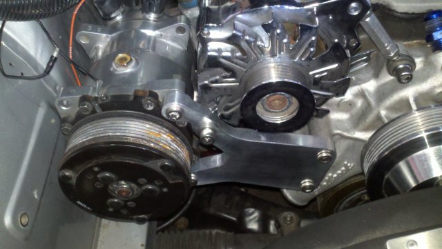

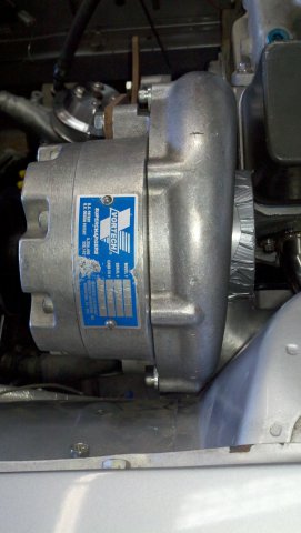

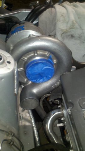

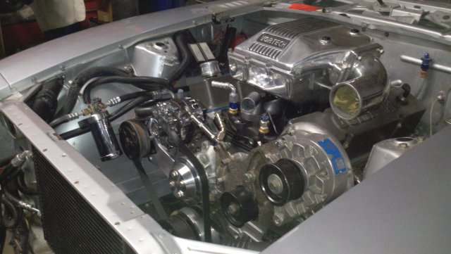

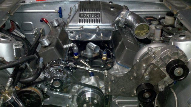

Hi Emeraldlion, I'm in the process of installing a Vortech V1-T trim SC on my 383 first gen block. Im using an older universal carb kit for the SBC that I bought from a friend. I had to make a new alternator and A/C bracket to relocate the a/c from the driver side to the passenger side. As well as modify the bracket by drilling new mounting holes to lower the SC and rotate/reclock the supercharge outlet from the top to the bottom to clear the inner wheel well. I'm still in the fabrication stage of plumbing the carb to the SC. Im finding it difficult to fit everything under the hood. I'll be changing and or modifying the carb box to try to get it to fit. I've included some pictures. -

No kinding bjhines! This Vortech has fought me every step of the way NOT to be installed !!! I had to fabricate and or modify every bracket thus far. It's like building the car all over again. But hey thats hot rodding! Right? -
Looking for machine drawings of Chevy heads
fastzcars replied to fastzcars's topic in Gen I & II Chevy V8 Tech Board
Just an update guys! I installed the SC and I am waiting for the 10 rib serpentine belt to come in. Now I'm trying to figure out how to get the huge Vortech carb box to fit under the hood? Any ideas? -

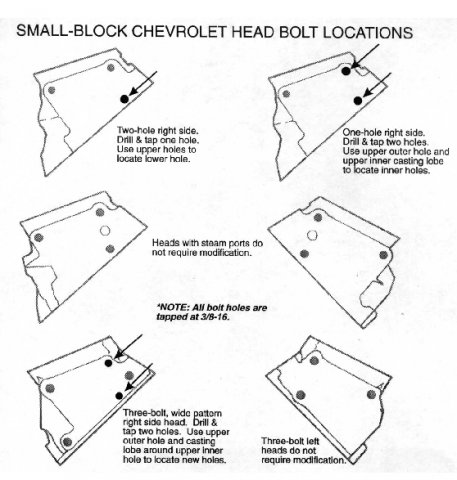

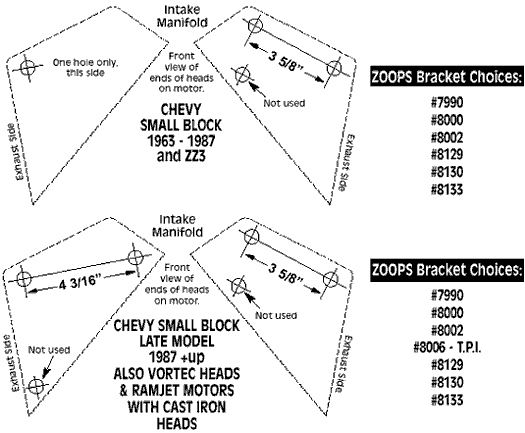

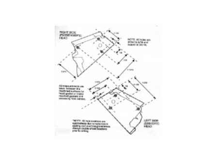

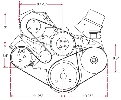

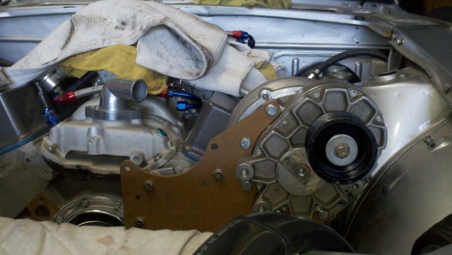

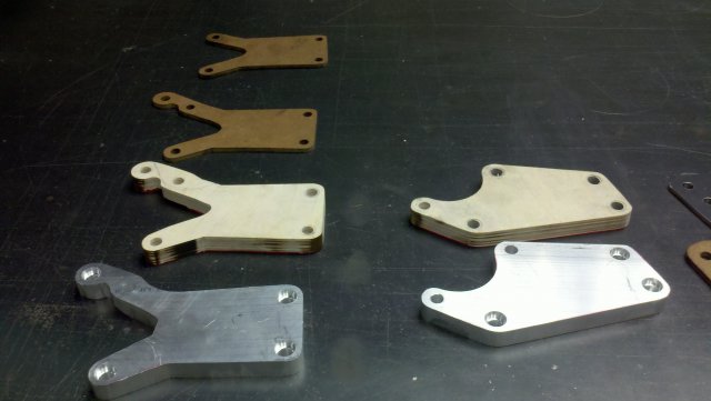

well guys after looking through the web for 2 days straight i finally found just 3 pictures of the bolt holes that I was looking for! I can't believe that the SBC been in production since 55 and I could only find 3 pix? Well here they are just in case someone needs this info later. The march diagram is kind of what I want to do, but the A/C is too low and will hit the passenger frame rail and the motor JTR motormount. So I need to mount the A/C higher up , almost to the same height as the alternator. the last pic is my pattern for the Vortech supercharger. wish me luck guys! -
Hello gents! hopefully you guys can help me. I'm in the process of installing a vortech supercharger and I want to make an Air con/alternator bracket for the passenger side. I tried the cardboard and hammer method but the accuracy is not that great. I looked on the web and couldn't find any machine drawings of the accessory bolt holes for the SBC heads! does anyone know where I can find some? Thanks!!!
