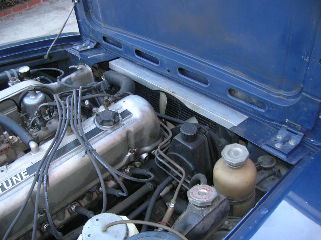

OK, I MAY have defeated the exhaust leak: cast iron exhaust manifold to down pipe. Finally figured out that the cast iron manifold surface was way not flat. I had to saw off the last original stud and helicoil for it. Got it all back together today and my word,. it is much quieter. Now, I am bothered (well, have long been bothered) by the whirring of the fan hanging on the water pump. It has a centrifugal clutch. It should resist spinning at low rpm. But the whole rig whirs painfully. Question: is the fact that I have no shroud around the fan makes it more noisy? If I was to construct a proper shroud around it, would it be a lot quieter? Remember: this is not a z that this is in, but rather a Triumph Stag.

My 8" Makita belt sander is doing wonders. The whole surface is shiny. And it is much flatter than it was. As I wrote earlier, the web between the two pipes was distinctly proud of the two outer points. I'm getting there. What I am not going to do is load up some crazy coarse paper on the sander and wade in. I prefer the control of 80 grit, even if it means that I will end up burning thru ten belts. The belts are cheap compared to the manifold. I might take it back tomorrow to Morse and see if they will give it a spin against their machine, now that I have got it much closer. As for the ZX Turbo, I'll save my pennies and get back to you. If you see a silly good deal, just go get it. If I can't afford it, someone in the community will take it off you, yes? Or you will just build another motor for fun. Yes, the oil pump has the virtue of being replaceable without tearing the whole engine out of the car..... -

So, nothing is for nothing. When the muffler shop owner handed it to his guy, the guy took it to a huge spinning sanding disk and buffed it a little, then declared it so distorted that it was going to take at least one disc to flatten it and that he'd need to charge me $60 to do it. Back to my garage and out with the large belt sander. I used some relatively (considering how hard the cast iron is) fine paper (80 grit) in order that I not remove too much material too rapidly. Also I used a large magic marker to blacken the surface as I got closer to being even and flat. It was radically out of flat, with the web between the two exhaust ports being very much higher than the outer edges. I am on my fourth belt and have just about got the two circumferences close to flat all across, although the outer edge of the two outer ears are still back a bit from the ideal line. At some point I need to call it good and put it all back together. If you ever need to get a cast manifold off a SU equipped L6 in an hour, I'm your man. I dread putting it together yet again and having it leak, but I also do not intend it to sit in the garage unused for days on end. -

I'm talking about a few thousands of an inch. The flange is less than three inches across. The drop pipe is about two feet long. Six thousandths translates to .050th at the rear tip or there abouts. Which can help. A slight difference like that will be OK at the studs, which will flex over a thou or two at the end of the torquing, and all will be flat. -
