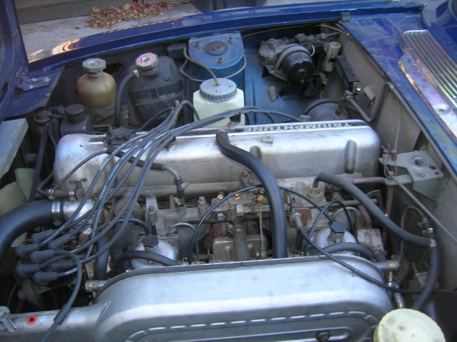

Anybody want to buy a Triumph Stag with a L6 in it? I have about 12k and 17 years into it. A decent six-pack might just get it from me. I have just about got the new throttle bodies tuned up, including getting the chokes to operate in sync. It was running like a dream. Smooth and real power. New acceleration. The automatic transmission was suddenly responding correctly. I had tried three different ways to get the flange to tighten up. Finally some Permatex high temp RTV seemed to have it licked. Two days of a civilized exhaust note. Three runs of wide open throttle and the flange gasket (or the RTV) failed. I am ready to firebomb the dratted thing. Do I need to get a new flange and two to one made up, a MUCH THICKER flange that will not distort when tightened?

Alright, it took a painfully long time, and there were more than a few distractions, like not being able to seal up the wretched exhaust flange. Grrr. Now the exhaust exits at the end of the exhaust pipe, and audibly, that is a very good thing. But what started this torture was the fact that, once I got the Stag down off stands after nine years of storage, it turns out that the front carb was sucking air past its throttle shaft. I finally broke down and ordered a pair of rebuilt throttle bodies from Ztherapy. Much struggling, and suddenly the engine runs a whole lot more like I expect it would. Just now it is a bit rich and the idle is set a bit low. One more round should see it done. Yippie! And if anyone has a good site to recommend that describes how to tune SU's, I'd be glad to read it. There is no such thing as too much info. Well, yes, there is. But I want as much as I can get.
