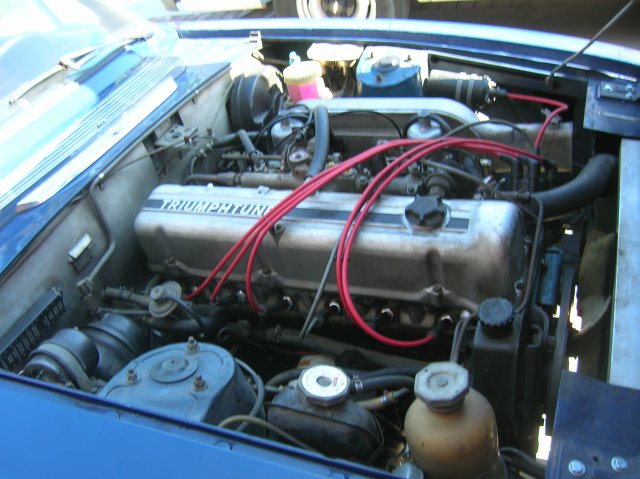

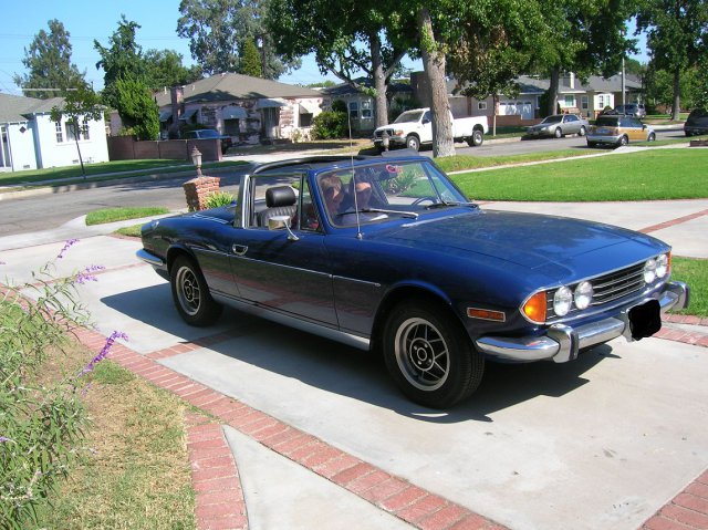

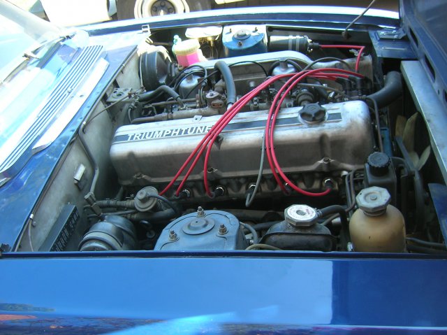

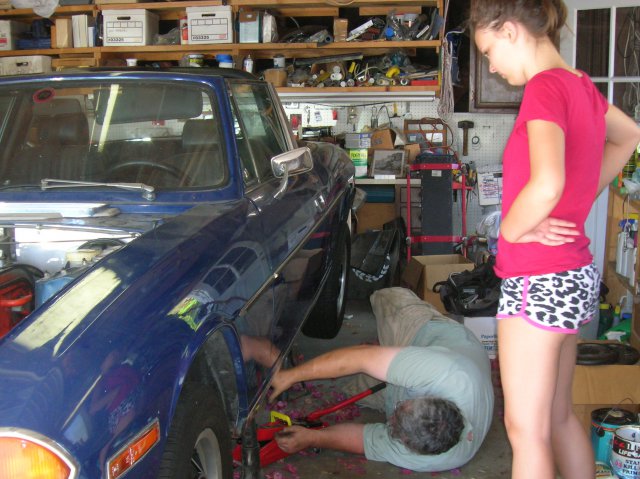

A few photos of my 1973 Triumph Stag, currently running a 2.6 with SUs and a ZX distro. Behind that a Maxima 4sp auto, down from that a 3.7:1 180 diffy, and Z half shafts, finally into Triumph hubs. Should have ditched the hubs for Datsun hardware. Currently lusting for a 280 Turbo..... Teenaged girls featured, no, you may not date them. And me getting it down off stands for the first time in nine years. The kid helped.
I'll go make a thread about my over all project in due time, but here are some photos of the project:
