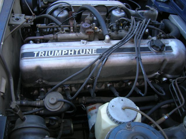

Funny. I had the cover off the other day, and noticed that the exact same piece was bent away from the cams slightly and was a little loose. The lobes looked ok to me. I wonder if my spray bar is about to fall to bits?
She's a big stinker, but she does photograph well. Unlike her daddy. I won't be chroming. I'll replace it with a header first.
