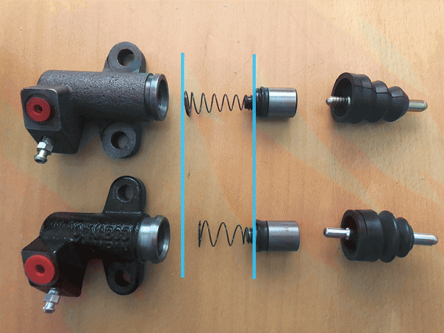

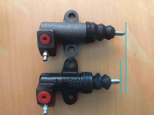

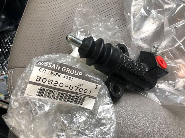

I have struggled with the Clutch Slave Cylinder. https://youtu.be/C-_NZFeVp1I It always almost fully extended. I replace the Clutch Slave Cylinder with cheap CENTRIC 139.42002 from Rockauto.com. It costs $6.32..... I replace Clutch Master Cylinder to 15/17 version from 280ZX too. Today, I purchased Genuine Clutch Slave Cylinder from Nissan Parts center. It still available to purchase. It costs $75.... I compare the size with aftermarket Clutch Slave Cylinder. The aftermarket cylinder has stronger and longer spring inside. The rod length is almost same. due to the spring, the default length is longer than OEM version. This could be the reason, the slave cylinder is pushing too much on the fork.- 230 replies

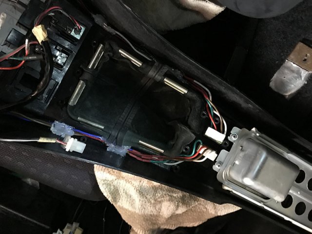

Electric Mod is done. Install Moded Autometer Tachometer with shift change light Install Alpine stereo with power amp Install Power lock Install Power Window Install Viper Alarm with auto window roll up Remove shunt add relays add fusebox for constant add fusebox for IGN add relay and fuse for the starter add relay and fuse for head lights Remove transistor Swap ammeter to voltmeter Swap to 280zx dizzy Swap to GM CS-144 alternator Swap interior light bulb to blue LED- 230 replies

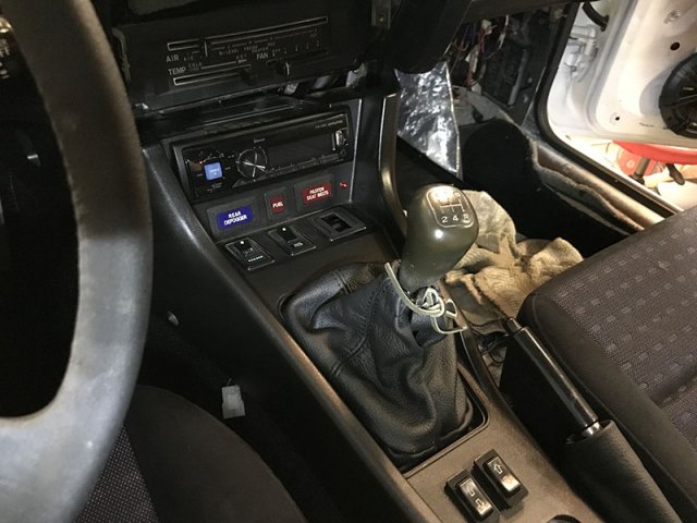

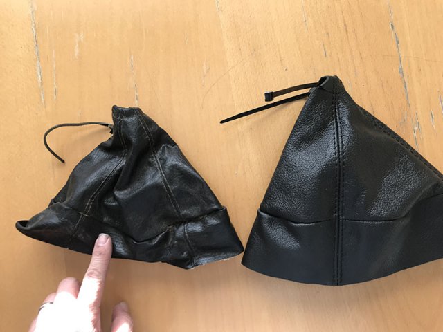

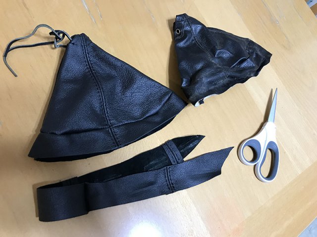

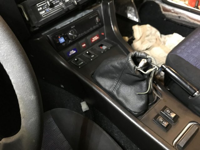

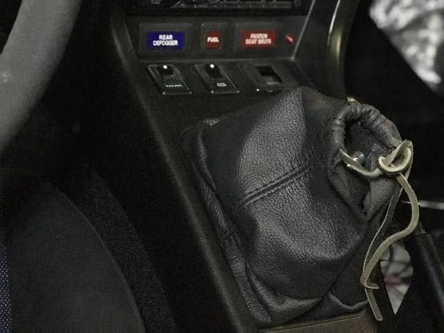

It gets softer. I wiped out Vaseline and put it on to the center console. The clips are so hard to put them on. Especially, leather is thicker than fake leather. But, the leather boots cover is too long, Shift nob will be hidden... I removed it and compare with the original one. It is way too long. I cut it sort. Now it looks better.- 230 replies
