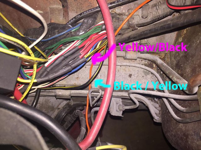

tamo3 replied to tamo3's topic in S30 Series - 240z, 260z, 280z
After battling wiring mess with power windows, power lock, Viper Security system, Alpine head set, finally, I figured out. I made mistake for custom starter relay wiring. I connect custom relay to Yellow/Black line to starter. That's causes breaking relay and frequently run starter even though after starting engine. I had to connect Black/Yellow instead!- 230 replies

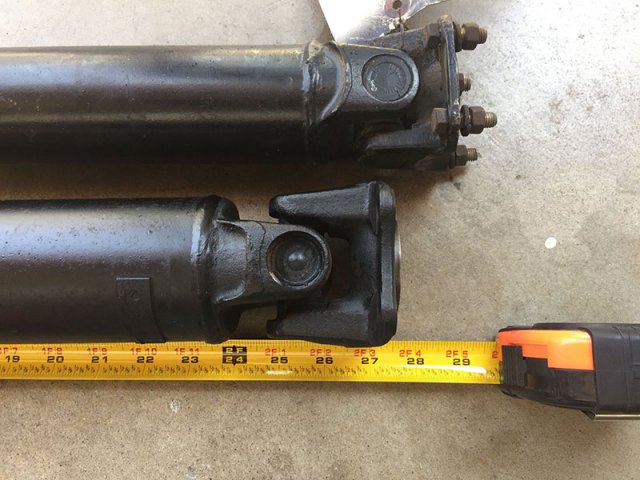

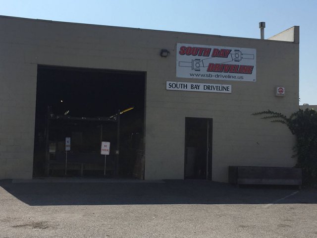

My plan was to use Series 1 240Z drive shaft which is shorter and should fit 71c conversion. However, I found out the pinion flange is different from R180 and R200. Thus, I need to shorten driveshaft. I brought 280Z drive shaft to SouthBay Driveline and they get it shorted $150 in a day!- 230 replies
