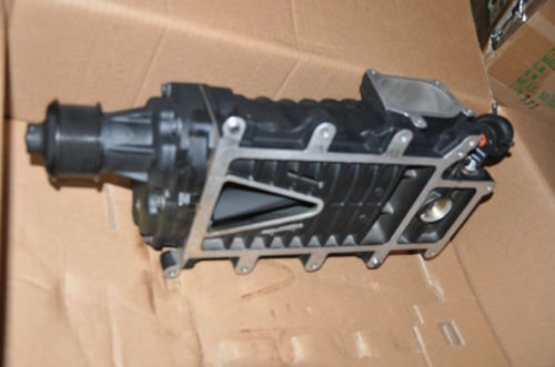

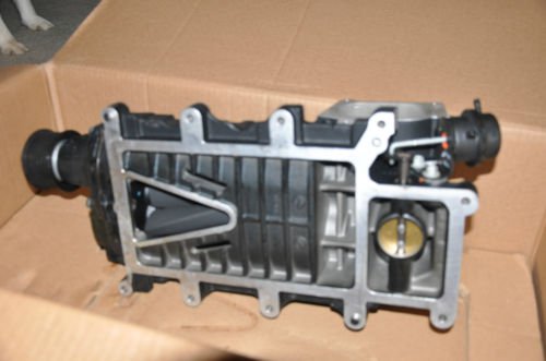

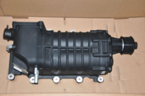

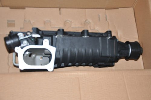

I just picked up a M122 GT500 supercharger (see pictures)$250 w/ only 1000miles and Harmonic dampener for $40 shipped. I also got a ECM to run either the 4.6L w/ the GT42 Turbocharger or the Supercharger and I plan on making a custom manifold to run an Air to Air intercooler. -

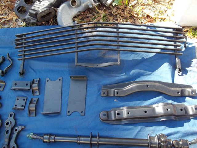

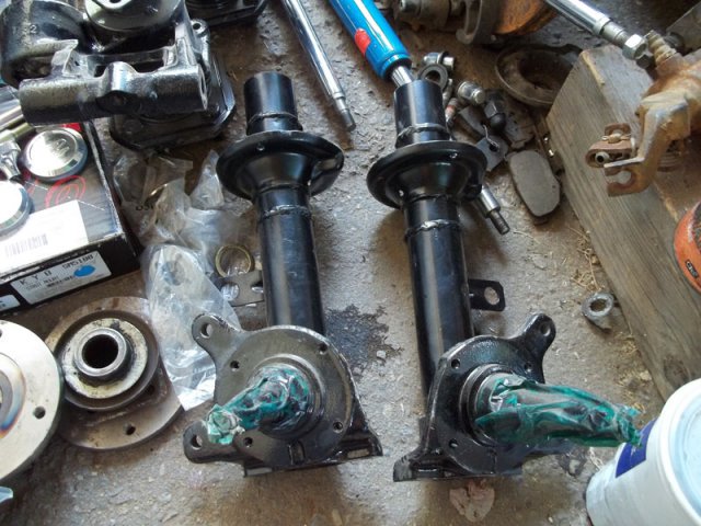

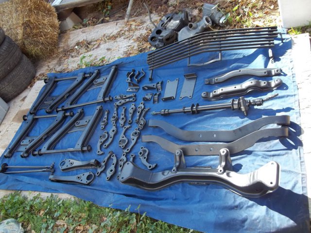

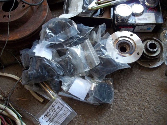

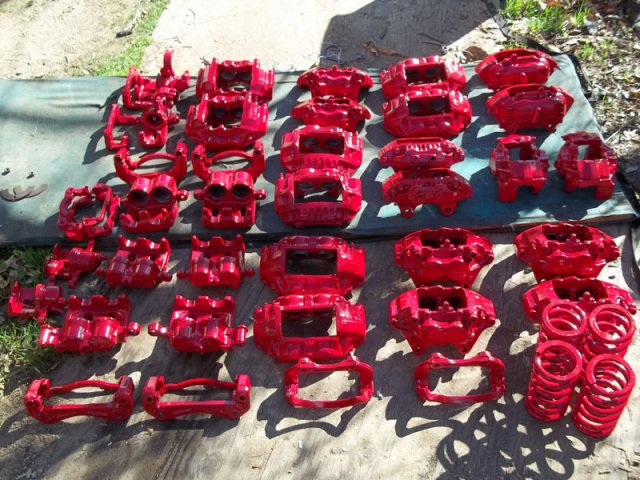

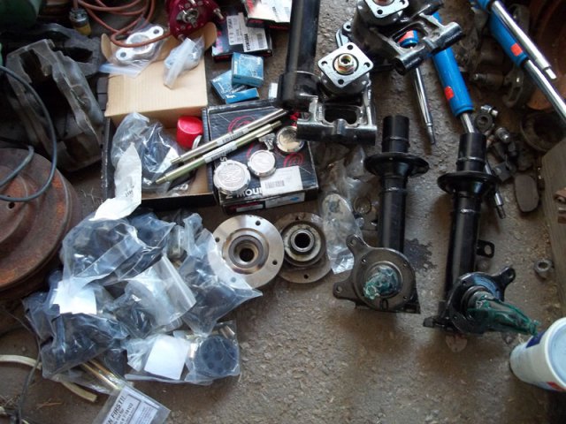

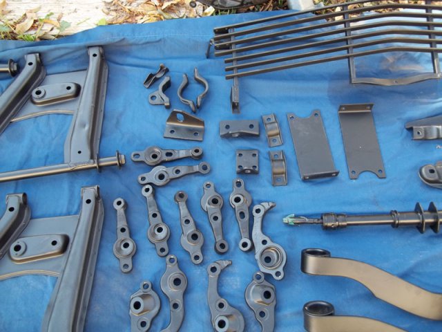

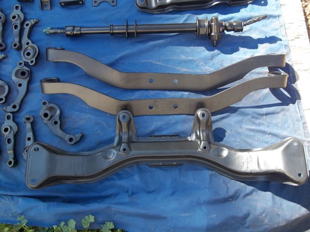

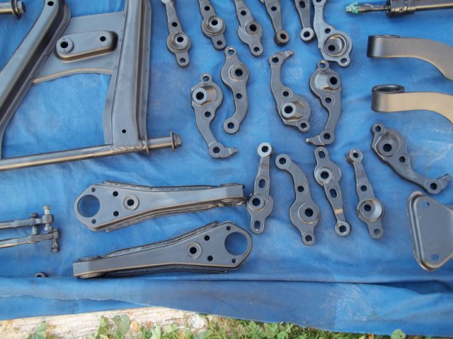

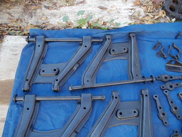

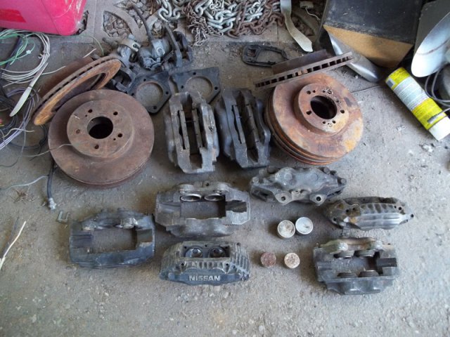

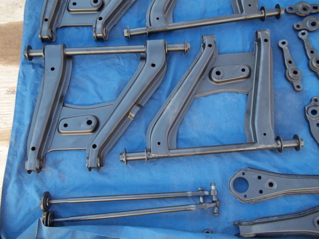

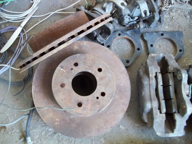

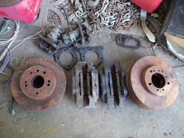

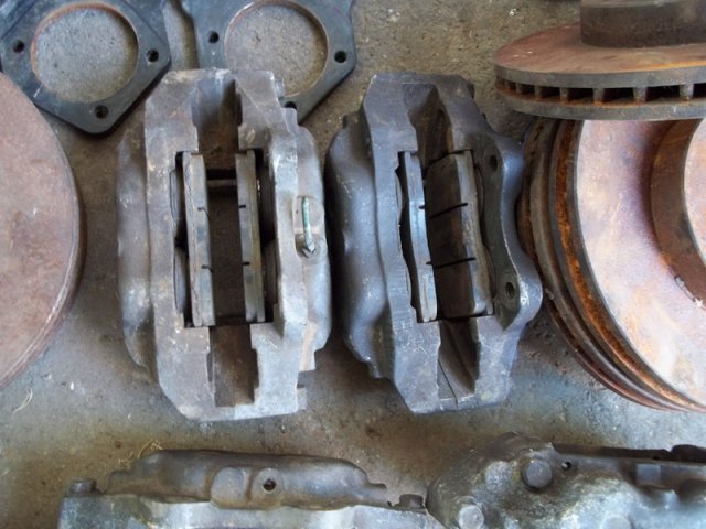

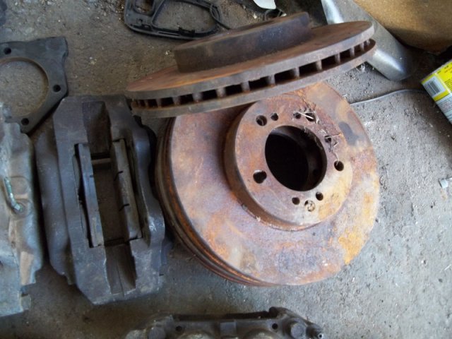

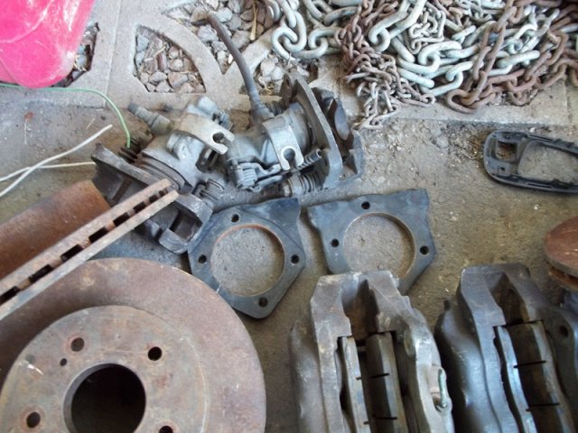

Here are some pictures of the latest progress... I got my powder coating done. In the picture of brake parts are some big brake candidates. -

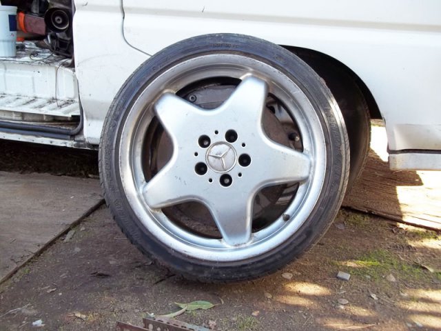

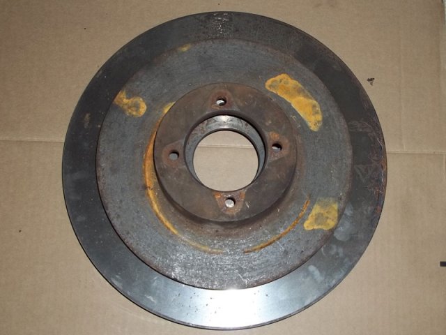

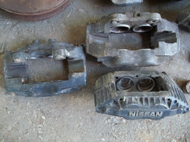

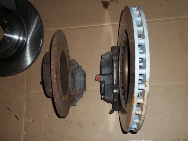

Hear are some pictures of the brakes. I found a company in Los Angeles that will drill the blanks for our wheel lugs. -

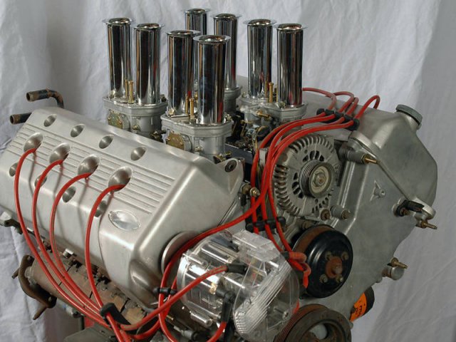

I wanted something exotic...Like the 60's Ford OHC 600hp big block that I read about when I was a teen. And I wish I could do headers also...Maybe in the future. -

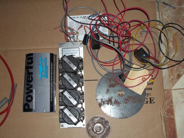

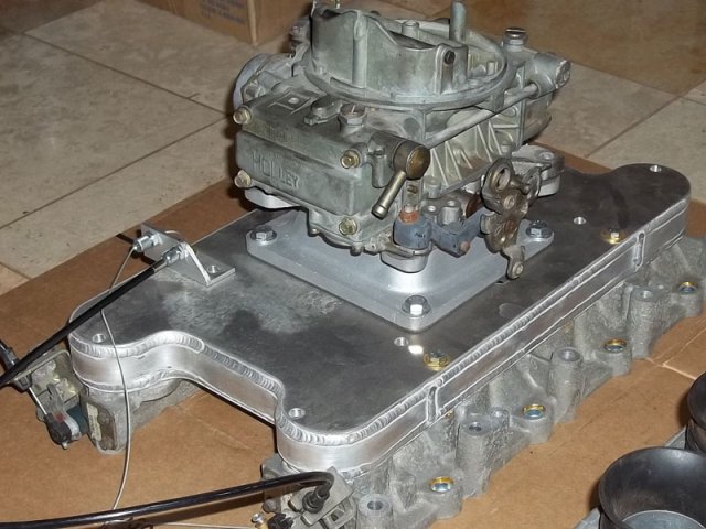

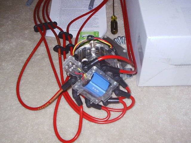

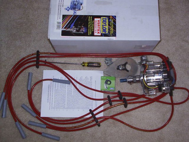

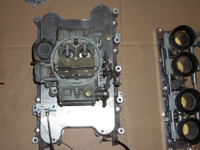

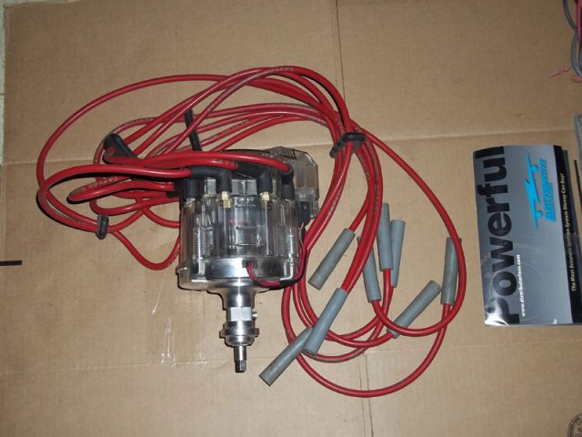

The distributor is H.E.I. (Hi Energy Ignition) brakerless. Which I have the whole setup so I could fire up the engine while I'm figuring out the electronic ECM. Here are some links of setups that are way easier. The guy that sold me the stand alone and distributor setup went to. Ford 4.6 5.4 SOHC DOHC MSD 6-Mod Controller Carbureted EFI 6011 Mark 8 Mustang http://www.ebay.com/itm/Ford-4-6-5-4-SOHC-DOHC-MSD-6-Mod-Controller-Carbureted-EFI-6011-Mark-8-Mustang-/300607863399?pt=Motors_Car_Truck_Parts_Accessories&vxp=mtr&hash=item45fd9ffa67 MSD Ignition 6011 Ford Modular Ignition Controller for 4.6L/5.4L http://www.ebay.com/itm/MSD-Ignition-6011-Ford-Modular-Ignition-Controller-4-6L-5-4L-/150692206308?pt=Motors_Car_Truck_Parts_Accessories&vxp=mtr&hash=item2315f496e4 -

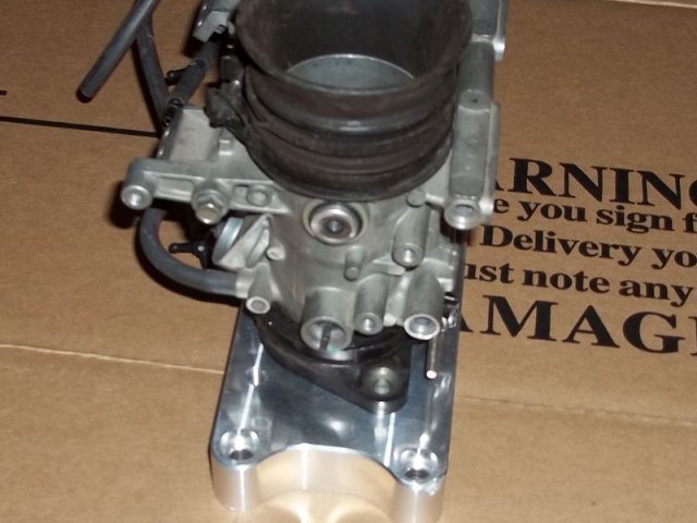

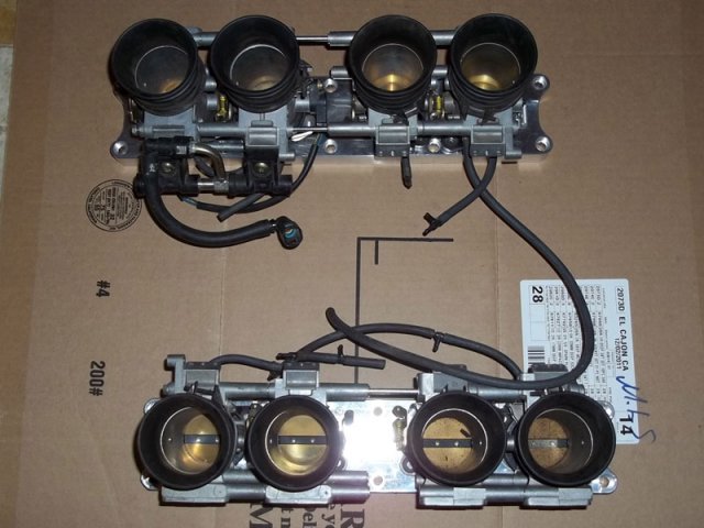

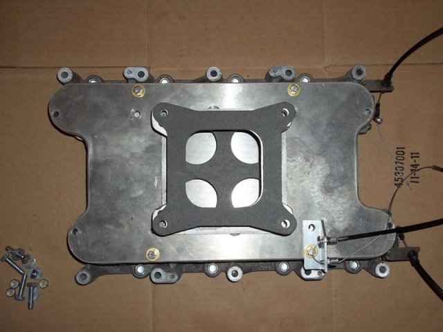

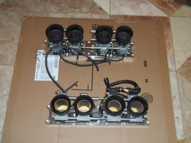

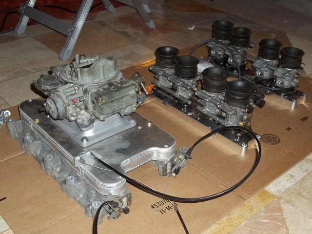

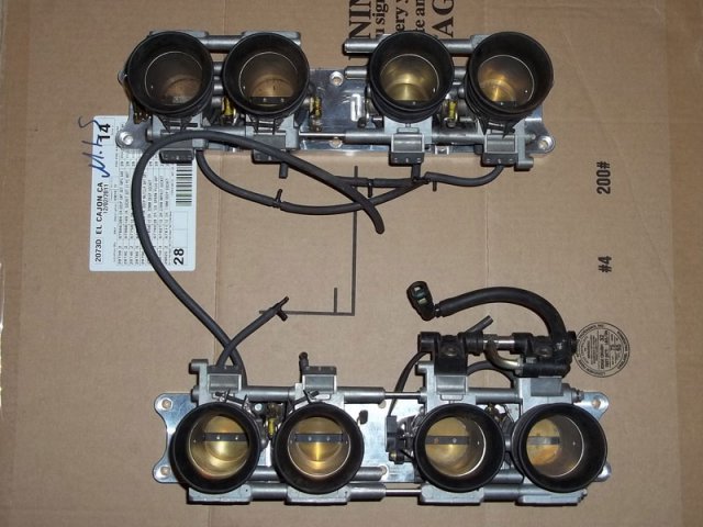

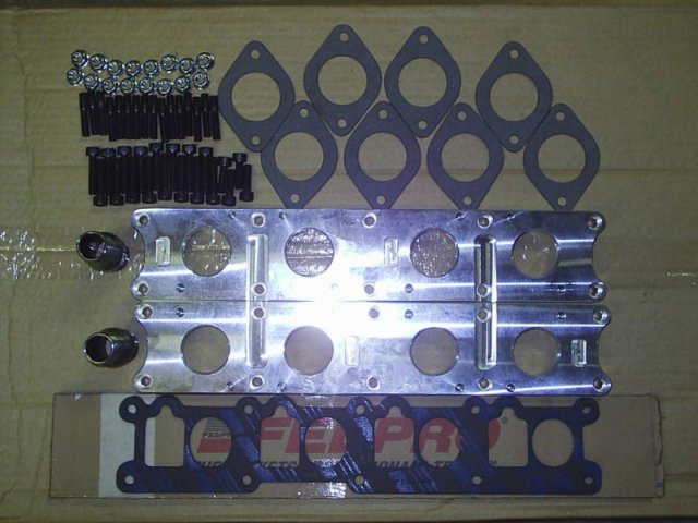

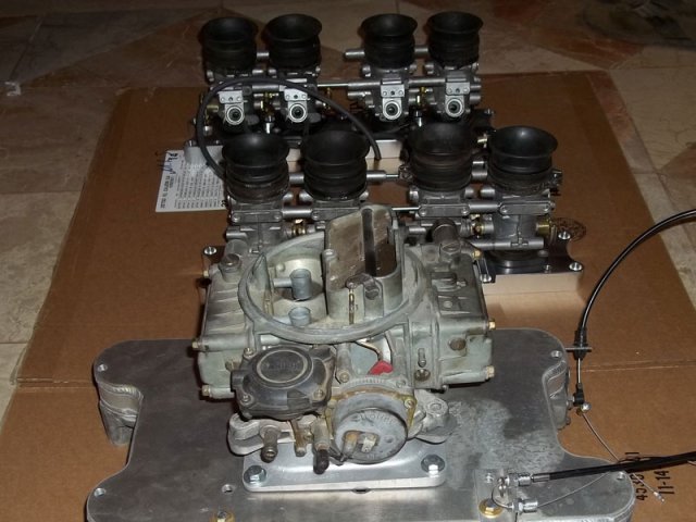

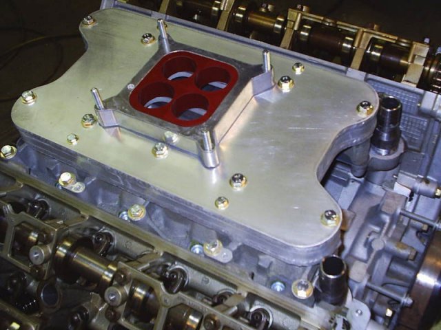

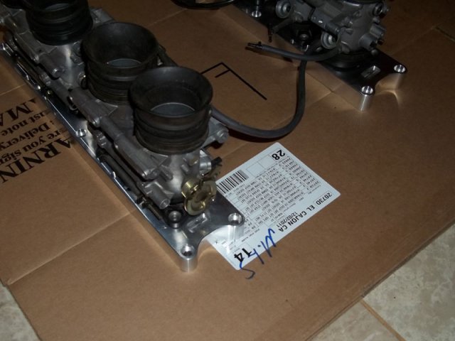

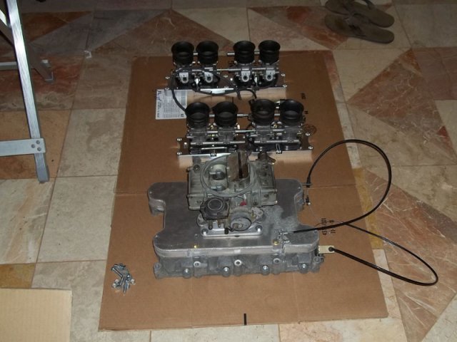

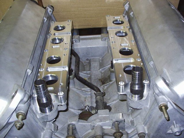

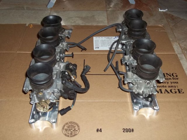

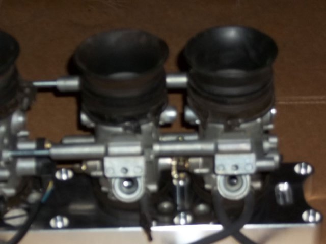

I just picked up a couple of options for ITB's, 4 ddl., distibutor, and stand alone ign. Here are some pictures -

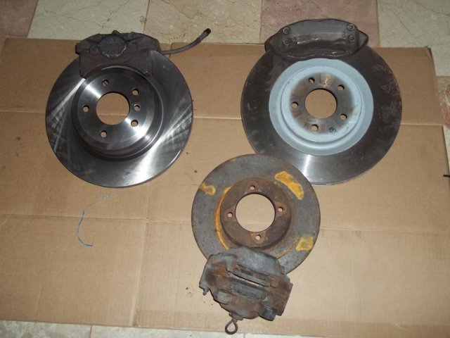

attached is a picture of my front brakes and I am waiting for a custom rear rotor and adapter. Here are the specs: Brembo 4 piston fronts and 2 piston rears 355mm (13.98") Diameter 32mm (1.26") thick Fronts 336mm (13.23") Diameter 22mm (0.87") thick Rears PS the rim is an 18" and sent in all my suspension for powder coating (I'll post pictures soon). -

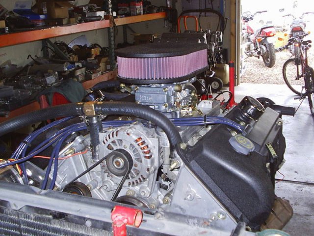

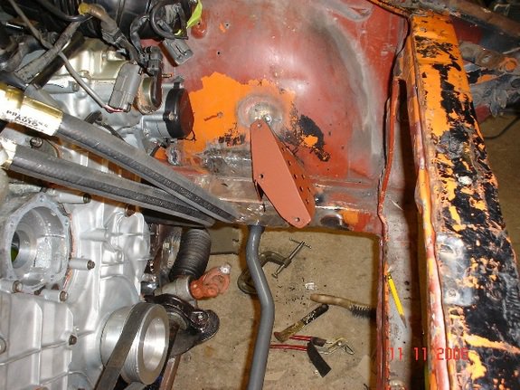

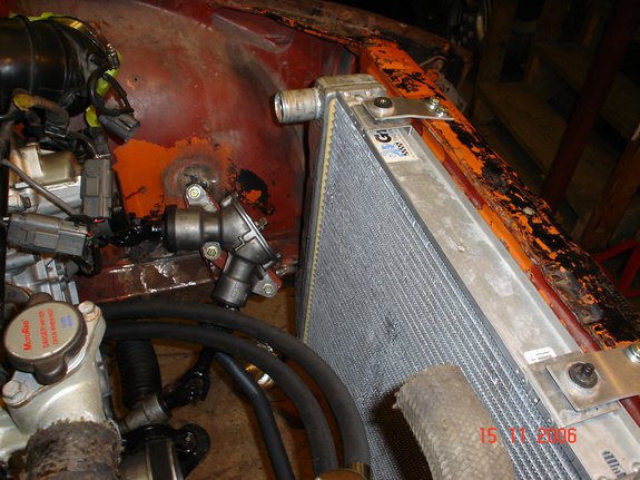

Yes it looks cramped BUT remarkably everything has been designed to be accessible...ie waterneck to block I had to cut out ~2" out so that I would clear the frame, I used F150 solid rubber mounts (that had mount recievers bolted to the frame in place of the liquid filled round mounts. I used the battery tray area to tap into the passenger side vent for a fresh air solution...I also used a Expedition oil filter relocation setup (which I will tap into for an oil cooler. I am currently going down a rabbit hole and installing ABS and 98 Lincoln MK8 Air Conditioning with digital control. Lots of fun. Thanks for the reply PS I tried installing a 5.4L with twin turbos but the long block alone wouldn't clear the hood. -

Are you still interested? I have a couple of pairs of modified strut/spindle, steering arms and hubs for 4 lug...you'll need to source the 240sx z32 rotors on FleeBay. The cost without sectioning is $350 and if you want I can lower the spring perches. I can section them for an extra $100. They are a direct bolt on and look great. Are you going with coilovers? are you sectioning and 4 lug? I have a solution. PM me.

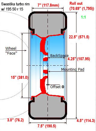

I tried my hand at welding the motor and trans mounts...Horrible so I will be paying for a local mobile welder to come out and weld everything up at once. I am waiting on funds to finish the suspension ( powder coating ) and am currently putting in the Lincoln MK VIII heating and A/C system and the 300zx z32 ABS system...If I use the 15" Swastikas...I will have to use Q45 (in place of the z32 calipers) calipers for now. The rears are late Z31 turbo rear ventilated setup. -

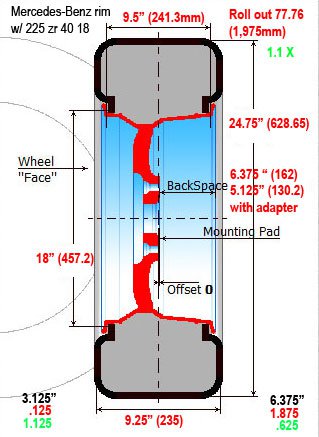

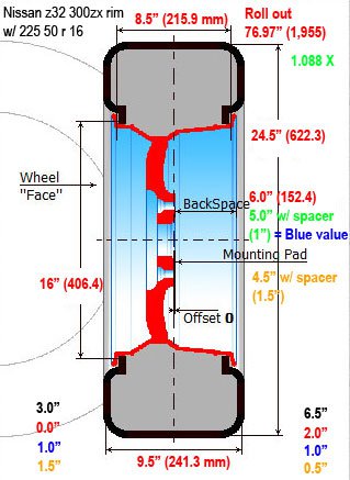

I have been playing around with some online calculators and I have three types of rims/tires and three VLSD's. Stock 4.6L Ford DOHC motor in my 240z: 11.78 sec. 1/4 mile Top Speed 156 mph @ 290 hp (old 151 hp 2400 lbs. @ 125 mph) 1/4 mile based power to wt.: http://robrobinette.com/et.htm 11.78 sec. 1/4 mile (2400 lbs. and 290 hp) 10.58 sec. 1/4 mile (2400 lbs. and 400 hp) 09.00 sec. 1/4 mile (2400 lbs. and 650 hp) Needed HP for Top Speed: http://robrobinette.com/top_speed.htm 156 mph @ 290 hp 180 mph @ 400 hp 203 mph @ 650 hp top speed based on gears: (if you have the hp) http://www.catherine.../sti/tyres.html Gear RatiosTR-3650 used in the 2001-2004 Ford Mustang GT 1st: 3.380:1 2nd: 2.000:1 3rd: 1.320:1 4th: 1.000:1 5th: 0.670:1 VLSD's 190 mph 4.09:1 191 mph 3.90:1 201 mph 3.70:1 The diagrams of wheels below have figures at the bottom to compare to a set of Swastika's -
I have been playing around with some online calculators and I have three types of rims/tires and three VLSD's. Stock motor in my 240z: 11.78 sec. 1/4 mile Top Speed 156 mph @ 290 hp (old 151 hp 2400 lbs. @ 125 mph) 1/4 mile based power to wt.: http://robrobinette.com/et.htm 11.78 sec. 1/4 mile (2400 lbs. and 290 hp) 10.58 sec. 1/4 mile (2400 lbs. and 400 hp) 09.00 sec. 1/4 mile (2400 lbs. and 650 hp) Needed HP for Top Speed: http://robrobinette.com/top_speed.htm 156 mph @ 290 hp 180 mph @ 400 hp 203 mph @ 650 hp top speed based on gears: (if you have the hp) http://www.catherineandken.co.uk/sti/tyres.html Gear RatiosTR-3650 used in the 2001-2004 Ford Mustang GT 1st: 3.380:1 2nd: 2.000:1 3rd: 1.320:1 4th: 1.000:1 5th: 0.670:1 (used on 01-04 with 3.27:1 final drive) 190 mph 4.09:1 191 mph 3.90:1 201 mph 3.70:1

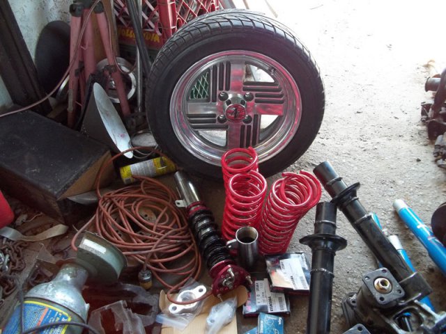

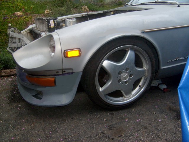

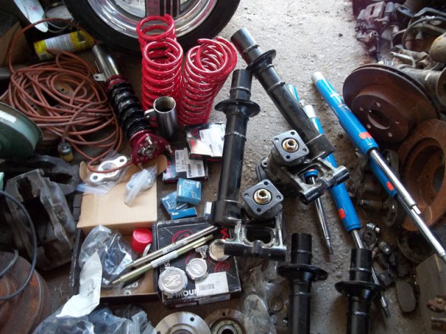

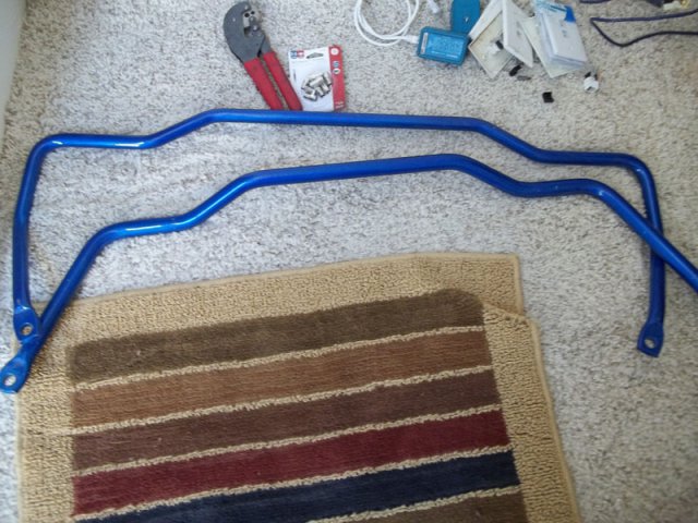

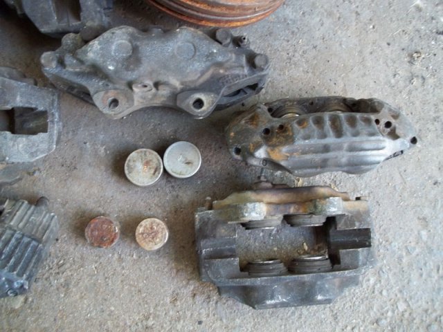

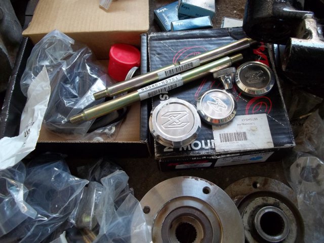

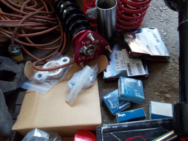

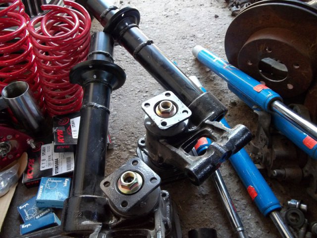

Thanks for the offer but I have a couple more...Also I don't know if I should post the brakes, suspension and more. Well here are some pictures...The brakes are my old setup that I never got to test I have moved to the Z32's on the fronts and vented rears.
