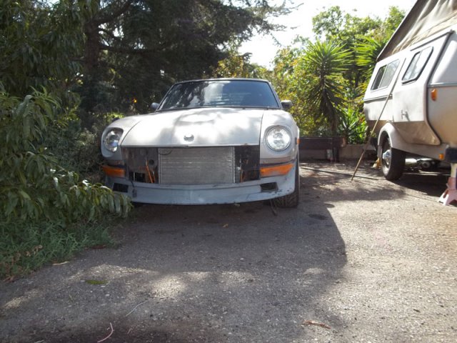

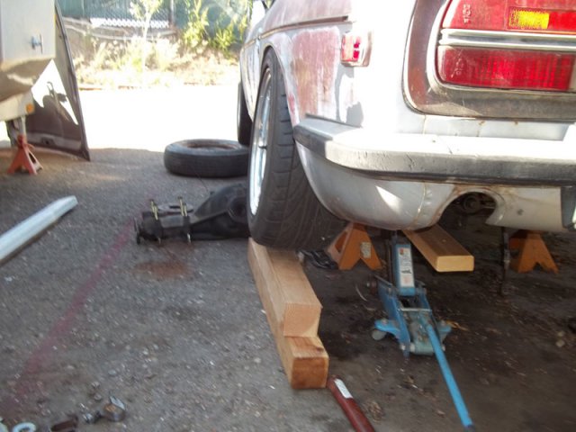

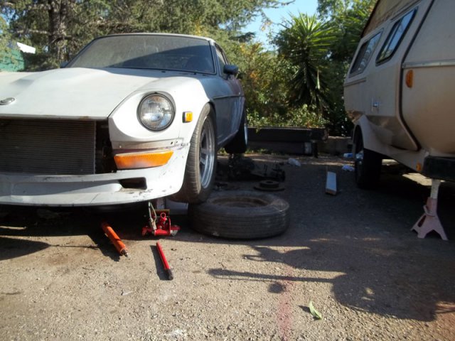

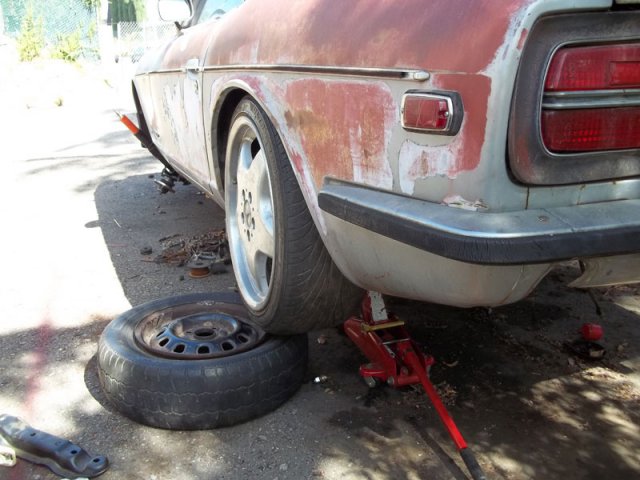

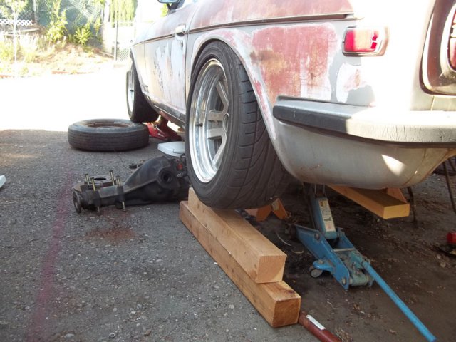

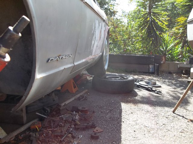

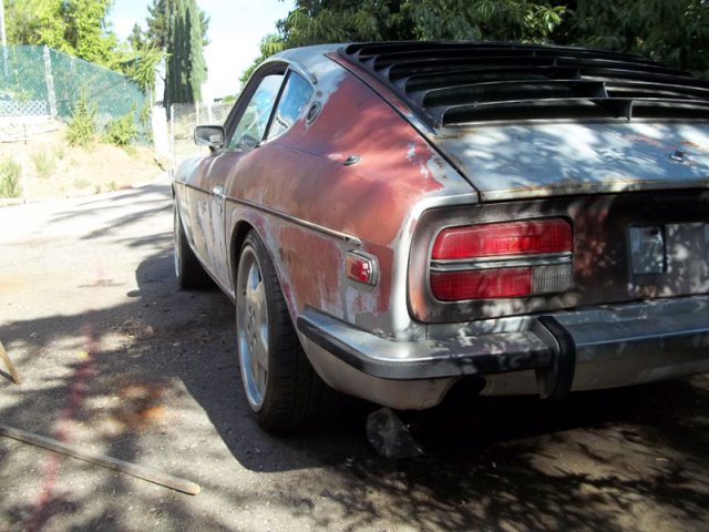

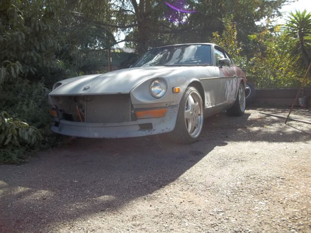

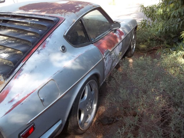

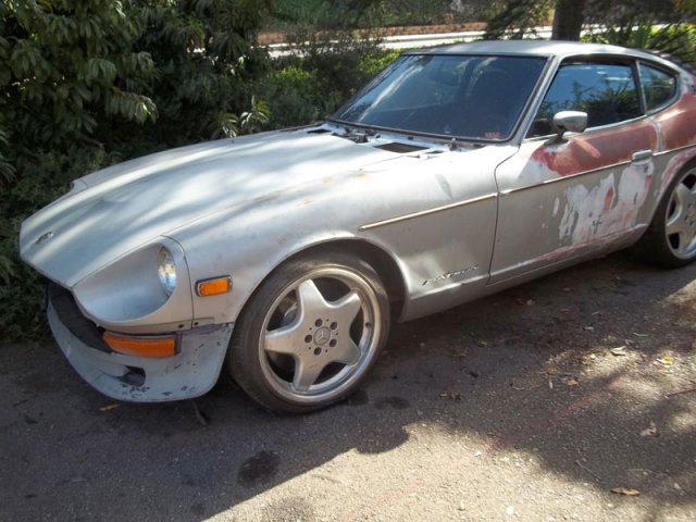

  15. Here are the latest pictures of the height of the car and keeping the tires inside the wheel wells.

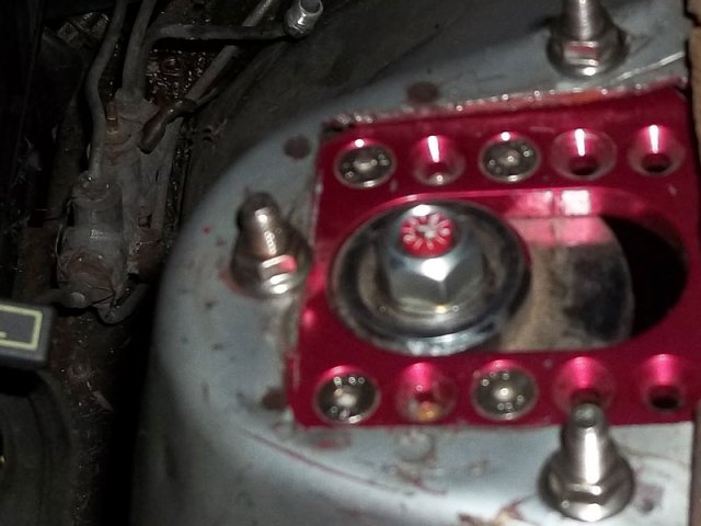

  16. Yeah...I am taking it one step at a time. I have a friend that is a great welder and he is going to do the mounts, some reinforcement, and mods. I will be going with a fuel cell after all and with the spare tire cut out I will have room for the dual mufflers. Also I am still having problems fitting the 8 1/2" X 18" rims and the coilover kit. I have 350's (7") up front and 440's (7) in the rears. So I am thinking of going to a 4" spring the same rating or some 8" 225's up front with 10" 200's rear.

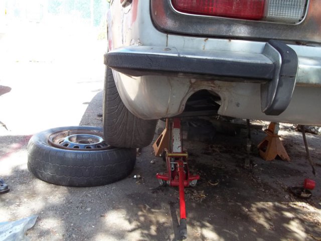

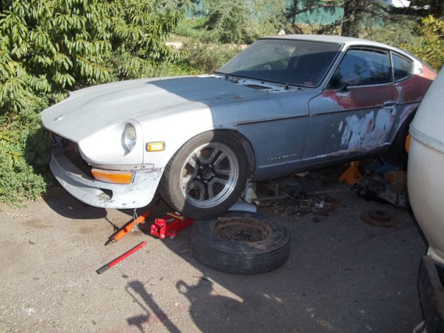

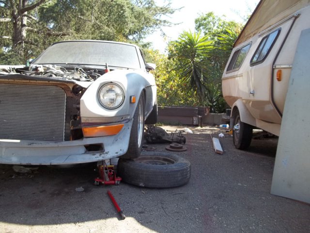

  17. One more step towards getting the mounts and exhaust welded...These pictures are without complete suspension adjustment and the Differential. I measured, measured and measured and still need to make adjustments. I can't wait.

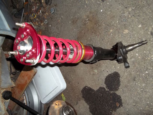

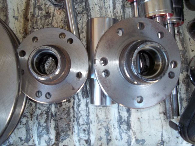

  19. I got some more of my machined parts and will have the car on the ground this weekend...The caliper brackets will be done in (3) weeks (Machinist needs a two week brake). Here are some pictures.

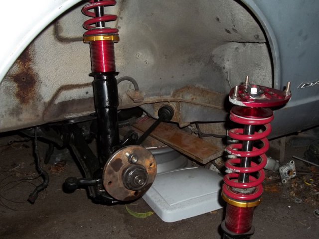

  20. well after a day of assembly and machine work I got the front strut assy's done and tomorrow I will be doing the rears and the brakes. Yahoooooo

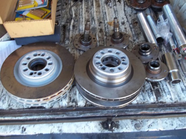

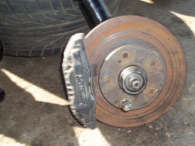

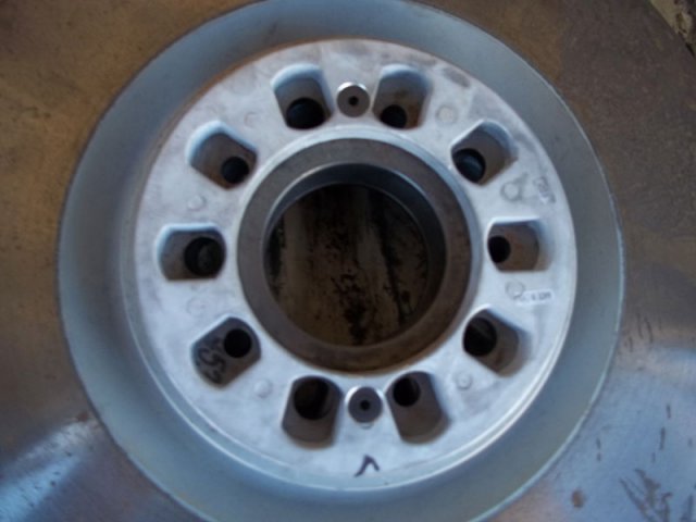

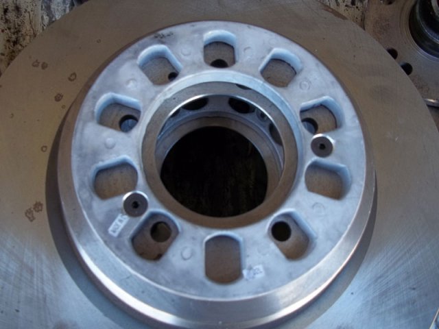

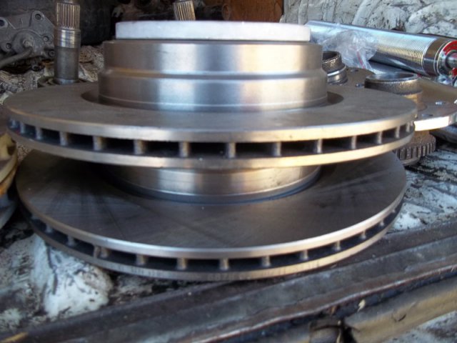

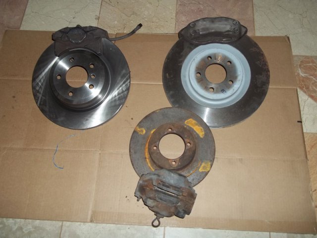

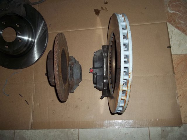

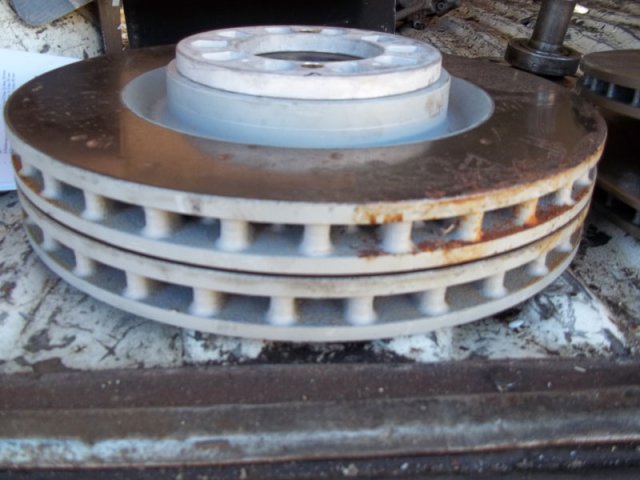

  21. I also had problems with the brakes fitting but is now perfect..Here are some examples:

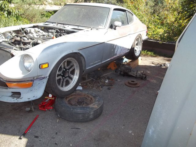

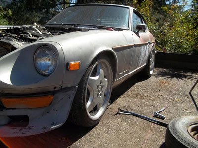

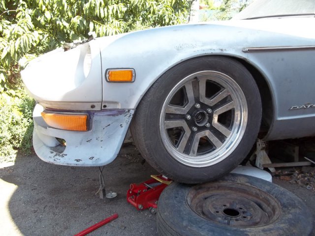

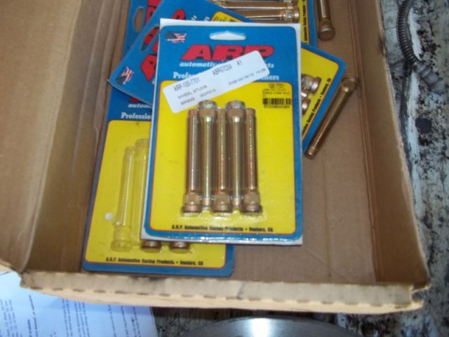

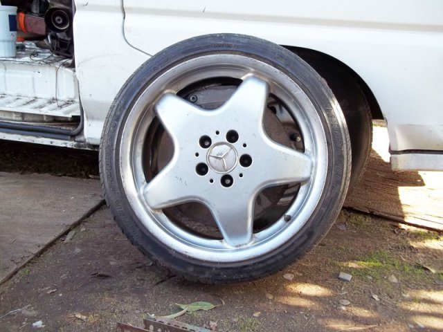

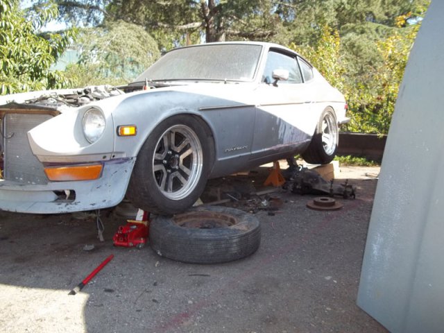

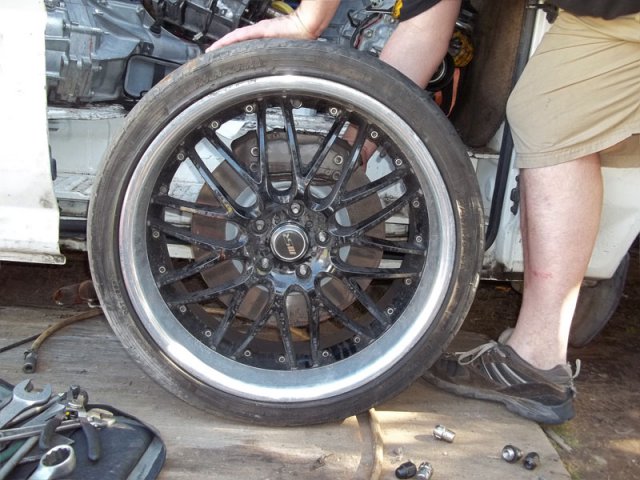

  22. Well I have changed my mind on the Starion wheels and Z32 brakes for now (because I would have to flare the fenders and more) So I went back to the big 14" Brembo brakes and the Mercedes Benz 18"X8.5" rims with small 225's on them now. I have coilovers and camber plates also put a half inch spacer on all 4's and went long ARP studs and had everything redrilled for the 112mm X 5 lug pattern. I checked the ground clearance which for now will be 5.5" (stock is 6.3") and when I need tires I will be putting 255/40R18's on them. The machine shop has been pushing the work for the last 3 weeks but claims that everything will be done next week...YEAH Also I am either going to polish these or powder coat...Have'nt decided yet. Below are pictures of both Starion setup and the Mercedes setup.

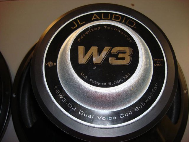

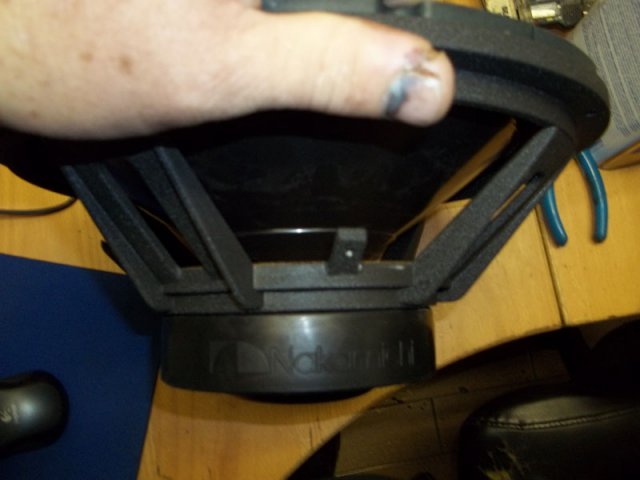

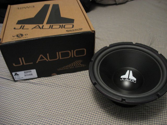

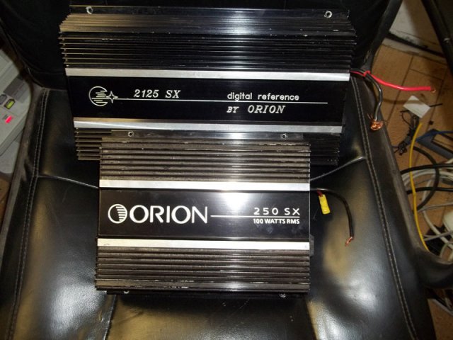

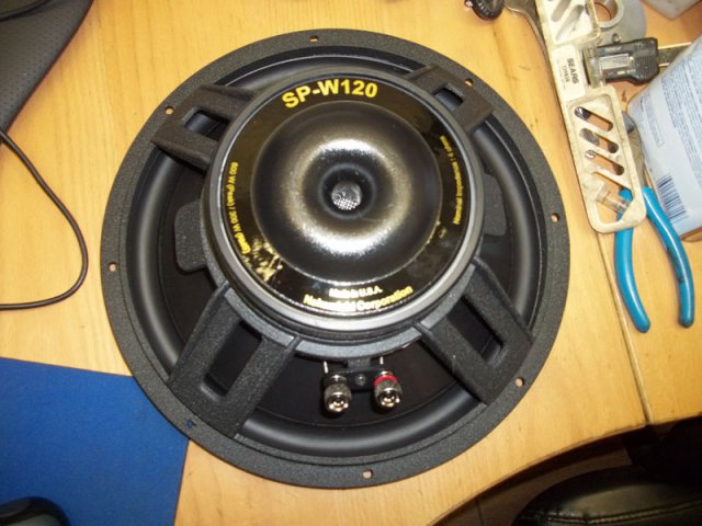

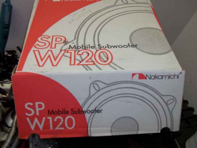

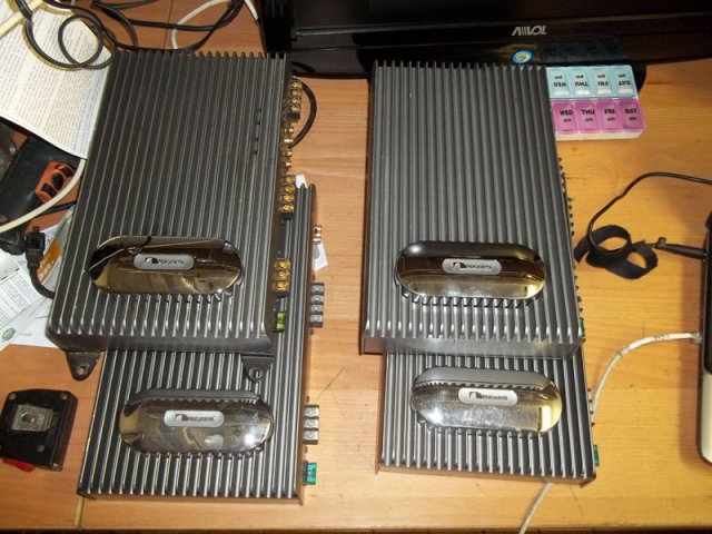

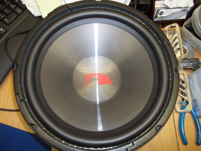

  23. PS I got most of my stereo stuff also see pictures...I will most likely use the Nakamichi stuff
