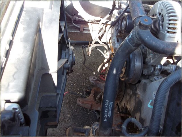

I played with the engine and transmission attached...I cut out the transmount in the tunnel, relocated the control box for the IRC's, cut of the stock Z motor mount perches. I have the oil pan and the bottom of the bellhousing is about the same height...which is lower than the crossmember (makes me nervous) I am also thinking of switching the 98' LSC Mark VIII intake for the 98' lincoln continental intake which is similar to the earlier Mark VIII with the throttle body in the rear (better to route the intake) or I will modify the battery area and the cabin pressure ducting with a kinda cold air intake??? fuel/ignition control will be an original ECM and harness but after I dial everything in...I will have it repogrammed (tuned). -

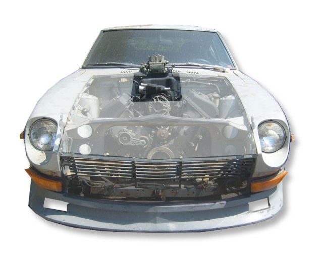

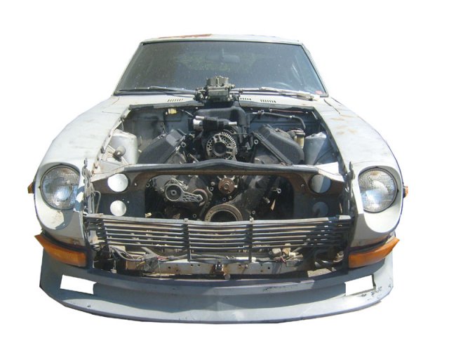

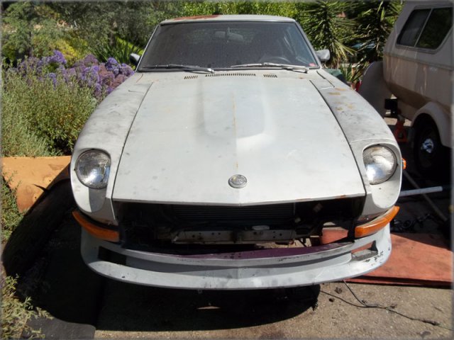

Hi I know this is an old tread and I have been working on my 4.2L (on the stand) with the help of: http://www.supramania.com/forums/showthread.php?100227-Limequat-s-4.2l-I6-Swap a guy that did the swap on a Supra. Lots of good information. PS I am Z crazy and I also have a L28T with a Jim Wolf setup and a Turbonetics turbo, a Titan 5.6L DOHC V-8 (23K miles),4.6 DOHC with GT42, 5.4L DOHC (TBA), 99 LS1, and a Mecedes Benz 3.6L Berabus stroker inline 6 (It also has clearance problems...Modified oil pan and ITB's (which I have already). Way too many but it gives me a lot of things to do. Here are some pictures of the 5.4L just sitting in the engine bay for a look at clearances (the way it sits now in the pictures I have 6-8" from the back or the engine to the firewall. And I did some photoshop on the hood and the scoop.
