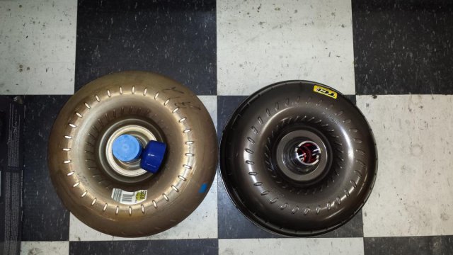

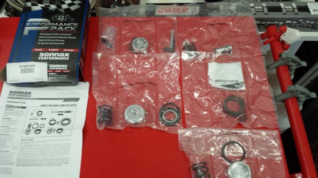

Mikey303LSZ replied to Mikey303LSZ's topic in Gen III & IV Chevy V8Z Tech Board

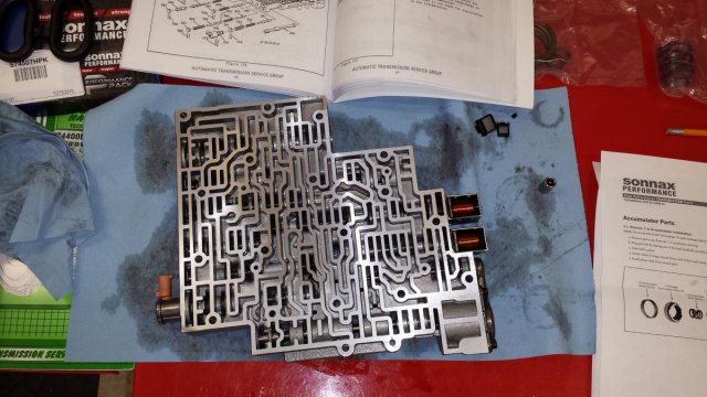

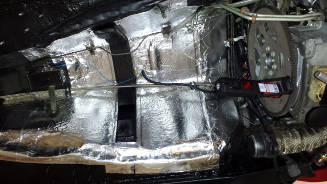

Dropped the trans. for a few Sonnax updates and a TCI converter. Added a heat shield barrier to the trans tunnel and exhaust area to help with the heat soak inside the cabin. The trans shifts much better... Quick and firm. Good uprade, well worth the effort. -

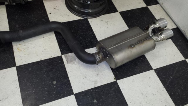

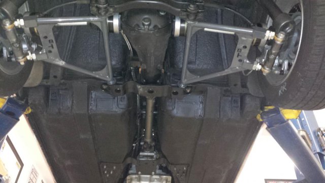

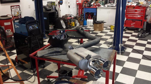

The drone of the Hush Power muffler drove me crazy during long drives so I burned in a Dynomax VT. The drone went away, now I have a slight slapping noise of a metal damper valve at idle. Swapped out the rear control arms to Techno Toys about the same time. -

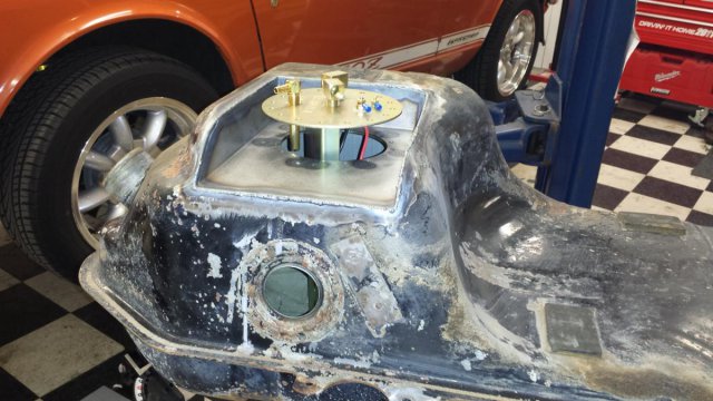

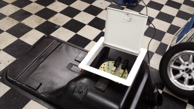

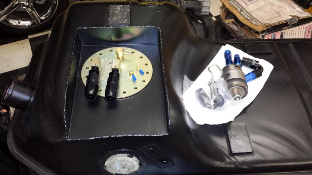

I tried copying the links into the reply with no luck. Go to Tanks Inc website. I purchased the PA Series pump module and PA-6 pump. I used the #VV roll-over vent valve and PA-REC fuel pump weld in recess. -

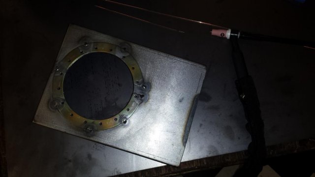

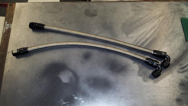

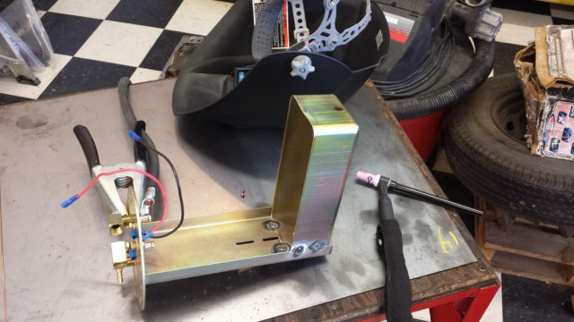

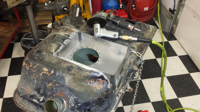

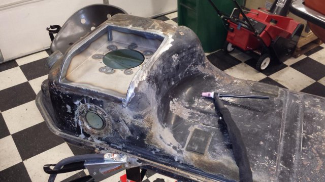

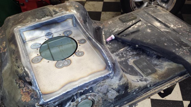

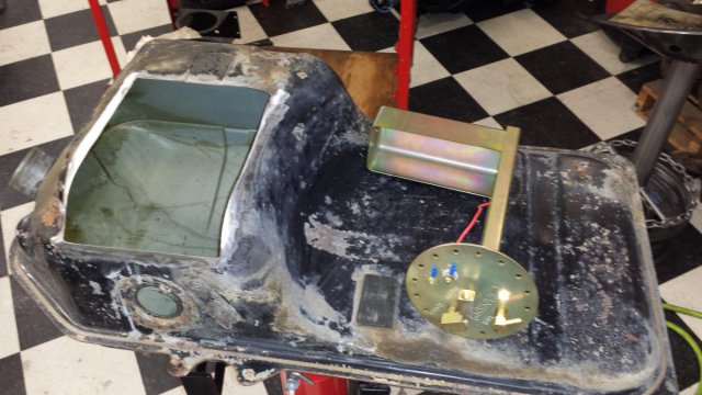

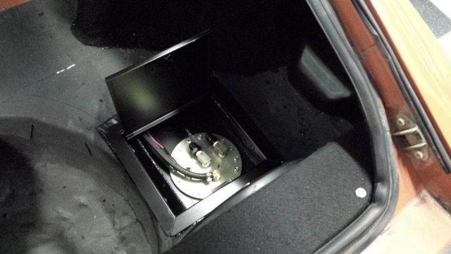

Wasn't too happy with the inline fuel pump I orginally installed so I picked up an OEM tank from Craigslist, cut the top out, bought a Tanks, Inc. kit and installed a 400lph in tank pump. I found a steel utility cover from Grainger, modified it and welded it into the body - if the pump fails I can remove it from the top w/o dropping the tank. I ran -8 to and from a C5 Corvette filter/regulator. Last month I took the car on 2016 PowerTour for a total of 3500+ miles door to door - No problems. It ran three 1/4mi. passes in BayTown, TX without fuel starve. I'm really happy with this setup - it's nice and quiet with no fuel starve issues during accelleration, braking or hard cornering. -

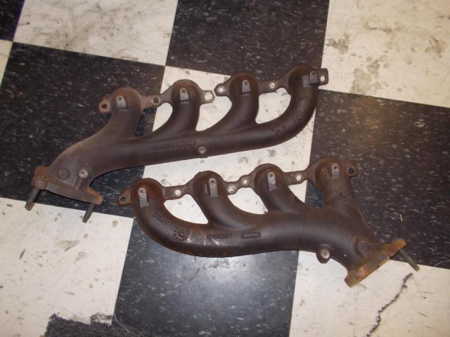

Mikey303LSZ replied to zspeed22's topic in Gen III & IV Chevy V8Z Tech Board
Nice - I was looking hard at those too. Decided to go with OEM truck manifolds to save $. Picked these up for $50 on Craigslist. Plan is to go down and forward on my turbo setup (240Z LS1). -
